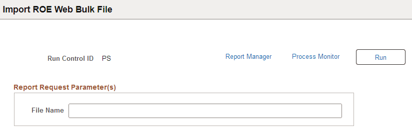

Import ROE Web Bulk File Page
RUNCTL_PAY107CN
(CAN) Import ROE serial numbers and amended serial numbers into the PeopleSoft system from the ROE Web bulk transfer file from Service Canada.

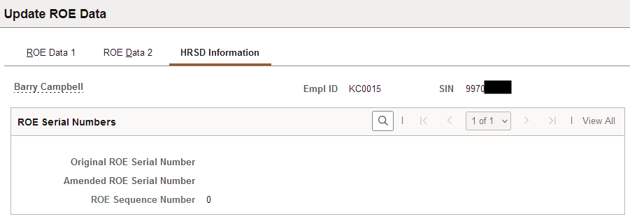

HRSD Information Page
ROE_DATA3
(CAN) View the ROE serial numbers from the Service Canada.

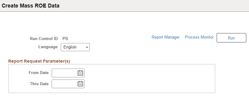

(CAN) Use the Create Mass ROE Data page (RUNCTL_FRMTHRU_PAY) to run PAY124CN, which creates ROE data automatically for a range of dates.
Navigation:
Payroll for North America > Periodic Payroll Events CAN > Record of Employment > Create Mass ROE Data > Create Mass ROE Data
This example illustrates the fields and controls on the Create Mass ROE Data page.
Enter the date range that defines the activity period from which the system selects employees qualifying for a ROE.

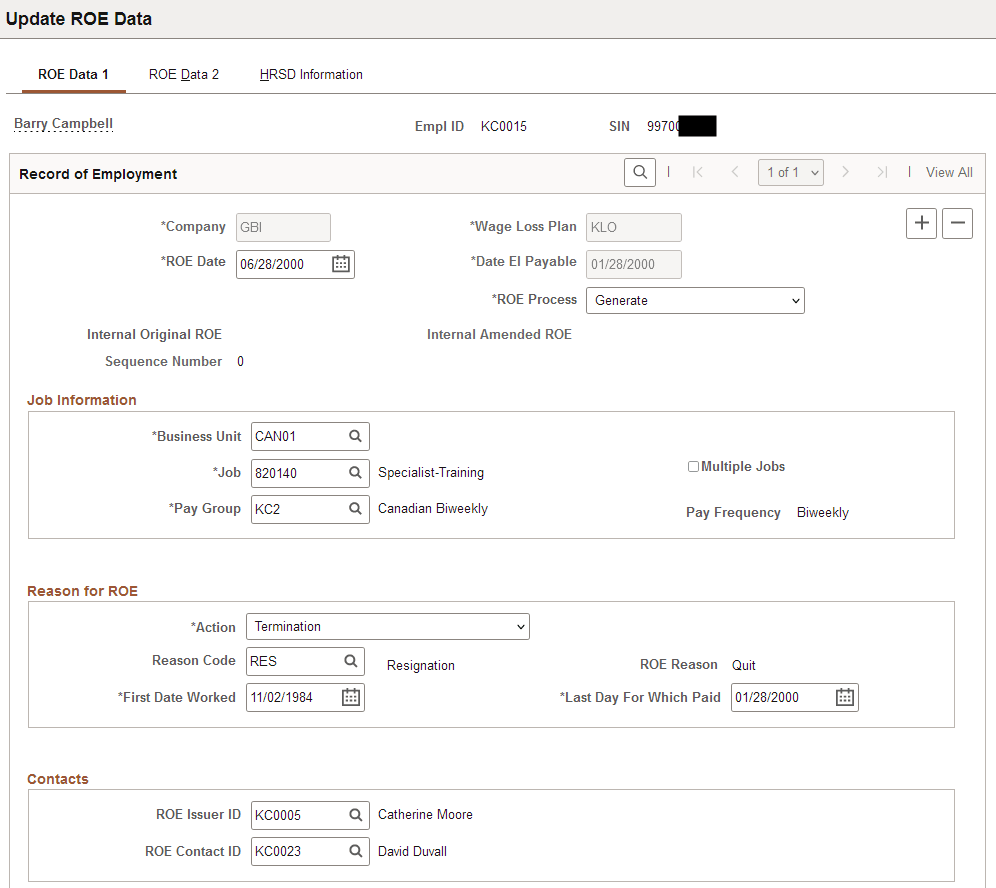

(CAN) Use the ROE Data 1 (Record of Employment data 1) page (ROE_DATA1) to manually create a ROE and enter employment-related details.
Navigation:
Payroll for North America > Periodic Payroll Events CAN > Record of Employment > Update ROE Data > ROE Data 1
This example illustrates the fields and controls on the ROE Data 1 page.
ROE Data 1 page
Field or Control
Description
Company
Enter the company as entered in the Job record.
Wage Loss Plan
Enter the wage loss plan as entered in the employee's Canadian Income Tax Data record.
ROE Date (Record of Employment date)
This date is for internal reference only. The default is the current date. During automated ROE creation, the default is the system date.
Date EI Payable (date Employment Insurance payable)
Enter the last date to which the EI premium is paid.
During manual ROE creation, the default comes from the Add − ROE Data dialog box. During automated ROE creation, the default is the end date of the last Insurable Earnings Balance record or the date in the Last Day For Which Paid field, whichever is earlier.
ROE Process
Identifies the process status of the ROE data records:
Complete: The final ROE has been created.
Delete: The ROE is ready to be deleted.
Generate: The ROE is ready to be included in the XML file creation
Hold: The ROE has been created but is not yet ready for submission to Service Canada.
Note: After ROE data records have been created and you have confirmed that all information is correct, you must update all acceptable records from Hold to Generate so that the ROE process can create the records in the ROE Web file format for submission to Service Canada.
XML File Created: The system assigns this status when the Create ROE Web Export File (PAY105CN) has been run in Final Data Export mode.
XML File Failed: The system assigns this status when the Import ROE Web Bulk File (PAY107CN) from Service Canada is run and failed ROE data records exist. Failed records have not followed the application rules provided in Appendix of the Service Canada web site. For example, an invalid Social Insurance Number would result in a failed record.
See Record of Employment on the Web (ROE Web) - Technical Specifications to develop an XML Interface on the Service Canada web site. As of the date of this publication, see Appendix D: ROE Payroll Extract File Transfer - XML File Layout and Edit Version 2.0.
XML File Rejected: The system assigns this status when the Import ROE Web Bulk File (PAY107CN) from Service Canada is run and rejected ROE data records exist. Rejected records contain an invalid CRA Business Number.
ROE Message
When the ROE Process field has a status of Complete, the ROE Process field disappears and the ROE Message field appears with a value of Complete.
Internal Original ROE
The system generates this number when it prints the final ROE and stamps it onto relevant Insurable Earnings Balance records.
Internal Amended ROE
The manual ROE creation process does not support amended ROEs. Leave this field empty if using the manual ROE creation process.
The system generates this number during the automated ROE creation process if the Final Data Export check box is selected on the Create ROE Web Export File run control page. The system also stamps the number onto the relevant Insurable Earnings Balance records. The system generates the Internal Original ROE number if the record is an amendment or replacement to an existing ROE.
Sequence Number (sequence number)
Leave this field empty because the manual ROE creation process does not support amended ROEs. During automated ROE creation, the system assigns a sequential number to identify different versions of an amended ROE.
Job Information
Field or Control
Description
Business Unit, Job, and Pay Group
Enter this information as entered in the Job record.
Multi-Job (multiple jobs)
Select this check box if the employee has multiple jobs.
Pay Freq (pay frequency)
The system populates this entry according to the pay group.
Reason for ROE
Field or Control
Description
Action and Reason Code
Note: You must make a selection for the Reason Code field. It populates block 16 on the ROE form.
First Date Worked
This date appears in block 10 of the ROE form.
This date appears in block 11 of the ROE form.

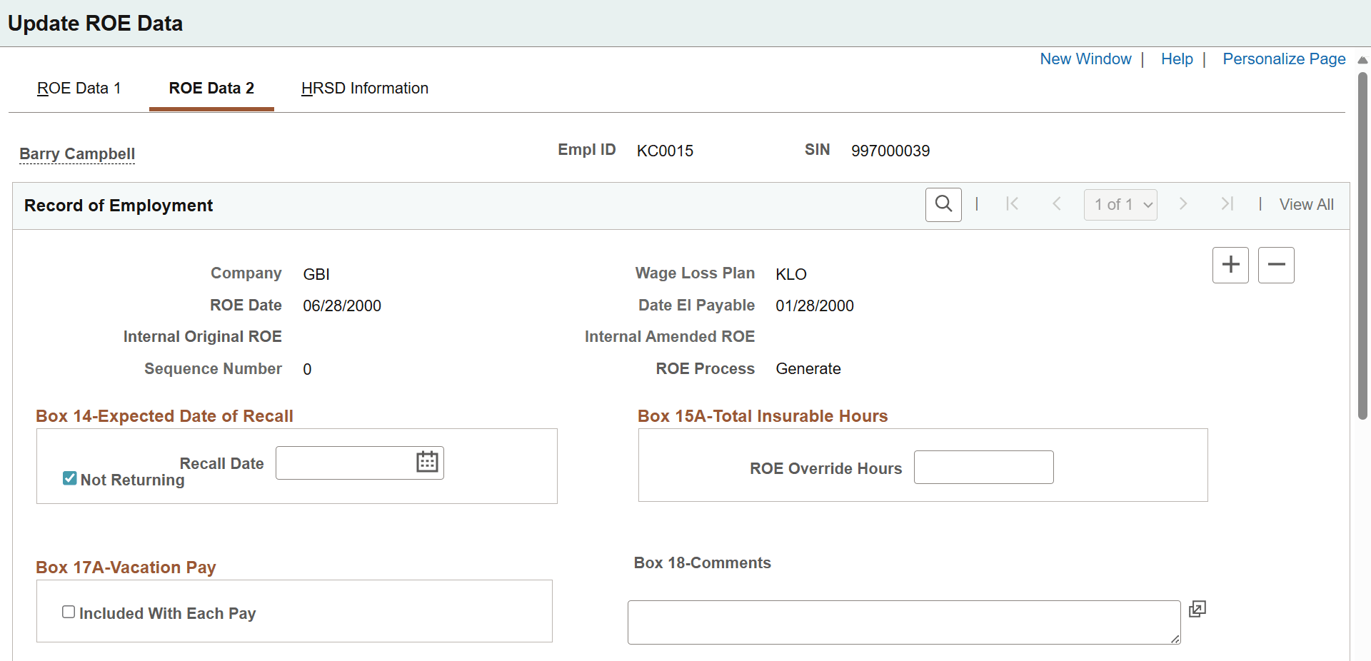

(CAN) Use the ROE Data 2 (Record of Employment data 2) page (ROE_DATA2) to enter more employment-related details, after you finish entering data on the ROE Data 1 page.
Navigation:
Payroll for North America > Periodic Payroll Events CAN > Record of Employment > Update ROE Data > ROE Data 2
This example illustrates the fields and controls on the ROE Data 2 page (1 of 2).
This example illustrates the fields and controls on the ROE Data 2 page (2 of 2).
Box 14-Expected Date of Recall
Field or Control
Description
Recall Date
Enter the expected return date as entered in the Employment Data record.
Not Returning
Select this check box if the employee is not returning to work (for example, the employee is retired or terminated).
If the Not Returning check box is deselected and the Recall Date field is empty, the system selects the Unknown check box in block 14 on the ROE form.
Box 15A-Total Insurable Hours
Field or Control
Description
ROE Override Hours (Record of Employment override hours)
Enter the ROE override hours if you must correct the ROE insurable hours.
Box 17A-Vacation Pay
Select the Included With Each Pay check box if vacation pay is included in paychecks each pay period.

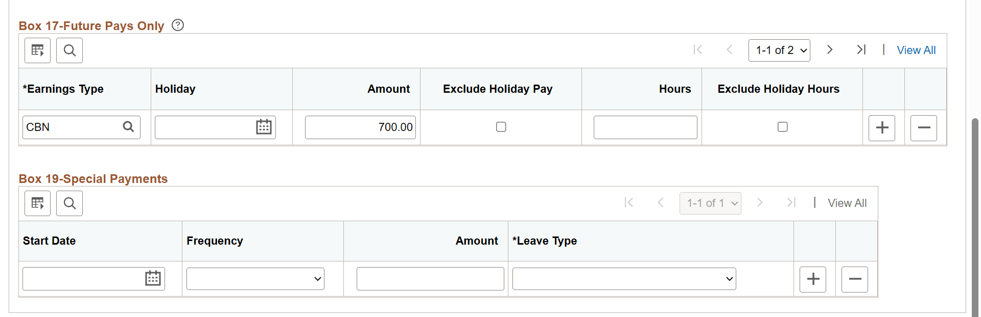

Box 17-Future Pays Only
Enter earnings paid to the employee after the employee's final pay period.
Field or Control
Description
Earnings Type
You must define the earnings code on the Tax Form Definition page.
Holiday
This field is used for box 17B, Statutory Holiday.
Amount
Enter the amount that you paid to the employee after the final period.
The system does not automatically add this amount to balances for year-end reporting. When you use this field, you are responsible for ensuring that the applicable balance records are updated to reflect these amounts.

You must enter additional vacation earnings manually on the ROE Data 2 page, Box 17. These earnings are reported in Box 15C.
Box 17B
Statutory Holiday Pay
For the earnings to be reported in box 17B, you must also enter the same earnings information on the ROE Data 2 page.
You must enter the earnings manually on the ROE Data 2 page, box 17. These earnings are reported in box 17B only.
You must enter the date of the holiday for which the employee is paid.
Box 17C
Other Monies
Earnings are reported in boxes 15C and 17C.
You must enter the earnings manually on the ROE Data 2 page, box 17. These earnings are reported in box 15C and 17C.
See also Defining Earnings for Translation to the ROE Form.
Box 18-Comments
These comments appear in block 18 on the ROE form. Use Box 18 only in extenuating circumstances where the reason codes provided are not sufficient to explain the need to issue a ROE. Comments entered in this box usually cause Service Canada to process the claim manually, delaying processing time.
Box 19-Special Payments
This group box corresponds to block 19 on the ROE form. Complete these fields only if the employee receives paid sick, maternity, parental leave, or group wage loss indemnity payments after the last day worked. These fields appear on the ROE form as you enter them here. The system does not validate them.
(CAN) Use the Import ROE Web Bulk File page (RUNCTL_PAY107CN) to import Service Canada serial numbers and amended serial numbers into the PeopleSoft system from the ROE Web bulk transfer file from Service Canada.
Navigation:
Payroll for North America > Periodic Payroll Events CAN > Record of Employment > Import ROE Web Bulk File > Import ROE Web Bulk File
This example illustrates the fields and controls on the Import ROE Web Bulk File page.
Field or Control
Description
File Name
Enter the filename of the applicable ROE Web bulk file from Service Canada.
The Import ROE Web Bulk File (PAY107CN) process enables you to import Service Canada serial numbers and amended serial numbers into the PeopleSoft system from the ROE Web bulk transfer file from Service Canada. It matches the PeopleSoft ROE data records with the records in the Service Canada web ROE bulk file. Prior to running this process, download the XML import file from Service Canada and save it to the PeopleSoft import directory specified in setenv.sqc.
The bulk transfer file from Service Canada may contain four types of ROEs (Issued, Rejected, Failed, or Passed) that are processed by PAY107CN as follows:
  • Issued: ROEs in the Service Canada file are set to an ROE Process status of Complete on the ROE Data 1 page and the serial number assigned by Service Canada is entered into the ROE Serial Number or Amended ROE Serial Number field on the HRSD Information page of the ROE Data component.
  • Rejected: ROEs in the Service Canada file are set to an ROE Process status of XML File Rejected on the ROE Data 1 page. The process also clears the PeopleSoft internal ROE number and updates the ROE insurable earnings to reflect a blank internal ROE number.
  • Failed: ROEs in the Service Canada file are set to an ROE Process status of XML File Failed on the ROE Data 1 page. The process also clears the PeopleSoft internal ROE number and updates the ROE insurable earnings to reflect a blank internal ROE number.
  • Passed: ROEs are ignored for processing as PeopleSoft does not support ROEs that are stored as Draft in the Service Canada ROE Web system. The process generates a warning message to identify Passed ROEs that were ignored for processing.
Rejected and Failed ROEs should be corrected and re-exported for submission to Service Canada.
See Record of Employment on the Web (ROE Web) - User Requirements on the Service Canada web site. As of the date of this publication, see Appendix C - Import XML File Format Specification.
(CAN) Use the HRSD Information page (ROE_DATA3) to view the ROE serial numbers from the Service Canada.
Navigation:
Payroll for North America > Periodic Payroll Events CAN > Record of Employment > Update ROE Data > HRSD Information
This example illustrates the fields and controls on the HRSD Information page.
Field or Control
Description
Original ROE Serial Number
Displays the ROE serial number that is provided by the Service Canada in the ROE Web import file.
Displays the amended ROE serial number that is provided by the Service Canada in the ROE Web import file.
ROE Sequence Number
When the Create Mass ROE Data (PAY124CN.SQR) runs, the system assigns a sequential number to identify different versions of an amended ROE. The same field appears on the ROE Data 1 page.
