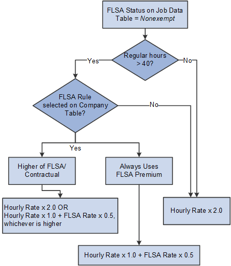

This diagram illustrates how the system calculates double-time based on options that are set on the Job Data Table, the Company Table, and the Alternative Overtime State Table.
For FLSA nonexempt employees, the system considers the FLSA rule specified on the Company Table (Default Settings page).
If the FLSA Required check box is selected and Higher of FLSA/Contractual is specified, then the system compares the amounts calculated for each of these 2 rules and picks the higher of the two:
Rule 1: Hourly rate times 2.0 for hours over 40.
Rule 2: Hourly rate times 1.0 (for the straight time portion) plus the FLSA rate times .5 (for the premium portion) for hours over 40.
If the FLSA Required check box is selected and Always uses FLSA Premium is specified, then the system calculates the double-time amount as follows for any hours over 40:
Hourly rate times 1.0 (for the straight time portion) plus the FLSA rate times .5 (for the premium portion).
Note: The premium portion of the double-time pay is always paid at .5, and not as specified on the earnings table. To ensure the multiplication factor on the earnings table is used in the calculation, the employee must be set up with FLSA Status of ALT OT, and the employee’s work state must be set up in the Alternative Overtime Table.
If the FLSA Required check box is not selected, then the system calculates the hourly rate times 2.0 for any hours over 40.

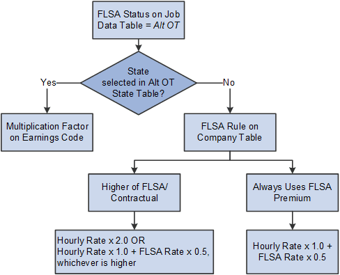

This diagram illustrates how the system calculates double-time for FLSA Alt OT employees based on the FLSA rule that is specified on the Company Table (Default Settings page).
For Alternative Overtime employees, the system determines if the employment state is listed on the Alternative Overtime State Table page.
If the state is listed in the Alternative Overtime State Table, then the system uses the multiplication factor in the Earnings Table to calculate the double-time pay regardless of whether the Company Table is set to Higher of FLSA/Contractual or Always Use FLSA Premium. If the double-time earnings code is set up with a multiplication factor of 2.0, then the double-time pay is calculated as follows for any hours over 40:
Hourly rate times 1.0 (for the straight time portion) plus the FLSA rate times 1.0 (for the premium portion).
Note: The premium portion is calculated using the FLSA rate regardless of which FLSA rule is selected on the Company Table.
If the state is not listed, then the system uses the FLSA rule that is set on the Company Table.

Example 1
On the Job Table the employee has an FLSA status of Non Exempt, and on the Company Table the rate to use is Higher of FLSA/Contractual.
5.00 hours x 20.00 USD (10.00 USD x 2.0) = 100.00 USD is higher than (5.00 hours x 10.00 USD) + (5.00 x 12.222222 x .5) = 80.56 USD.
The system will pay the employee 100.00 USD of overtime pay.
Example 2
On the Job Table the employee has an FLSA status of Non Exempt, and on the Company Table the rate to use is Always Use FLSA Premium. The system uses the Federal FLSA Rule, which is hourly rate times 1.0 (for the straight time portion) plus the FLSA rate times .5.
The system will pay the employee 80.56 USD of overtime pay.
Examples 3 and 4
The state is set up in the Alternative Overtime State Table and on the Job Table the employee has an FLSA status of Alt OT. Therefore the system uses the Multiplication Factor in the Earnings Table to determine the rate calculations regardless of whether the Company Table is set to Higher of FLSA/Contractual or Always Use FLSA Premium. In this example, the Double Time earnings code is set up with a multiplication factor of 2.0. The Category for FLSA has regular pay included. This means the employee will get the Premium Calc (FLSA) on anything over 1.0 (regular pay).
(5.00 hours x 10.00 USD) + (5.00 x 12.222222 x 1.0) = 111.11 USD
The system will pay the employee 111.11 USD of overtime pay.
Example 5
On the Job Table the employee has an FLSA status of ALT OT, but the employee’s state is not listed in the Alternative Overtime State Table. With this setup, the employee does not need to meet the 40-hour threshold to obtain an Alt OT calculation. The system bases the calculation on the Standard Federal FLSA calculation routine. The system looks at the Company Table and sees that the rate to use is the Higher of FLSA/Contractual.
5.00 hours x 20.00 USD (10.00 x 2.0) = 100.00 USD is higher than (5.00 hours x 10.00 USD) + (5.00 x 12.222222 x .5) = 80.56 USD.
Example 6
On the Job Table the employee has an FLSA status of ALT OT, but the employee’s state is not listed in the Alternative Overtime State Table. The same as in example 5, with this setup, the employee does not need to meet the 40-hour threshold to obtain an Alt OT calculation. The system bases the calculation on the Standard Federal FLSA calculation routine. However, in this example the system looks at the Company Table and sees that the rate to use is Always Use FLSA Premium. The system limits the overtime calculation to Federal rules of 1.5.
