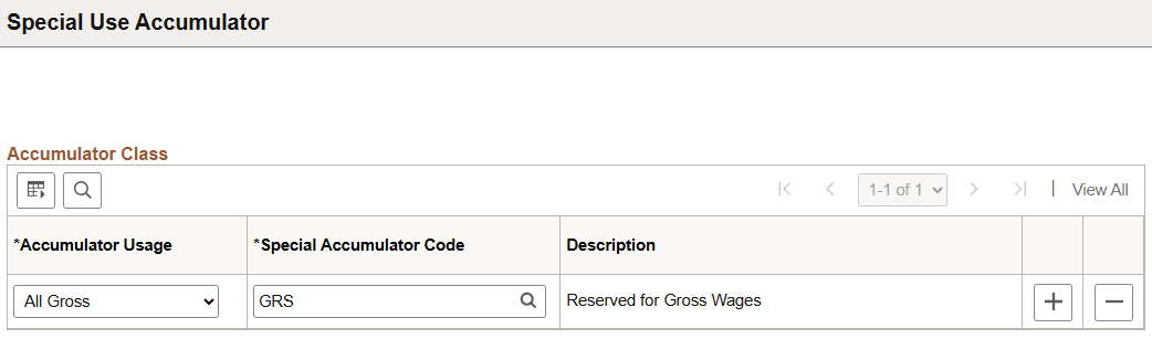

Use the Special Use Accumulator page (PY_SPCL_ACC_USE) to assign a special accumulator for tracking gross wages.
Navigation:
This example illustrates the fields and controls on the Special Use Accumulator page.
Field or Control |
Description |
Accumulator Usage |
Currently, the only supported usage is All Gross. |
Special Accumulator Code |
Enter the special accumulator code to be used to track gross wages. The system-delivered special accumulator is GRS. You can select an alternative special accumulator to use if preferred. Special accumulators are defined on the Special Accumulator Table Page. |
