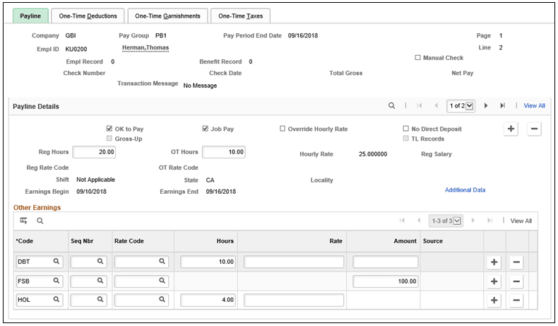

The user enters information such as flat sum bonus, overtime and double time hours to the payline:
Term
Definition
Current Pay Period
09/10/2018 - 09/16/2018
FLSA Period
Flat Sum Bonus (FSB)
$100
Reg Hours
20 hours
Holiday Hour (HOL)
4 hours
HOL (holiday) earnings code is set up to reduce regular hours, and is not subject to FLSA (Category for FLSA = Excluded)
OT Hours
10 hours
Double Time Hour (DBT)
10 hours
This example illustrates the fields and controls on the Payline page where flat sum bonus information is inserted.

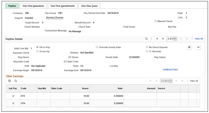

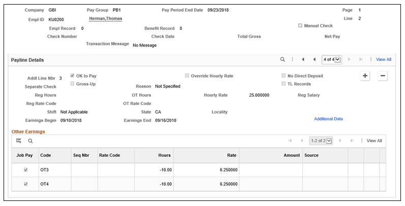

The system calculates the regular bonus rate in Pay Calculation, and inserts a new payline that contains the mapped earnings codes OT3 and OT4 in the Other Earnings section. Each earnings code row displays the corresponding number of hours, and the calculated regular bonus rate before the multiplication factor is applied, which is $6.25 ($100 / 16).
This example illustrates the fields and controls on the Payline page where mapped overtime codes, hours and calculated bonus rate are displayed.
This payline is system-generated and is not editable.

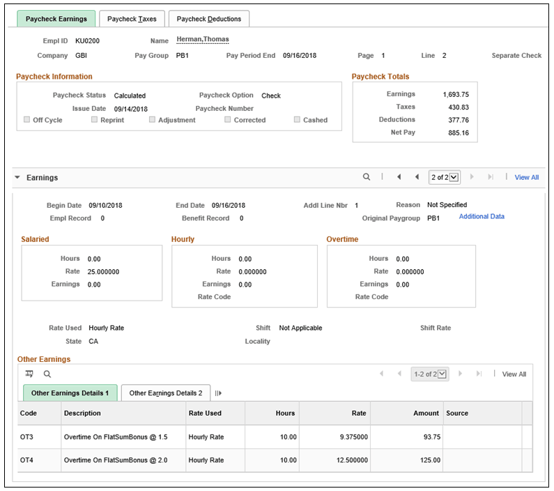

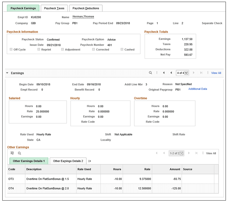

The paycheck displays the calculated hourly rate with the multiplication factor applied and amount for each of the Overtime on Flat Sum Bonus earnings codes OT3 and OT4:
Time-and-one-half (1.5) Overtime Pay on Flat Sum Bonus (OT3):
$6.25 x 1.5 x 10 = $93.75
Double-time (2.0) Pay on Flat Sum Bonus (OT4):
$6.25 x 2 x 10 = $125.00
This example illustrates the fields and controls on the Paycheck Earnings page where the calculated hourly rates (multiplication factor applied) and amounts for overtime on flat sum bonus are displayed.

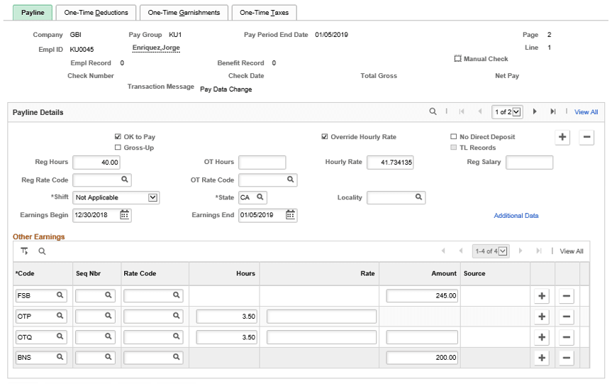

The user enters information such as flat sum bonus, straight time overtime and half time overtime to the payline:
Term
Definition
Current Pay Period
12/30/2018 - 01/05/2019
FLSA Period
$245
Reg Hours
40 hours
OT Hours - Straight Time (OTP)
3.5 hours
OT Hours - Half Time (OTQ)
3.5 hours

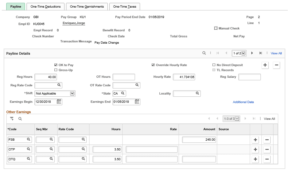

This example illustrates the fields and controls on the Payline page where flat sum bonus and overtime information is inserted.

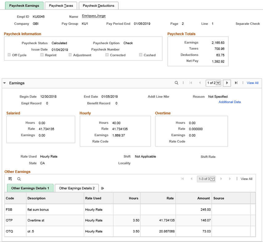

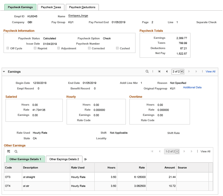

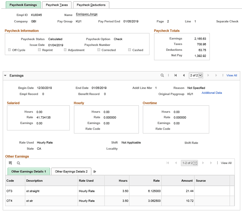

The system calculates the regular bonus rate, which is $6.125 ($245/40) in this example, in Pay Calculation.
The paycheck displays the calculated hourly rate (hourly rate or regular bonus rate, with the multiplication factor applied) and amount for each of the Overtime earnings codes (OTP and OTQ) and Overtime on Flat Sum Bonus earnings codes (OT3 and OT4) in the Other Earnings section of the paycheck:
Straight time (1.0) Overtime Pay (OTP):
$41.734135 x 1.0 x 3.5 = $146.07
Half time (0.5) Overtime Pay (OTQ):
$41.734135 x 0.5 x 3.5= $73.03
Straight time (1.0) Overtime Pay on Flat Sum Bonus (OT3):
$6.125 x 1.0 x 3.5= $21.44
Half time (0.5) Pay on Flat Sum Bonus (OT4):
$6.125 x 0.5 x 3.5 = $10.72
This example illustrates the fields and controls on the Paycheck Earnings page where the calculated hourly rates (multiplication factor applied) and amounts for overtime are displayed.
Suppose that in a slightly different scenario, a $200 FLSA-eligible bonus BNS is also added to the payline:
This example illustrates the fields and controls on the Payline page where FLSA-eligible bonus, flat sum bonus, and overtime information is inserted.

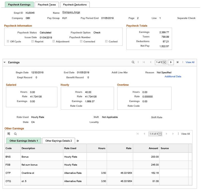

The paycheck displays the calculated hourly rate (with the multiplication factor applied) and amount for each of the Overtime earnings codes (OTP and OTQ) and Overtime on Flat Sum Bonus earnings codes (OT3 and OT4) in the Other Earnings section of the paycheck:
$46.331954 x 1.0 x 3.5 = $162.16
$46.331954 x 0.5 x 3.5= $81.08

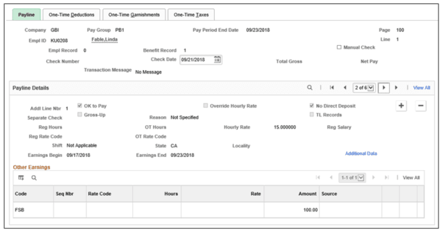

In this example, an adjustment (flat sum bonus) has been made to the same FLSA period as the previous example. This action results in a recalculation of the regular bonus rate and overtime payments for that FLSA week. In this scenario, the old bonus rate will be backed out, and a new one calculated.
The user enters $200 of flat sum bonus to the payline for the previous FLSA period:

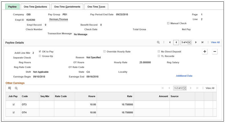

The system calculates the regular bonus rate in Pay Calculation, and inserts a new payline that contains the OT3 and OT4 earnings codes in the Other Earnings section with the corresponding number of hours, and the updated regular bonus rate before the multiplication factor is applied, which is $18.75 ($300 / 16). The $300 amount is the sum of the newly entered $200 and the $100 from the confirmed check of the prior period.
This example illustrates the fields and controls on the Payline page where mapped overtime codes, hours and updated bonus rate are displayed.

The paycheck displays the updated hourly rate with the multiplication factor applied and amount for each of the Overtime on Flat Sum Bonus earnings codes OT3 and OT4:
$18.75 x 1.5 x 10 = $281.25
$18.75 x 2 x 10 = $375.00

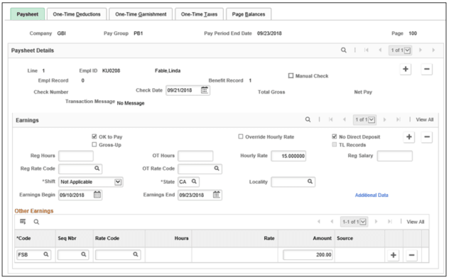

In this example, a $200 flat sum bonus is entered on an off-cycle payroll for the period between September 10 and September 23, which includes two FLSA periods:
First: 09/10/2018 - 09/16/2018
Second: 09/17/2018 - 09/23/2018
This example illustrates the fields and controls on the Paysheet page where a flat sum bonus is applied to two FLSA periods.
During pay calculation, the flat sum bonus amount of $200 is split into these two FLSA periods automatically, $100 for each period:
