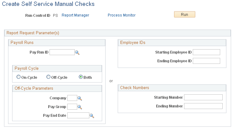

(USA, USF) Use the Create Self Service Manual Checks page (RUNCTL_CHK_ADV1_MC) to run a process to create a PDF manual check that the employee can view in the ePay self-service View Paychecks transaction.

This example illustrates the fields and controls on the Create Self Service Manual Checks page.
Note: (CAN) Fields and controls on the Create Self Service Manual Cheques page for Canada have the same behavior as on the Create Self Service Manual Checks.
To make the PDF manual check available for viewing by the employee in the ePay View Paychecks self-service transaction, use this run control page to run the Print US Checks PSJob process or the Print Canadian Cheques PSJob process.
Note: Manual checks of $0 or negative net pay amounts are available for self-service viewing only if you have selected the applicable manual paycheck options for zero and negative net pay amounts on the Paycheck Options Table Page.
Payroll Runs
The report request parameters are similar to those on the Print Pay Checks page.
Employee IDs
To process a single employee, enter the starting employee ID and leave the ending ID blank.
Check Numbers
To process a single check number, enter the starting number and leave the ending number blank.
