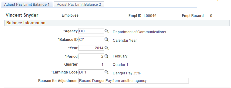

(USF) Use the Adjust Pay Limit Balance 2 page (GVT_ADJ_PYLIM_BAL1) to identify the pay limit balance to adjust.
Navigation:
This example illustrates the fields and controls on the Adjust Pay Limit Balance 1 page.
Enter and save data on the Adjust Pay Limit Balance 1 page to access the Adjust Pay Limit Balance 2 page with relevant balance adjustment data displayed.
Field or Control |
Description |
Agency |
Identify the Agency the balances will be tracked under. |
Balance ID |
Identify the type of balance being adjusted, such as calendar year, fiscal year, and so forth. |
Year |
Enter the year the balances will be tracked under. |
Period |
Identify the period within the balance ID that is to be adjusted. For example, if the calendar year and the fiscal year span different time periods, September would be period nine for the calendar year and could be period one for the fiscal year. |
Quarter |
Displays the quarter that corresponds to the balance ID and period that you entered. |
Earnings Code |
Enter earnings code used for Pay Limits. |
Reason for Adjustment |
This field is required. Text that you enter here becomes part of the adjustment record and your audit trail. Error (1640, 210) is issued if left blank. |

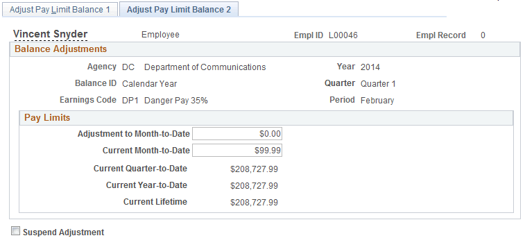

(USF) Use the Adjust Pay Limit Balance 2 page (GVT_ADJ_PYLIM_BAL2) to enter the pay limit adjustment.
Navigation:
This example illustrates the fields and controls on the Adjust Pay Limit Balance 2 page.
To access the Adjust Pay Limit Balance 2 page with relevant balance adjustment data displayed, you must enter and save data on the Adjust Pay Limit Balance 1 page. When you save the Adjust Pay Limit Balance 1 page, the system updates the employee’s pay limit balance record and displays data on the Adjust Pay Limit Balance 2 page. You can then make multiple adjustments to the employee’s balances without having to retype information.
Field or Control |
Description |
Adjustment to Month-to-Date or Current Month-to-Date |
Enter the month-to-date pay limit adjustment to make for this employee, or enter the current cumulative month-to-date pay limit adjustment total for this employee. When you enter a value in either field and tab out of that field, the system updates all the other fields in the Pay Limits group box based on the value that you entered. |
Suspend Adjustment |
Before saving the Adjustment to Month-to-Date or Current Month-to-Date field values, the user may select the Suspend Adjustment check box to return to the Adjust Pay Limit Balance 1 page and restart the pay limit adjustment. Note: This field only appears on the Adjust Pay Limit Balance 2 page when data is entered on Adjust Pay Limit Balance 1 page, and the page is saved. |

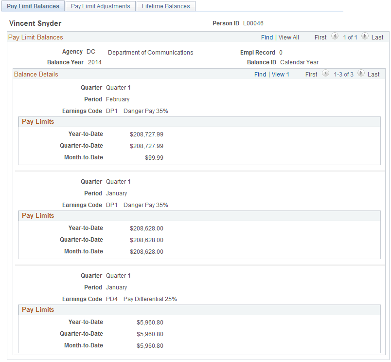

(USF) Use the Pay Limit Balances page (GVT_BAL_PAY_LIM1) to view an employee’s current year pay limit balance.
Navigation:
This example illustrates the fields and controls on the Pay Limit Balances page.
The system automatically updates information on the Review Pay Limit Balances pages each time you confirm a payroll or make an online adjustment.
Functionality in the Review Pay Limit Balance component is similar to functionality described in Understanding Employee Balance Adjustments.

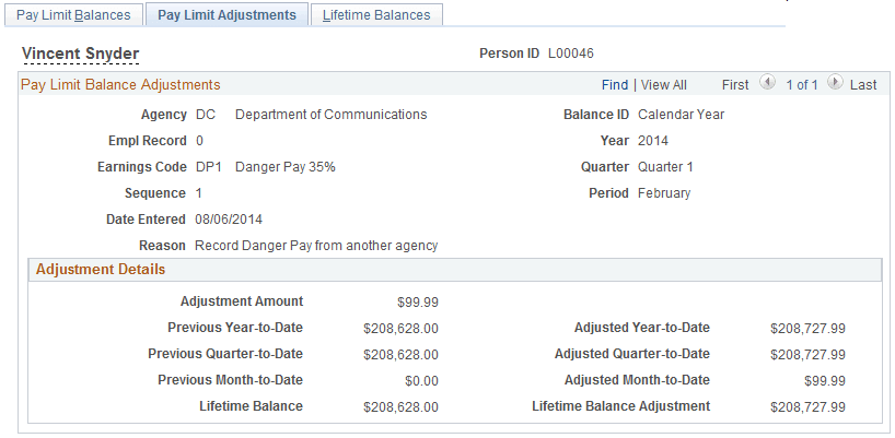

(USF) Use the Pay Limit Adjustments page (GVT_BAL_PAY_LIM2) to view adjustments made to an employee’s pay limit balances.
Navigation:
This example illustrates the fields and controls on the Pay Limit Adjustments page.
Note: No correlation exists between the scroll areas on the Pay Limit Balances page and its associated Pay Limit Adjustments page in the Review Pay Limit Balances (GVT_BAL_PAY_LIMIT) component. For example, if you're viewing a particular monthly pay limit balance on the Pay Limit Balances page, the Pay Limit Adjustments tab takes you to the employee's pay limit balance adjustments, but not necessarily the adjustments of that particular monthly pay limit balance.

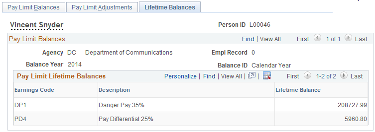

(USF) Use the Lifetime Balances page (GVT_BAL_PAY_LIM3) to view a summary of an employee’s lifetime pay limit balances and determine a terminated employee’s payout.
Navigation:
This example illustrates the fields and controls on the Lifetime Balances page.
A running total of all lifetime balances for the calendar year appears in the Pay Limit Lifetime Balances grid on the Lifetime Balances page. If these balances were available for the first payroll of the year, or the employee was terminated, the employee is entitled to a payout of the sum all of the Lifetime Balance rows.
The employee may have lifetime balances of YTD deferred earnings for several calendar years in the database, for which payout is due. Consider using the download option to download all of the employee’s lifetime pay limit balances to a spreadsheet to determine to total payout amount.
