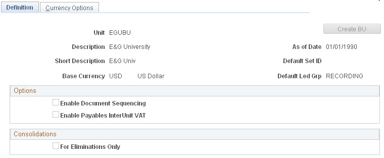

Use the Review GL Business Units - Definition page (BUS_UNIT_TBL_GL1) to view the definition of PeopleSoft General Ledger business units.
Note: If you are using PeopleSoft General Ledger, this page is display-only. If you are not using PeopleSoft General Ledger, the fields on this page are editable. Use this page to set up GL business units.
Navigation:
This example illustrates the fields and controls on the Review GL Business Units - Definition page.
PeopleSoft HCM processes use the information in the Unit and Base Currency fields only.
Field or Control |
Description |
Unit |
The PeopleSoft General Ledger business unit you selected to access the page. |
Base Currency |
The base currency for this PeopleSoft General Ledger business unit. A General Ledger business unit supports one base currency per ledger. This is usually the local currency for the organization, but accounting rules or other circumstances might dictate that it be different. |
Options
Field or Control |
Description |
Enable Document Sequencing |
This check box is selected if document sequencing is required for this business unit. |
Enable Payables InterUnit VAT (enable Payables interunit value added taxes) |
This check box is selected if payables interunit value added taxes (VAT) is required for transactions between related parties. |
Consolidations
Field or Control |
Description |
For Eliminations Only |
This check box is selected if this business unit is an eliminations entity for consolidations processing. |

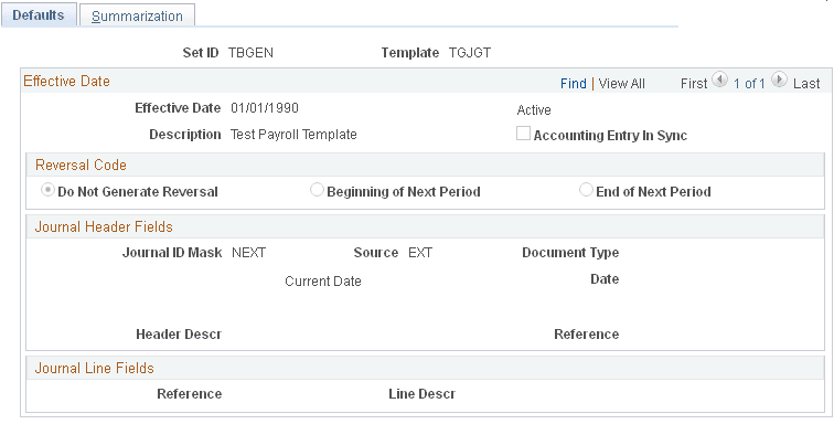

Use the Review Journal Generator Tmpl - Defaults page (JRNL_GEN_DEFAULTS) to view Journal Generator defaults.
Navigation:
This example illustrates the fields and controls on the Review Journal Generator Tmpl - Defaults page.
PeopleSoft HCM processes use only the SetID and Template fields.
If you are not interfacing with PeopleSoft Financials, this page is editable. To set up a journal generator template enter a:
Template ID.
SetID.
The setID needs to match the setID of the General Ledger business units you created on the Review GL Business Units component (BUS_UNIT_TBL_GL) for the business unit to use a journal generator template.
The remaining fields are not required, so you can enter dummy information or leave them blank.

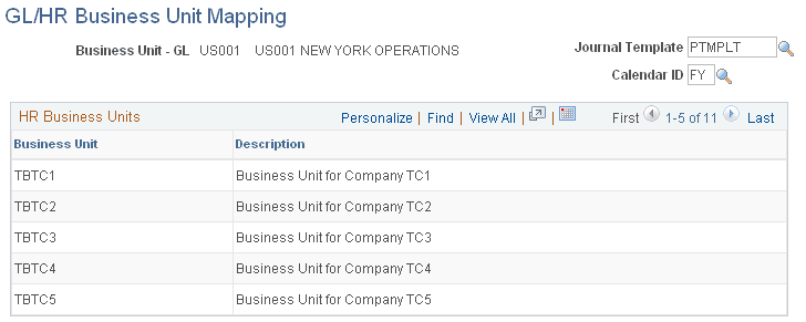

Use the GL/HR Business Unit Mapping page (BU_GL_HR_LNK) to verify that the General Ledger business unit is associated with the correct HCM business unit.
Navigation:
This example illustrates the fields and controls on the GL/HR Business Unit Mapping page.
Associate a journal template with each General Ledger business unit.
Field or Control |
Description |
Business Unit - GL |
The PeopleSoft General Ledger business unit and description. |
Journal Template |
Select the journal template to associate with this PeopleSoft General Ledger business unit from the list of available options. Journal templates are used during the Actuals and Encumbrances processes (PAYGL02 and PAYGL03). |
Calendar ID |
If you use commitment accounting, select a calendar ID to associate with this PeopleSoft General Ledger business unit. The system uses calendar IDs to distribute actuals over accounting periods. Review calendars on the Detail Calendar page (DETAIL_CALENDAR1). |
HR Business Units
The HR Business Units scroll area displays the PeopleSoft HCM business units and descriptions currently associated with the PeopleSoft General Ledger business unit.
If the PeopleSoft HCM and PeopleSoft General Ledger business units aren't correctly mapped, correctly associate them on the Business Unit Reference page. After mapping PeopleSoft HCM business units to the appropriate General Ledger business units, return to the GL/HR Business Unit Mapping page to associate a journal template and calendar ID with each General Ledger business unit.
