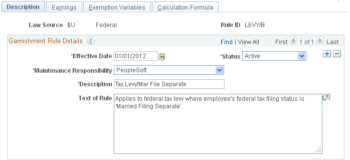

Use the Garnishment Rules Table - Description page (GARNISH_RULE_TBL1) to view or enter identifying and descriptive information for a garnishment rule.
Navigation:
This example illustrates the fields and controls on the Garnishment Rules Table - Description page.
Field or Control |
Description |
Garnish Law Source |
The particular jurisdictional entity for the garnishment. |
Rule ID |
The unique rule ID that identifies a garnishment rule. The rule ID along with the garnish law source links the garnishment rule specifications to the garnishment specification data for an individual employee. Note: (CAN) You can use any rule if it applies to a garnishment situation, regardless of the original province designation. The ZZ value identifies federally related orders. |
Maintenance Responsibility |
In addition to the PeopleSoft-maintained garnishment rules, you can set up your own garnishment rules to handle any exceptions to the delivered rules. Customer: This value indicates that it is your responsibility to maintain rules that you have revised, cloned, or defined. |

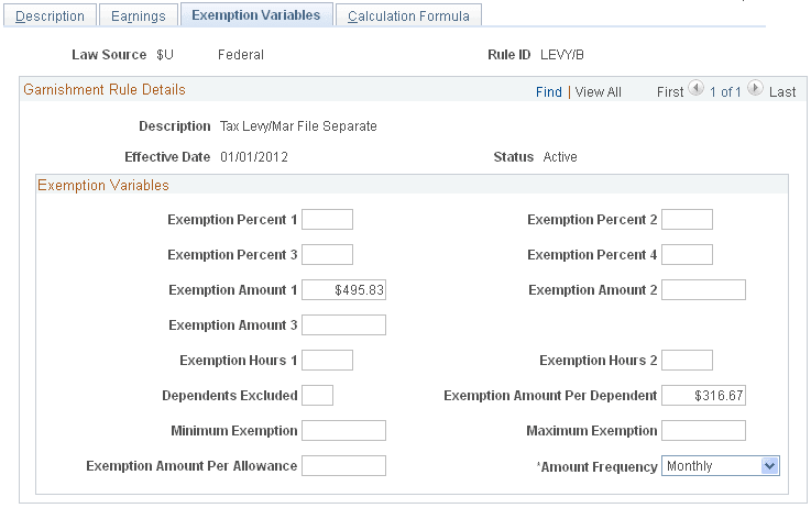

(USA) Use the Exemption Variables page (GARNISH_RULE_TBL3) to view or enter amounts for exemption variables to be used in the calculation formula for the rule.
Navigation:
This example illustrates the fields and controls on the Exemption Variables page for the U.S.
Exemption Variables
View or enter values for the variables that you need in the calculation formula for this rule.
Field or Control |
Description |
Dependents Excluded |
Specify the number of dependents to exclude before applying the exempt amount per dependent. For example, for an exemption of 30 USD per dependent when an employee has more than two dependents, enter 2 in this field, and enter 30 in the Exempt Amount Per Dependent field. |
Minimum Exemption and Maximum Exemption |
If you enter values for these options and specify the Min/Max Check condition for a step in the calculation formula, the system compares the calculation results for the step to the minimum and maximum exemption amounts that you enter here. If the amount is less then the minimum, the system uses the minimum. If the amount is greater than the maximum, the system uses the maximum. |
Amount Frequency
Select the frequency that applies to the exemption variable amounts for this garnishment rule. The default frequency is Monthly.
Note: If your selections on this page do not match the pay group pay frequency, the system automatically performs a conversion.

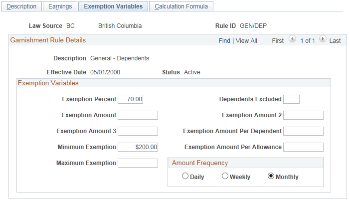

(CAN) Use the Exemption Variables page (GARN_RULE_TBL3_CN) to view or enter amounts for exemption variables to be used in the calculation formula for the rule.
Navigation:
This example illustrates the fields and controls on the Exemption Variables page for Canada.
Exemption Variables
Field or Control |
Description |
Specify the number of dependents to exclude before applying the exempt amount per dependent. For example, for an exemption of 30 CAD per dependent when an employee has more than two dependents, enter 2 in this field, and enter 30 in the Exempt Amount Per Dependent field. |
Exemption Amount |
Enter the exemption amount for the debtor. |
Exemption Amount 2 |
Enter the exemption amount for the debtor’s first dependent. |
Exemptions Amount 3 |
Enter the exemption amount for each of the debtor’s additional dependents. |
Amount Frequency

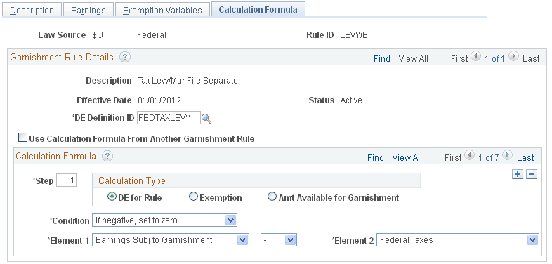

Use the Calculation Formula page (GARNISH_RULE_TBL4) to create step-by-step formulas for calculating garnishments or the amount available for garnishment.
Navigation:
This example illustrates the fields and controls on the Calculation Formula page.
Field or Control |
Description |
DE Definition ID (disposable earnings definition ID) |
Select the disposable earnings definition that you want to use with this garnishment rule. It is important to select the correct DE definition ID. Note: Only two IDs are supported for Canadian garnishment processing. They are FEDERALCAN and FEDCANEXBN. |
(USA) Referencing a Calculation Formula From Another Garnishment Rule
Field or Control |
Description |
Use Calculation Formula From Another Garnishment Rule |
To reference the calculation formula of another rule, select this option and enter the law source, rule ID, and effective date of the rule that you want to reference. The referenced rule must have a self-contained calculation formula that does not reference another rule. The system stores the identification of the referenced rule rather than the formula steps. |
Law Source, Rule ID, and Effective Date |
These options become visible on the page if you select Use Calculation Formula From Another Garnishment Rule. Identify the rule whose calculation formula you want to reference in this rule. |
See (USA) Understanding Calculation Formula Referencing.
Note: These fields are not visible on the page for Canada.
Calculation Formula
Use this group box to create a step-by-step formula for calculating the garnishment or the amount available for garnishment.
Note: (USA) If you select Use Calculation Formula From Another Garnishment Rule, the fields in this group box are unavailable for data entry.
Field or Control |
Description |
Step |
The step or sequence number in the calculation formula. |
Calculation Type |
Select the option that identifies what the formula step is calculating. Options are: DE for Rule (disposable earnings for rule), Exemption, or Amt Available for Garnishment (amount available for garnishment). |
Condition |
If necessary, specify how to handle the end result of a step. Options are: If negative, set to zero, Greater of Elements 1 and 2, Lesser of Elements 1 and 2, Min/Max Check (minimum and maximum check), and None. |

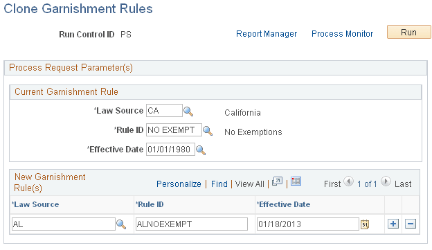

Use the Clone Garnishment Rules page (RUNCTL_GARNCLONE) to clone an existing garnishment rule using the Rules Clone Utility Application Engine process (GARN_CLONE). Copy all data from an existing garnishment rule to create another rule identified with a different combination of law source, and rule ID.
Rules created in this way are customer-maintained rules.
Navigation:
This example illustrates the fields and controls on the Clone Garnishment Rules page.
Current Garnishment Rule
Select the law source, rule ID, and effective date of the rule that you want to copy.
New Garnishment Rule(s)
For each new rule that you want to create based on the current rule, enter the law source, rule ID, and effective date.
You can clone one law source and rule ID combination into multiple combinations of law source and rule ID by adding rows and entering the identifiers.
Note: You must enter an effective date for each new rule that you create. You can enter the same effective date for multiple rules as long as the law source and rule ID combination is unique.
