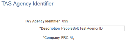

Use the TAS Agency Identifier page (GVT_TAS_AGENCY_ID) to enter the agency identifier code and description.
Navigation:
This example illustrates the fields and controls on the TAS Agency Identifier page.
Field or Control |
Description |
Agency Identifier and Description |
Enter an agency identifier (three-digit numeric value) and description. Valid values are 000 through 999. If you enter fewer than three digits, the system supplies leading zeros. You can define as many companies or agencies as you need, but each company or agency must have its own unique three-digit identifier in the range from 000 through 999. |

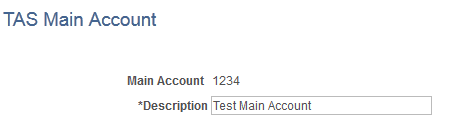

Use the TAS Main Account page (GVT_TAS_MAIN_ACCT) to enter the Main Account code and description.
Navigation:
This example illustrates the fields and controls on the TAS Main Account page.
Field or Control |
Description |
Main Account and Description |
Enter main account identifier (four-digit numeric value) and description. Valid values are 0000 through 9999. You can define as many main accounts as you need, but each main account must have its own unique four-digit identifier in the range from 0000 through 9999. |

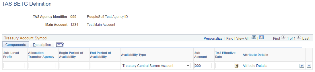

Use the TAS BETC Definition page (GVT_TAS_DEFN) to enter key values (Agency Identifier Code and Main Account) to create an agency and main account combination, define attributes (components) for funding accounts within that combination, and generate a componentized TAS for each funding account.
Navigation:
This example illustrates the fields and controls on the TAS BETC Definition page.
Field or Control |
Description |
Sub-Level Prefix |
Enter a two-digit numeric sub-level prefix value, or leave blank if not applicable. Valid values are 00 through 99. The sub-level prefix is a programmatic breakdown of the account for Treasury publication purposes |
Allocation Transfer Agency |
Enter a three-digit numeric allocation transfer agency identifier value, or leave blank if not applicable. Valid values are 000 through 999. If you enter less than three digits, the system supplies leading zeros. |
Begin Period of Availability and End Period of Availability |
You must enter either a begin year and end year for the period during which you want this account to be available, or you must enter an Availability Type code. If you enter begin and end years, use the 4-digit year format, for example 2014. In annual and multi-year funds, begin and end year dates identify the first and last year of availability under law that an appropriation account may incur new obligations. |
Availability Type |
An availability type code identifies availability by account type code, as follows:
Sub Account |
Enter a three-digit numeric sub-account code. Valid values are 000 through 999. The sub-account code identifies an available receipt or other Treasury-defined subdivision of the main account. |
TAS Effective Date |
Enter the date on which the componentized TAS should become effective. Note: This field is for future use, and is not currently reported to the Treasury. |
Attribute Details |
Click this link to create a system-generated GWA TAS identifier code and Business Event Type Code (BETC) for this combination of details. The system redirects you to the TAS Attributes page where you can see the results and enter the appropriate fund code information. Note: You cannot save the TAS BETC Definition page without first clicking the Attribute Details link to generate the GWA TAS code. |

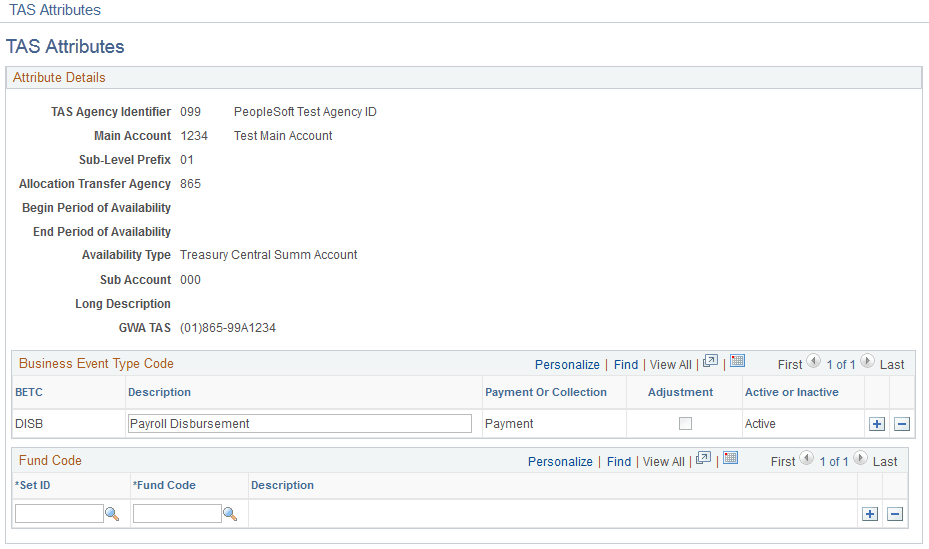

Use the TAS Attributes page (GVT_TAS_DEFN_ATTR) to view the list of components in the componentized TAS for a funding account, and associate BETCs and fund codes with the componentized TAS.
Navigation:
Click the Attribute Details link on the TAS BETC Definition page.
This example illustrates the fields and controls on the TAS Attributes page.
Attribute Details
The system displays the list of components that comprise the componentized TAS.
Field or Control |
Description |
GWA TAS (Government Wide Accounting Treasury Account Symbol) |
The system displays the unique GWA TAS code that represents the componentized TAS. The system generates this code when you click the Attribute Details link on the TAS BETC Definition page. |
Field or Control |
Description |
BETC (Business Event Type Code) |
The system displays the default BETC for the componentized TAS. DISB (Payroll Distribution) is the default BETC for all TAS components. You can specify additional BETCs here to associate with the componentized TAS, if needed. |
Fund Code
Field or Control |
Description |
Set ID and Fund Code |
You must associate at least one fund (set ID and fund code combination) with each componentized TAS. You can link more than one fund code to each componentized TAS; however, a fund code can be related to only one componentized TAS. |
