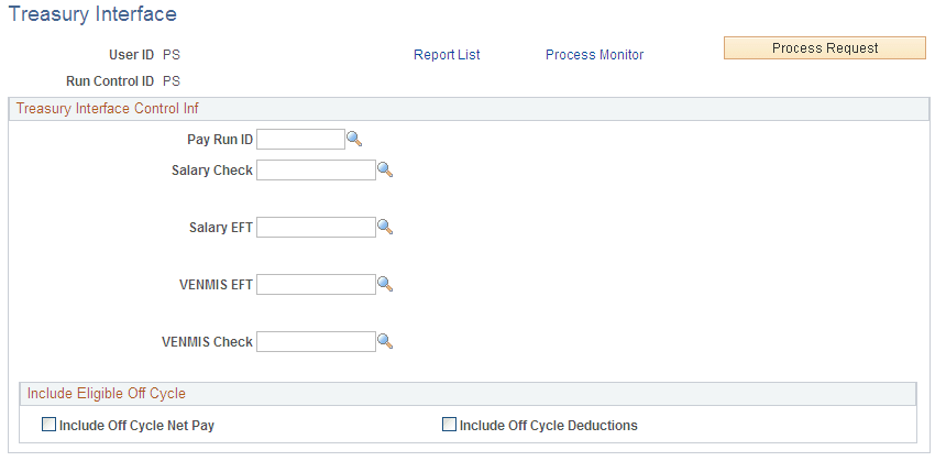

(USF) Use the Treasury Interface page (RUN_FGPY003) to select the control information that identifies the schedules to include in the Treasury Interface SQR Report process (FGPY003).
Navigation:
This example illustrates the fields and controls on the Treasury/Federal Reserve Bank Bond Interface page.
Treasury Interface Control Inf
Field or Control |
Description |
Salary Check |
Select the schedule of the checks in the payroll run, and enter the file name and extension. |
Salary EFT (salary electronic file transmission) |
Select the schedule of the EFT transactions of the payroll run, and enter the file name and extension. |
VENMIS EFT (vendor/miscellaneous electronic file transmission) |
Select the schedule of the EFT tax payment in the payroll run, and enter the file name and extension. |
VENMIS Check (vendor/miscellaneous check) |
Select the schedule of the check tax payment of the payroll run. |
Include Eligible Off Cycle
Field or Control |
Description |
Include Off Cycle Net Pay |
Select to include unprocessed off-cycle net pay in the Treasury interface processing. |
Include Off Cycle Deductions |
Select to include unprocessed off-cycle deductions in Treasury interface processing. |
