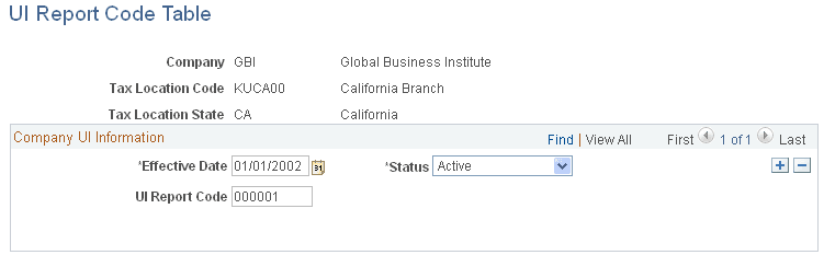

(USA) Use the UI Report Code Table page (CO_UI_RPTCD_TBL) to establish UI report codes in PeopleSoft Payroll for North America for multiple work sites.
Navigation:
This example illustrates the fields and controls on the UI Report Code Table page.
Company UI Information
Field or Control |
Description |
UI Report Code |
Enter the code you have received from the state for this site. |
Employer ID Ext (employer ID extension) |
This field is available for data entry when the tax location state is MI or MN. Enter the employer ID extension for reporting multiple worksite data. |
