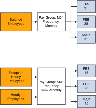

Pay Group Setup Example
Here is an example of setting up pay groups for a company:
Pay Group |
Description |
MO1–Monthly |
Employees who are paid monthly and share the same pay period, which ends on the last day of the month, can belong to the same pay group. Salaried employees at CCB are paid monthly. |
SM1–Semimonthly |
Employees who are paid semimonthly, and share the same pay periods (ending on the 15th and last day of the month) can also belong to the same pay group. Exception hourly and hourly employees at CCB are paid semimonthly. |
This diagram shows an example of pay group setup for salaried, exception hourly, and hourly employees:
This diagram shows an example of pay group setup for salaried, exception hourly, and hourly employees.
