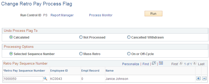

Use the Change Retro Pay Process Flag page (RUNCTL_RTROPAYUNDO) to change the process flag value in the Retro Pay Request table for retro pay requests.
Navigation:
This example illustrates the fields and controls on the Change Retro Pay Process Flag page.
Undo Process Flag To
Indicate the new process flag value to apply to the affected retro requests: Calculated, Not Processed, or Cancelled/Withdrawn.

Retro Pay Sequence Number
This group box is visible only when the process option is Selected Sequence Number.
Field or Control |
Description |
Retro Pay Sequence Number |
Select the sequence numbers for the retro requests that you want to update. Although you enter the sequence number, you can use the field prompt to search for sequence numbers based on the EmplID, the employee name, or the current value of the retro pay process flag. You cannot select retro requests that are already processed and closed. Retro requests in these statuses are considered closed: Manually Loaded to Paysheet Loaded to Paysheets Paycheck Reversed Confirmed Payment Cancelled/Withdrawn |

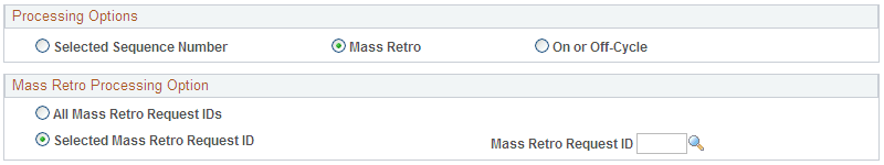

Mass Retro Processing Option
This group box is visible only when the selected process option is Mass Retro.
This example illustrates the fields and controls on the The Mass Retro Processing Option group box appears when you choose to process mass retro.
Field or Control |
Description |
All Mass Retro Request IDs |
Select this option to change the process flag for all retro requests that were created by the Retroactive Pay Mass Process. |
Selected Mass Retro Request ID and Mass Retro Request ID |
Select the Selected Mass Retro Request ID option to update the process flag in the retro requests that are associated with the mass retro request that you identify. |

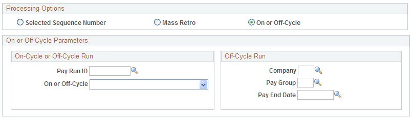

On-Cycle or Off Cycle Parameters
This group box is visible only when the selected process option is On or Of-Cycle. Use the fields in this group box to specify which pay runs to process. The system changes the process flag of any retro request included in the pay run.
This example illustrates the fields and controls on the The On-Cycle or Off Cycle Parameters group box appears when you choose to process on or off-cycle pay runs.
Field or Control |
Description |
Pay Run ID |
If you use this field, all fields in the Off-Cycle Run group box become unavailable for entry. |
Company |
If you use this field, the Pay Run ID and On or Of-Cycle fields become unavailable for entry. |
