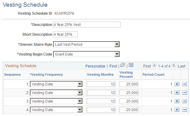

Use the Vesting Schedule page (ST_VEST_SCHED) to create vesting schedules.
Navigation:
This example illustrates the Vesting Schedule page.

Uneven Share Rule |
Indicate how the system is to handle fractional shares: Last Vest Period. Allocate to the last vesting period. This is the default value. First Vest Period. Allocate to the first vesting period. First Full Share. Accumulate over the vesting periods until the fractional shares add up to one full share, then add the share to the vesting period where that occurs. |
Vesting Begin Code |
Select Grant Date (the default) to have vesting start on the grant date. Select Start/Hire Date to have vesting to start on the effective date of the Action of Hire. Select Other Date to enter a random date at the time of the grant on the Maintain Grants - Vesting page, the Modify Grants - Modify page, or the Create VC Grants - Grant page. |
Sequence |
This field displays the row number in the vesting period sequence. Vesting schedules frequently have more than one sequence. For example, you can vest 25 percent of the grant after one year and then vest in quarterly increments over the next three years. |
Vesting Frequency |
You can select different vesting frequencies for different sequences within one vesting schedule. For each, the first vest date depends on the Vesting Begin Code selection. All other vest dates (excluding the first vest date) depend on the previous period vest date. The vesting frequency must logically match the vesting months. Values are Vest Date (all shares vest as of the Vesting Begin Code date), Monthly, Quarterly, SemiAnnual, and Annually. |
Vesting Months |
Enter the number of months in each vesting period. The vesting months must logically match the vesting frequency. |
Vesting Percent |
Enter the percentage of shares vested during each vesting period. The sum of the percentages must total 100%. |
Period Count |
This field displays the number of vest periods relative to the Vesting Frequency you selected and the number of Vesting Months you entered for the sequence. For example, if you select a Vest Frequency of Quarterly and enter 36 in the Vesting Months field, the system calculates a Period Count of 12 (the number of quarters in 36 months). |
