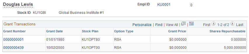

Use the Repurchase Options - Select Grant page (ST_REPURCH_SRCH1) to select the grant for which you want to view or record repurchase transactions.
Navigation:
This example illustrates the fields and controls on the Repurchase Options - Select Grant page.
Field or Control |
Description |
Grant Number |
Click to access the Repurchase Transactions page, where you can view the existing repurchase transactions for the grant and access the Stock Option Repurchases page to record a repurchase. |

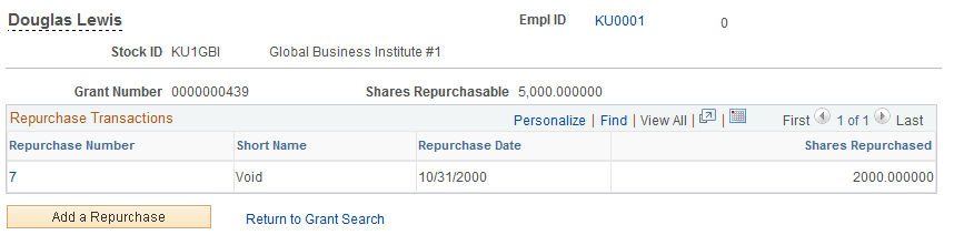

Use the Repurchase Transactions page (ST_REPURCH_SRCH2) to view repurchase transactions and access the Repurchase Options page.
Navigation:
Click a grant number on the Repurchase Options - Select Grant page.
This example illustrates the fields and controls on the Repurchase Transactions page.
Field or Control |
Description |
Shares Repurchasable |
Displays the number of shares available for repurchase as of the current date. |
Repurchase Number |
Click the repurchase number to access the Repurchases page, which displays the details of the repurchase. |
Add a Repurchase |
Click to access the Repurchases page, where you can add a new repurchase. |

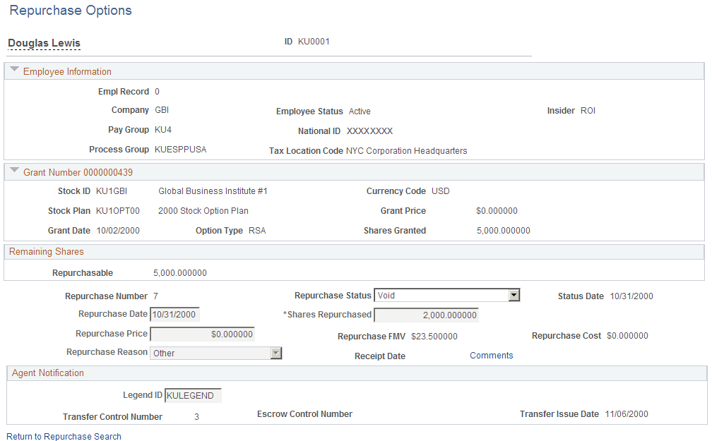

Use the Repurchase Options page (ST_GRANT_REPURCH) to record repurchase transactions.
Navigation:
Click a repurchase number or the Add a Repurchase button on the Repurchase Transactions page.
This example illustrates the Repurchase Options page.
To record a repurchase transaction:
Access the Repurchase Grant Transactions page for a selected employee ID and stock ID.
Click the grant number to access the Repurchase Transactions page.
Click the Add a Repurchase button to access the Repurchases page.
Record the details of the repurchase.
Employee Information
The displayed information is as of the repurchase date.
Field or Control |
Description |
Person Type |
Displays the person type, if the optionee is a nonemployee. |
Insider |
Displays the insider status, if the optionee is an insider. |
Pay Group |
Displays the pay group of the primary job. |
Tax Location Code |
Displays the tax location of the primary job. |
Remaining Shares
Field or Control |
Description |
Repurchasable |
Displays the maximum number of shares that are available for repurchase as of the repurchase date. These are derived from the number of restricted exercised options not released from escrow that have not yet been repurchased, canceled, or expired. |
Repurchase Information
Field or Control |
Description |
Repurchase Number |
Displays NEW when you enter a repurchase. When you save, the system generates a sequential repurchase number from the last repurchase number stored in the Stock Table. |
Repurchase Status |
Select a repurchase status: Active (default) or Void. |
Status Date |
Displays the date when the repurchase status changed. |
Repurchase Date |
As you change this date, the Shares Repurchasable amount might change. If you enter a date that exceeds the Days to Repurchase field on the Stock Option Plan Rules - General page, the system displays a warning. |
Shares Repurchased |
Enter the number of shares to be repurchased. The Shares Repurchasable amount is the default. |
Repurchase Price |
The system calculates the default repurchase price based on the share cost method defined on the Stock Option Plan Rules - General page. You can change this value to repurchase shares at a different price. |
Repurchase FMV |
Displays the calculated FMV based on the rule defined on the Stock Option Plan Rules - FMV Rules page. |
Repurchase Cost |
Displays the total repurchase cost, calculated by multiplying the number of shares that are repurchased by the repurchase price. |
Repurchase Reason |
Select Terminatn (termination), Corporate, or Other. |
Receipt Date |
Displays the date on which the repurchase receipt was generated. |
Comments |
Click to access the Grant Repurchase Comments page, where you add comments about the repurchase. |
Agent Notification
Field or Control |
Description |
Legend ID |
Select a legend ID to include with the repurchase issuance instructions. |
Transfer Control Number, Escrow Control Number, and Transfer Issue Date |
These fields are populated after you run the Agent Issuance Instruction report. They display the control numbers of the issuance instructions that were sent to the transfer agent and the escrow agent, and the date on which the transfer issuance instructions were generated. |
