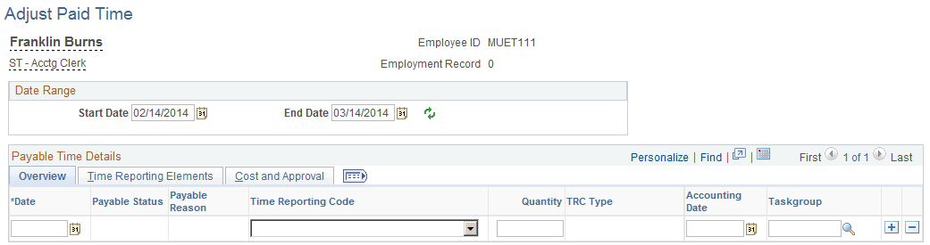

Use the Adjust Paid Time page (TL_MNG_PAY_DET_PNL) to make Record Only adjustments for individual employees or for non-employees.
Navigation:
This example illustrates the fields and controls on the Adjust Paid Time page. You can find definitions for the fields and controls later on this page.
Note: If you change or add Leave Time Taken, you must manually change the leave hours in your HR database. The system will not adjust your leave balances. Also, the system will not adjust compensatory time balances for changes or additions of reported compensatory time.
Field or Control |
Description |
Date |
Enter the date you want to adjust for the time that was paid. |
Payable Status |
Displays the payable status for the reported time: Closed, Diluted, Distributed or Rejected. Note: For rows of payable time that have a status of Rejected, a Close check box is displayed. When you select this check box, you prevent the row from being loaded to payroll. After you select the Close check box and save the page, the payable status remains Rejected. (Behind the scenes, the Payroll Request Number is set to 1.) |
Reason Code |
The reason code associated with the payable status. |
Time Reporting Code |
Enter the Time Reporting Code (TRC) to use to adjust the time, or leave the field blank. The system uses TRCs to track time reporter's time to support all of your administrative and compensation needs, such as payroll processing, or to collect labor distribution information. |
Quantity |
Enter the quantity to use for the Time Reporting Code for the reported time: Amounts, Units, or Hours depending on the Time Reporting Code entered. |
TRC Type |
Displays the TRC Type (Amounts, Units, or Hours) based on the Time Reporting Code that you entered to adjust the time. This is a display-only element. |
Accounting Date |
Enter a date to synchronize with a date within an accounting period used in Project Costing and General Ledger. |
Taskgroup |
Select the taskgroup for the time you want to adjust. The system displays the appropriate task elements on the Task Reporting Elements tab, depending on your selection. |
Note: Absence rows are not displayed on this page.
