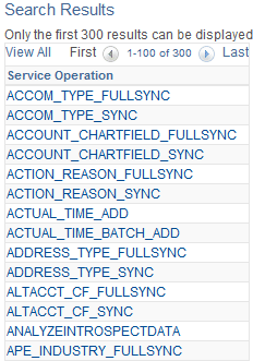

To view outbound messages and service operations, use PeopleTools Integration Broker, Integration Setup.
Note: Messages are associated with service operations, which are delivered Inactive. You must activate the service operations and the associated handlers, routings, and queues.
Queues are delivered in Pause status. You must change these to Run on the Queue Definitions page.
Service Operations

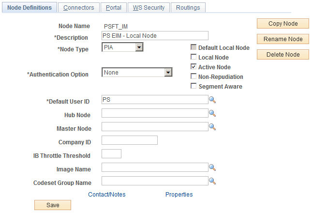

Defining the Local Node
This table provides the specific configuration details for this integration:
Page |
Configuration Specifics |
Node Definitions |
The Node Definition is located in PeopleTools, Integration Broker, Integration Setup, Nodes. Make sure that the Node Type is set to PIA (internal, local) and that you select both Local Node and Active Node. |
Connectors |
Make sure that you set Connector ID to PSFTTARGET because the local node always uses this value for the 8.4x tool set. |
Routings |
Routings are defined in PeopleTools, Integration Broker, Integration Setup, Services Operations, Routings. Alternatively, use PeopleTools, Integration Broker, Integration Setup, Routings to define routings. Refer to the Integration Broker PeopleBook for more details on how to set up the routings. Once the routings are set up properly, make sure to activate them. If using flat file architecture, make sure that TIME_DEVICE_XXXX service operations have both OutAsync and InAsync specified with a Status of Active. Flat files are generated by the local Node for each Flat File TCD Server. The location of output is defined on the TL Installation page and the TL General Settings page. |
Access the Node Definitions page.
This example illustrates the fields and controls on the Node Definitions page. You can find definitions for the fields and controls later on this page.
Access this page from Make sure that the Node Type is set to PIA (internal, local) and that you check both Local Node and Active Node.

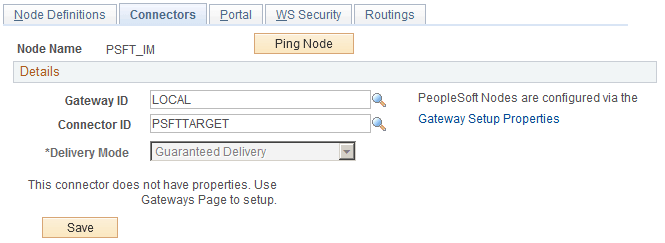

Access the Connectors page.
This example illustrates the fields and controls on the Connectors page. You can find definitions for the fields and controls later on this page.
Make sure that you set Connector ID to PSFTTARGET as the local node always uses this value for the tool set.

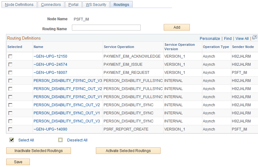

Access the Routings page.
See PeopleTools 8.52: Integration Broker PeopleBook

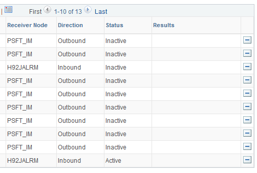

This example illustrates the fields and controls on the Routings page (1 of 2). You can find definitions for the fields and controls later on this page.
This example illustrates the fields and controls on the Routings page (2 of 2). You can find definitions for the fields and controls later on this page.
If using flat file architecture make sure that TIME_DEVICE_XXXX messages have both OutAsync and InAsync specified with a Status of Active. Flat files are generated by the local Node for each Flat File TCD Server. The location of output is defined on the TL Installation Page and the TL General Settings Page.

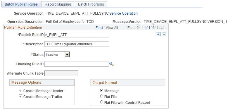

Access the Batch Publish Rules page.
This example illustrates the fields and controls on the Batch Publish Rules search page. You can find definitions for the fields and controls later on this page.
The list that appears are the messages that you can select to configure the messages to be published.
This example illustrates the fields and controls on the Batch Publish Rules page. You can find definitions for the fields and controls later on this page.
Note: If you are using a delivered process, only set those settings that make that process active.
Access this page from The TL_OUTTCD Application engine process uses Batch Publish Rules to publish the messages to TCD Servers. Activate the rules, which you will use for TCD Interface. TL_OUTTCD Application engine also triggers Messages to be published.

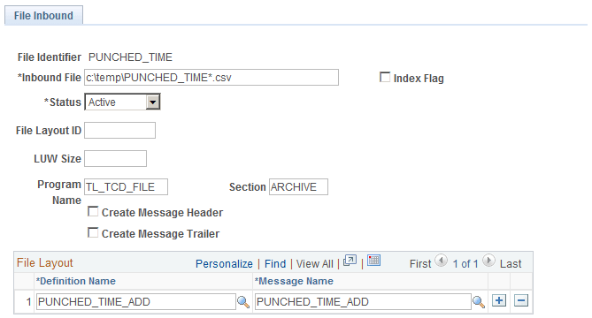

Inbound File Rules
Access the File Inbound page.
This example illustrates the fields and controls on the File Inbound page. You can find definitions for the fields and controls later on this page.
Access this page from Activate inbound file rule if you are using flat file integration. Make sure to set the Inbound File to the appropriate location and set Status to Active.

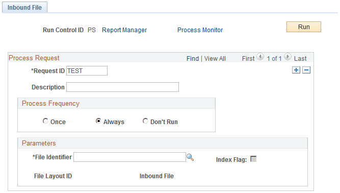

Access the Inbound File (publish) page.
This example illustrates the fields and controls on the Inbound File (publish) page. You can find definitions for the fields and controls later on this page.
Access this page from Make sure the Request ID is defined. And in the Process Frequency group box, select either Once (if you are running the process with Run Control ID only one time, or select Always if you are using same Run Control ID repeatedly.)
