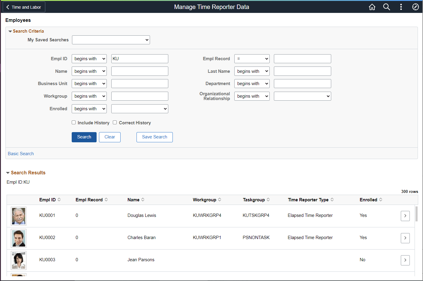

Select Manage Time Reporter Data tile to open Search Criteria Page.
The search Criteria page allows you to search an enrolled employee in Time and Labor.
When you select the Manage Time Reporter tile, the system displays the configurable Manage - Search Criteria page (EOSF_SRCH_FL) to search for job records using fluid.
The page first appears in the Advanced Search mode, where you can use multiple search fields and save your searches, or you can switch to the Basic Search, where you can use the Search By field to retrieve data. Administrators responsible for creating search configurations can modify these options according to the needs of your organization.
For more information on setting up search page configurations, refer Setting Up Search Configuration.
This video provides an overview of the Configurable Search feature:
Video: Image Highlights, PeopleSoft HCM Update Image 36: Configurable Search

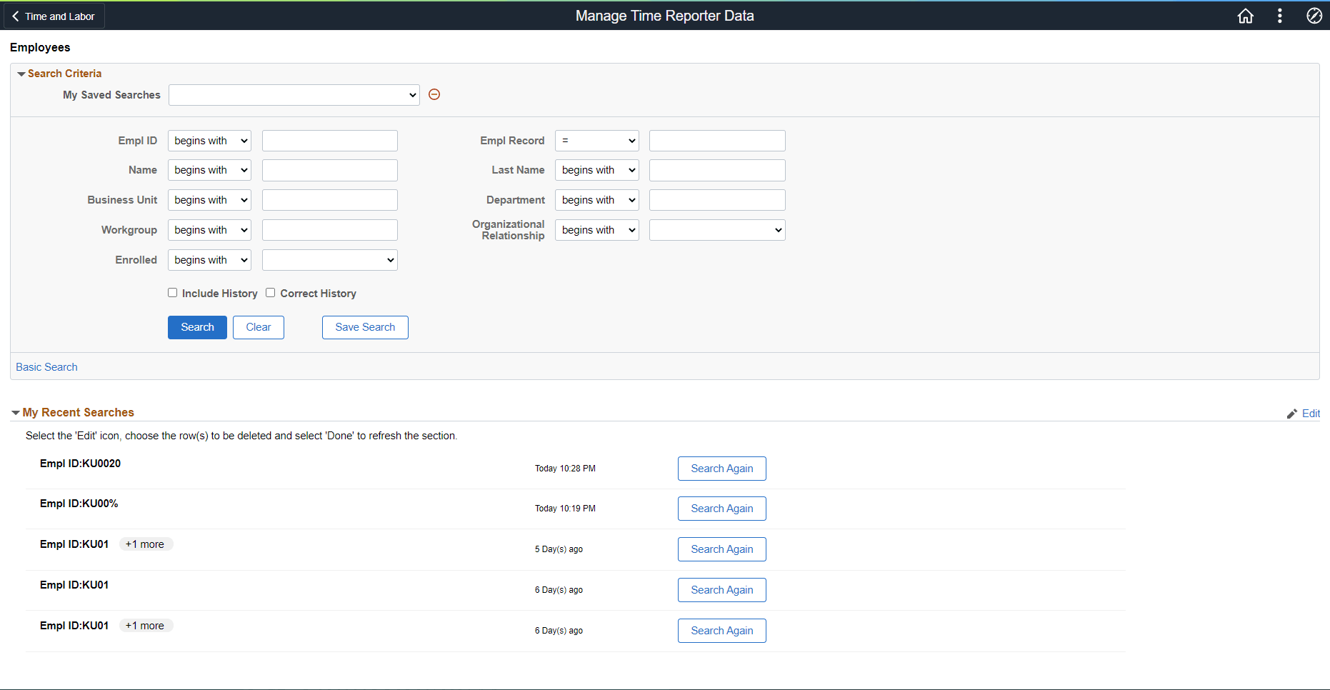

This example illustrates the Search Criteria page and recent searches.
This example illustrates the Manage Job - Search Criteria page showing search results.
Employees Search Result Page
Search Criteria
Field or Control
Description
My Saved Searches
View the results of a search that was saved before from the drop-down.
Empl ID
Employee ID
Empl Record
Employee Record Number
Department
Information about the department of business entity in an organization.
Workgroup
Select a workgroup for the time reporter. Workgroup is a required field. It identifies the default TRC program, rule program, holiday schedule, time reporting period, and other information that the system uses when processing reported time for this person.
If you change the workgroup, and the Assign Workgroup Schedule field is set to Yes on the time reporter's Assign Schedules page, the system deletes any workday overrides for the time reporter that are of a different type than the assigned schedule (that is, elapsed versus punch).
If you change the workgroup when the Default from Workgroup check box is selected on the TL Installation page, the system updates compensatory time plan enrollment when there is a change in a compensatory time plan. The dormant compensatory time plan is inactivated and the new compensatory time plan becomes active as of the effective-dated change of the workgroup on the Maintain Time Reporter Data page.
Organizational Relationship
Organizational relationship include Employee, Contingent Worker and Person of Interest, which can be selected from the drop down.
Enrolled
Time enrolled type Yes or No.
Returns Yes if employees are enrolled in Time and Labor. For others it displays as No. This field assists Administrators in identifying employees based on enrollment.
Include History
Select to retrieve all rows for this person. Although you can view all the rows, you cannot make corrections to historical rows in this mode.
Correct History
Select to retrieve all rows for this person. In this mode, you can make corrections to historical rows.
Note: Update/Display is the default mode that gets applied if Include History or Correct History is not selected. You can add a new top row in this mode but you cannot view historical rows. Availability to access modes are based on your security access and modes may not be available for all users.

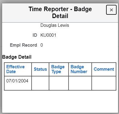

Badge Detail
Click to access the Time Reporter - Badge Detail page and view the badge information for this time reporter. You enter badge information in Workforce Administration as a part of the hiring or data maintenance process for time reporters.
Badge information is important for punch time reporters, who need this information to report time to the TCD.

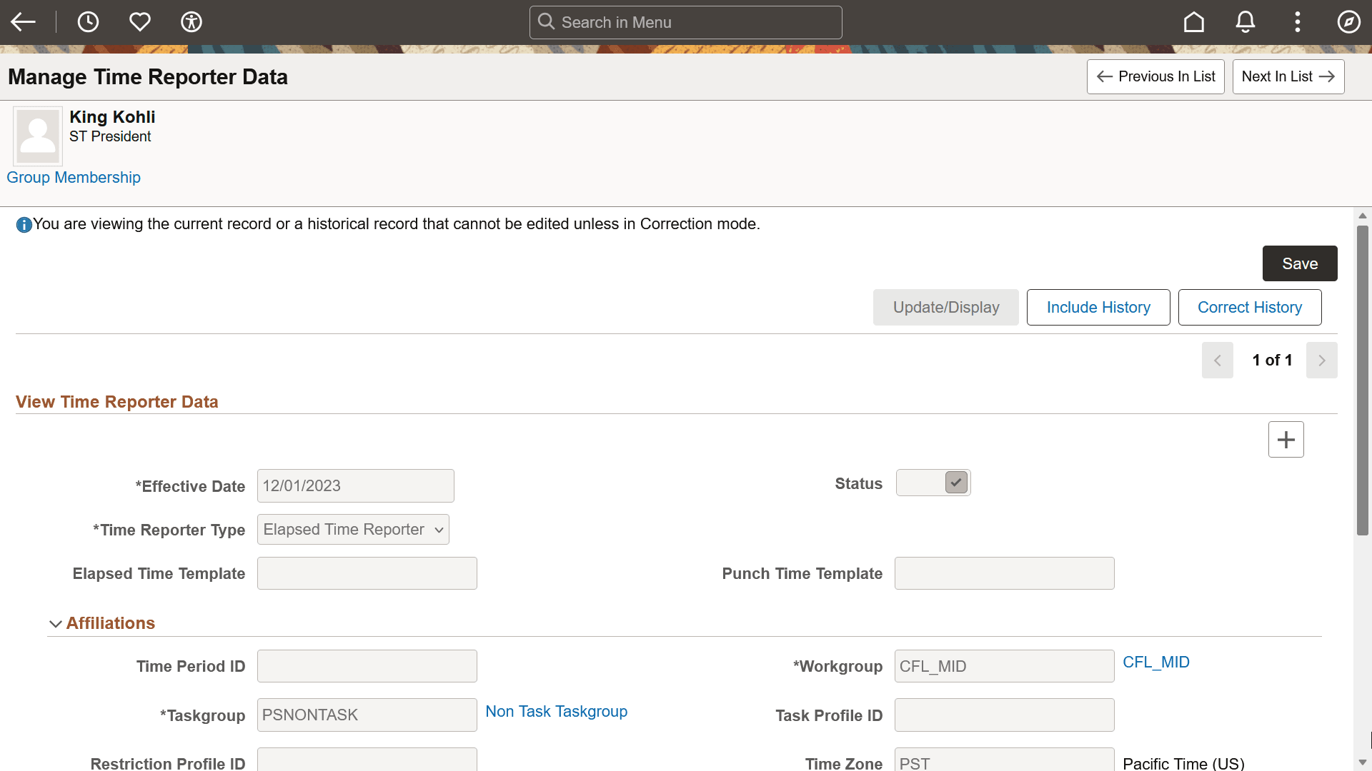

Use the Time Reporter Data page (TL_EMPDATA_M_FL) to update enrollment information for time reporters in Time and Labor.
Navigation:
Select the employee search result with enrollment status Yes to modify the enrollment data.
For employees already enrolled in Time and Labor, selecting the chevron on the search results grid navigates you to the Maintain Time Reporter Data page
This example illustrates the fields and controls on the Manage Time Reporter Data page. You can find definitions for the fields and controls later on this page.
Field or Control
Description
Group Membership
Click to access the Time Reporter Group Membership page, where you can see the list of groups in which the time reporter is currently enrolled.
Most of the elements on the Maintain Time Reporter Data page are identical to those on the Create Time Reporter Data page.

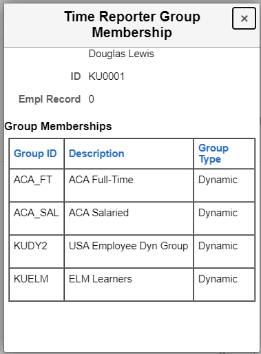

Use the Time Reporter Group Membership page (TL_GRP_MEMBERSHIP) to view the list of groups that the time reporter is assigned to.
Navigation:
Click the Group Membership link on the Maintain Time Reporter Data page.
This example illustrates the fields and controls on the Time Reporter Group Membership page. You can find definitions for the fields and controls later on this page.
Group Membership Modal
Field or Control
Description
Group Type
The group type can be either Dynamic or Static.
Dynamic groups comprise time reporters who met the group selection criteria at the time you last refreshed the dynamic group. Time reporters are automatically added and removed from dynamic groups as their ability to match the selection criteria changes.
Static groups comprise time reporters who met a specific set of criteria at the time the group was established. Time reporters stay assigned to a static group unless you remove them.
Use Time Reporter - Badge Detail modal to view the badge details.
This example illustrates the fields and controls on the Time Reporter - Badge Detail Modal
