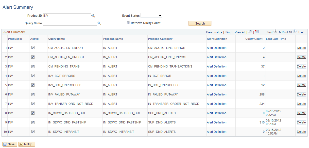

Use the Alert Summary page (EOEN_ALERT_SUMMARY) to review all the alerts at one place and perform basic actions on the alert such as to activate/decativate it or to delete it.
Navigation:
Enterprise Components > Events & Notifications > Alerts > Alert Summary
Alert Summary page displays all alerts in one page
Alert Summary Page
Field or Control
Description
Product ID
Filter the search with a given product ID.
Query Name
Filter the search with a given query name.
Event Status
Filter the search based on Active/Inactive Alerts.
Retrieve Query Count
This option returns the Query count values with the search results. It can take more time for the search results to be processed and displayed if this option is enabled.
Alert Definition
Takes the user to the Alert Definition page.
Query Count
Displays the current outstanding number of transactions for each alert query.
Last Date Time
Displays the timestamp for the last run Alert

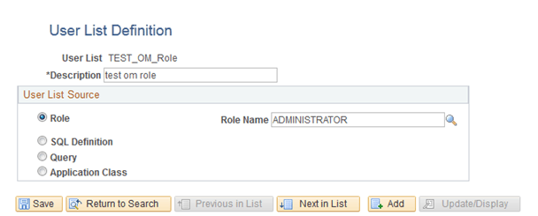

User List Definition based on Role
User List Definition - Role
If the user list is based on a role, then select the type of role from the Role Name field. A role is a list of users who perform the same type of work.

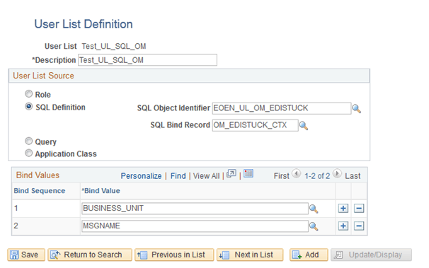

User List Definition based on SQL Definition
User List Definition -SQL Definition
The SQL Definition option allows the user to use an SQL definition as the source for the user list
Note: The SQL must return the OPRID field
Field or Control
Description
SQL Object Identifier
The name of the SQL Object
SQL Bind Record
This is used for setting up the SQL bind field mapping. If the SQL does not have any condition variables, leave this as empty.
Bind Values
These define the Bind value name and sequence for the SQL where clause.

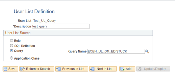

User List Definition based on Query
User List Definition - Query
Select this option to use a query as the source for this user list. When a source is defined as a query, the system determines who should receive the Alert Notification based on the field values

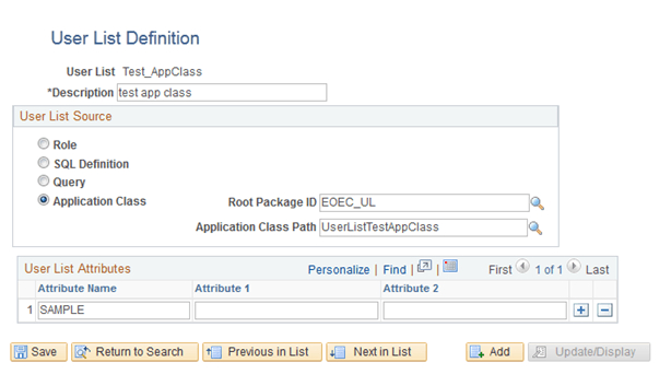

User List Definition based on Application Class
User List Definition - Application Class
Use this option to use an application class as the source for this user list
Field or Control
Description
Root Package ID
The root package name for the application class.
Application Class Path
The application class path.
User List Attributes
Additional attributes values can be saved into the record EOEC_UL_ATTRIB. This allows the user to retrieve these values during runtime.
