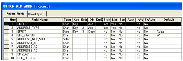

Below is an example of a delivered staging record with its matching production record that uses effective-dating:
This example illustrates the fields and controls on the Production record definition that stores Addresses (HCR_PER_ADDR_I). You can find definitions for the fields and controls later on this page.

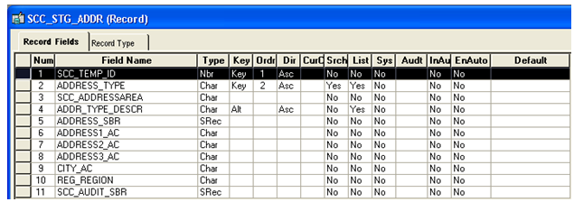

The equivalent staging record definition is defined as follows:
This example illustrates the fields and controls on the Matching Staging record definition that stores Addresses (SCC_STG_ADDR). You can find definitions for the fields and controls later on this page.

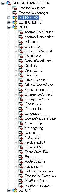

Below is an example of the SCC_SL_TRANSACTION:INTFC application package that comprises application classes used by Constituent Transaction Management:
This example illustrates the fields and controls on the Example of application classes used by CTM. You can find definitions for the fields and controls later on this page.

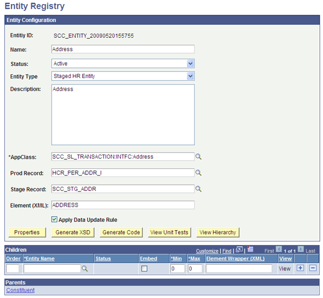

This section discusses how to create an entity for the application class you created in the previous section.
The new entity can be a parent entity or a child of an existing parent. For instance, delivered with your system, the Constituent and the Application entities are parent entities of many children.
Creation considerations:
Name the new entity in relation with the underlying record(s) (that is, the stage and/or the production records you are creating the entity for). For example, the entity name for the address underlying records is Address.
Select a delivered entity type that corresponds to the need of the transactions that use the entity. For example, if you create an entity for a transaction that requires temporarily staging the information to a stage record, make sure you select an entity type that use stage records. If the delivered entity types do not match your needs, create a new one.
Enter the application class name you created in the previous step. The application class you insert here extends the Base Application Class defined in the Entity Type selected. For example, if you create an entity using entity type Staged Entity, the application class you insert extends the base application class SCC_COMMON:ENTITY:StagedEntity. If you used entity type Basic Entity, the application class given inside the entity setup extends the base application class SCC_COMMON:ENTITY:BasicEntity.
Enter the other required information and save. After the first save, the Properties button is displayed. Use the Entity Properties page to add any extra needed properties. Save.
If the entity you created was to be a child of an existing entity (like Address is a child to Constituent entity), you can now access the parent entity and list the newly created entity in the Children grid of the Entity Registry page. If the entity you created was to be a parent, you can then attach children to it.
Warning! At this stage, if you added a child entity, the message schema does not reflect this new entity. However, if the entity is added to an incoming message and no schema validation is occurring, the incoming message containing this data is processed and this entity is handled. As an example, the Address entity is registered as a child entity to the Constituent entity.
This example illustrates the fields and controls on the Example of the entity created for Address. You can find definitions for the fields and controls later on this page.

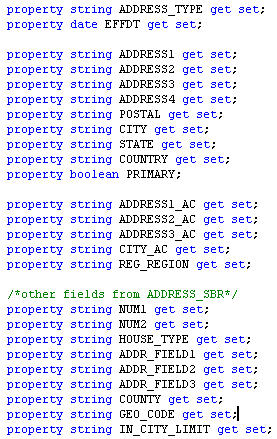

Any new class that you create must declare all its own immutable keys and mutable properties:
This example illustrates the fields and controls on the Examples of properties listed inside the SCC_SL_TRANSACTION:INTFC.Address application class. You can find definitions for the fields and controls later on this page.

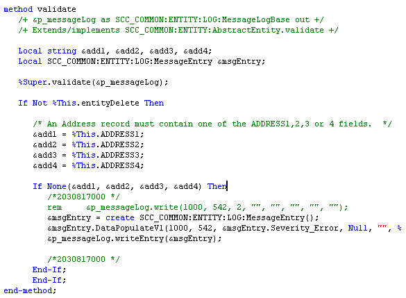

Any new class that you create may choose to override the validate() method in order to validate data prior to saving.
This example illustrates the fields and controls on the Examples of validation done inside the SCC_SL_TRANSACTION:INTFC.Address application class. You can find definitions for the fields and controls later on this page.

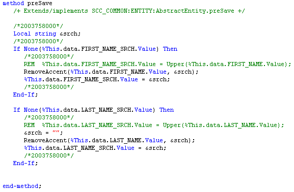

Any new class that you create may choose to override the preSave() method in order to default fields before the user saves the application.
This example illustrates the fields and controls on the Examples of presave logic done inside the SCC_SL_TRANSACTION:INTFC.Names application class. You can find definitions for the fields and controls later on this page.

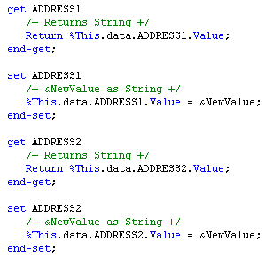

Any new class may declare get/set methods for its properties.
This example illustrates the fields and controls on the Examples of get and set inside the SCC_SL_TRANSACTION:INTFC.Address application class. You can find definitions for the fields and controls later on this page.

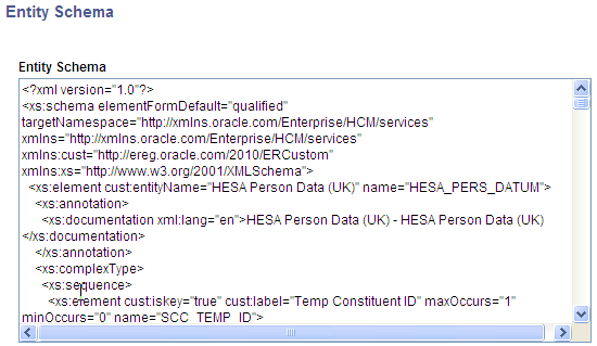

Access the top level entity name referred by the messages in the service operation and select the Generate XSD action (this may not necessarily be the parent entity name. It depends on what entities are referenced by the messages on the service operation).
After selecting the Generate XSD action, the entity schema is displayed:
This example illustrates the fields and controls on the Entity schema generated for the Constituent entity (parent entity). You can find definitions for the fields and controls later on this page.

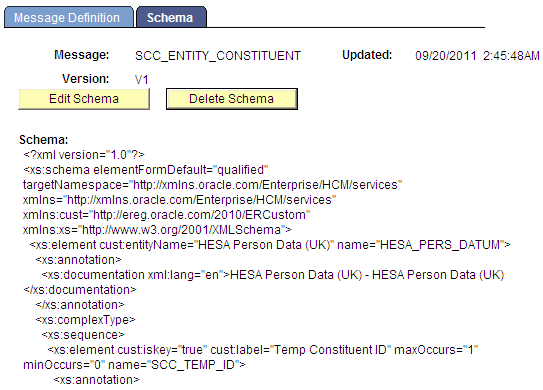

Select the entire generated schema and paste it into the appropriate messages to modify the overall schema.

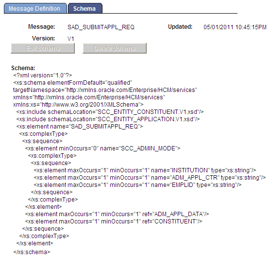

Navigate to Search for the relevant message. In the Schema tab, click the Edit Schema button and paste in the generated schema. Save the component.
For example, suppose you generated the schema for the Constituent entity. Navigate to the message Schema page. Search for the message called SCC_ENTITY_CONSTITUENT. Click the Edit Schema button and paste the generated schema as shown in screen shot below.
This example illustrates the fields and controls on the Constituent message partial schema. You can find definitions for the fields and controls later on this page.

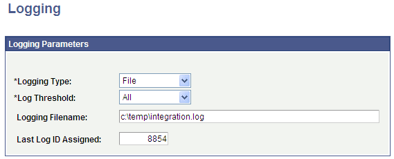

Access the Logging component to enable and configure the logging feature under .
This example illustrates the fields and controls on the Example of how the Logging page can be set up. You can find definitions for the fields and controls later on this page.
Note: You should not enable logging in a production environment. SOA framework logging is only appropriate for a testing, demo or development environment or when performing critical troubleshooting activities.
