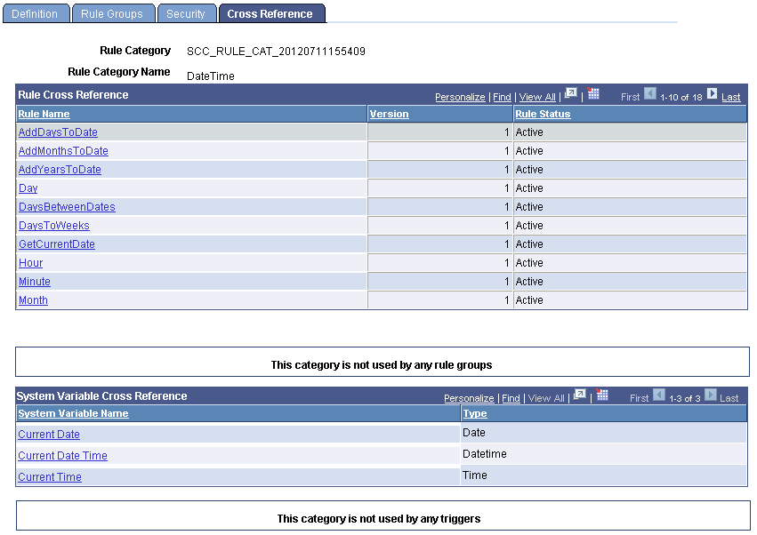

Rule Category Cross Reference |
SCC_RULE_CAT_XREF |
Displays Rules, Rule Groups, System Variables, and Triggers associated with the Rule Category. |

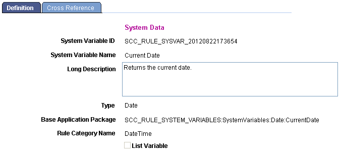

Define System Variables |
SCC_RULE_SYSVAR |
Define System Variables to use when creating Rules. |

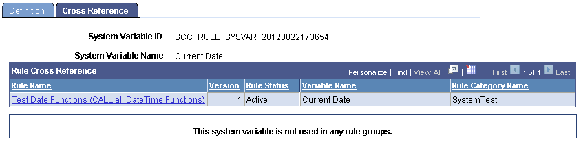

System Variables Cross Reference |
SCC_RULE_SYSV_XREF |
Displays Rules and Rule Groups associated with the System Variable. |

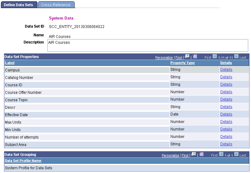

Define Data Sets |
SCC_RULE_EDS |
Define Data Sets to use as a temporary storage when creating Rules. |

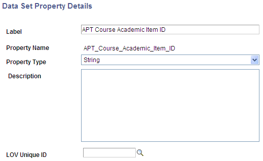

Data Set Property Details |
SCC_EDS_PROP_DTLS |
Click the Details link on the Define Data Sets page. |
Define Data Set property details. |

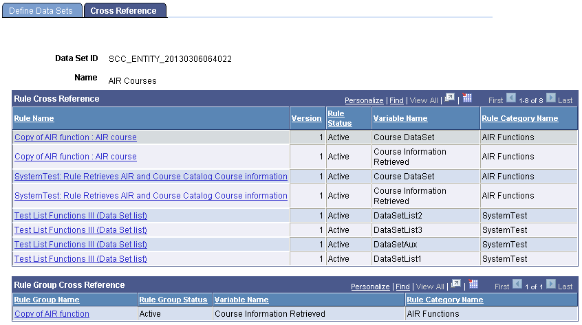

Data Set Cross Reference |
SCC_RULE_EDS_XREF |
Displays Rule and Rule Groups associated with the Data Set. |

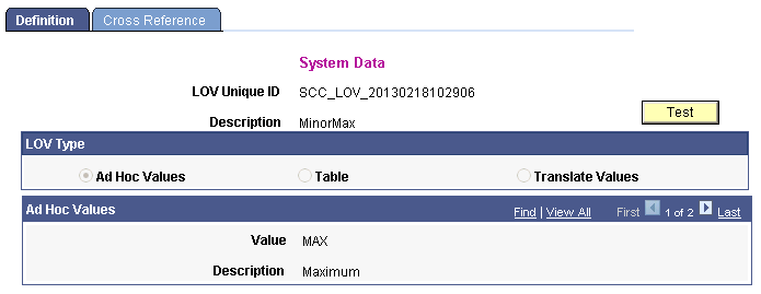

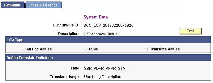

Define List of Values |
SCC_RULE_LOV_DEFN |
Define lists of values to use for property prompting when creating Rules. |

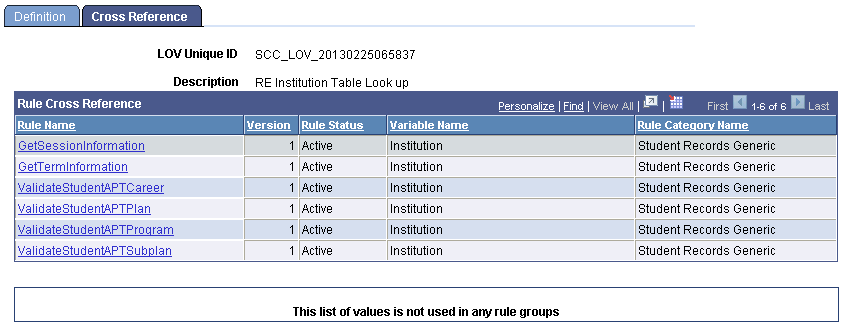

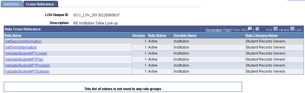

List of Values Cross Reference |
SCC_RULE_LOV_XREF |
Displays Rule and Rule Groups associated with the List of Values. |

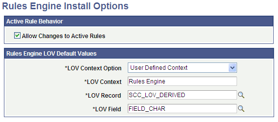

Access the Rules Engine Install Options page ().
This example illustrates the fields and controls on the Rules Engine Install Options page. You can find definitions for the fields and controls later on this page.
Field or Control |
Description |
Allow Changes to Active Rules |
Select this check box to allow changes to active Rules or Functions. You can use this flag to override the feature that makes Rules features inaccessible when Rules or Functions are active. This option can be useful in non-production environments in cases where it should be possible to change active Rules. The check box is not selected by default. When Allow Changes to Active Rules is not selected only the following can be changed or accessed by the user when accessing the Rules Engine Manager Component:
When Allow Changes to Active Rules is not selected, the following Action Drop down options are not available:
When Allow Changes to Active Rules is not selected, Rule Groups that are selected to be Available In Dynamic Rules cannot be altered. |

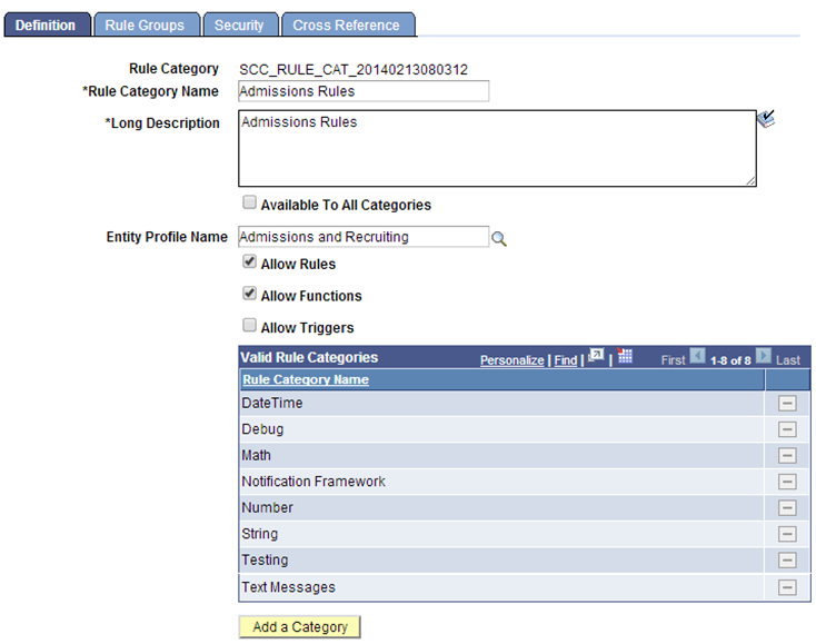

Access the Rule Category Definition page ().
This example illustrates the fields and controls on the Rule Category Definition page. You can find definitions for the fields and controls later on this page.
Using this category as an example, you cannot create Functions or Rules in category Math, but you can create Functions and Rules in category AIR Functions and CALL Functions in category Math.
Field or Control |
Description |
Rule Category |
Displays a unique ID generated by the system. When adding a new Rule Category, the default value is NOID. After saving the Rule Category, a unique ID is generated by the system and assigned to the Rule Category. The ID is created by combining prefix “SCC_RULE_CAT_” with the system date and time stamp in format YYYYMMDDHHMMSS. |
Rule Category Name |
Enter a Rule Category Name. The Rule Category Name is used when searching for a Rule Category and for display. |
Long Description |
Enter descriptive text explaining the function of the Rule Category. |
Available to All Categories |
Select this check box to make this Category automatically available as a valid Category in other Categories. Categories that are defined as “Available to all Categories” cannot have any Valid Categories of its own. When this check box is deselected, the Category is no longer available in other Categories. Note: Security settings on the Rule Category affect all Rules, Functions and Triggers which have been called from or created in this Category. In the example below the Category Math has been made available to Category “Admissions Rules” as a Valid Rule Category. Every Function and Rule Created in Category Math can now be called from a Function or Rule created in Category “Admissions Rules”. Note: Deselecting “Available to All Categories” on category Math would remove the Category from Admissions Rules and invalidate the security on the Call statement of rules which have already been created. Although this would not break compiled Rules it would cause problems when users want to change those rules. |
Entity Profile Name |
Enter the Entity Profile Name that you want to associate to this Rule Category. Rules, Functions and Triggers can be built using the Base Entities which have been setup in this Entity Profile. If the Entity Profiles uses Views, access to certain properties within an Entity may have been restricted. |
Allow Rules |
Select this check box to allow the creation of Rules with this Rule Category. |
Allow Functions |
Select this check box to allow the creation of Functions with this Rule Category. |
Allow Triggers |
Select this check box to allow the creation of Triggers with this Rule Category. |
Valid Rule Categories |
Select Rule Categories available to this Rule Category. The Rules, Functions, and Triggers of the selected categories can be called by Rules created in the main Category. Note: This is not an inheritance model. Adding a valid Rule Category here gives you access to the Rules, Functions, and Triggers native to that Rule Category but not to Rules, Functions, and Triggers of any Rule Categories associated with the selected Rule Category. |

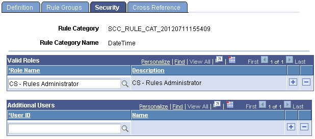

Access the Rule Category Security page ().
This example illustrates the fields and controls on the Rule Category Security page. You can find definitions for the fields and controls later on this page.
Field or Control |
Description |
Valid Roles |
Enter Valid Roles for which the Rules Category definition is valid. These are Roles that are set up using the standard PeopleTools Security function. |
Additional Users |
Enter additional users for which the Category Definition is valid. The registration of Additional Users is supplemental to the Valid Roles. |

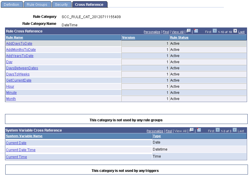

Access the Rule Category Cross Reference page ().
This example illustrates the fields and controls on the Rule Category Cross Reference page. You can find definitions for the fields and controls later on this page.
This page shows Rules, Rule Groups, System Variables, and Triggers which have been created as part of this Category.
Field or Control |
Description |
Rule Name, Rule Group Name, System Variable Name, and Trigger Name |
Displays to authorized users a link for any of these Rules Engine objects that have been created in this Rule Category. If a user is not authorized, the link is disabled. Click a link to transfer out of the component and to the referenced object. Warning! Make sure you have saved any data that you need to before confirming you want to transfer to the referenced object in a new component. If no objects are associated with the Rule Category, a notification is shown in place of the object details. for example, “This Category is not used by any triggers”. |
Version |
Displays the Rule Version Number. |
Rule Status and Rule Group Status |
Displays the status of the Rule Group or Rule Name (In Progress, Active, In-active). |
Type |
Displays the Type of System Variable. |

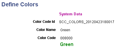

Access the Define Colors page ().
This example illustrates the fields and controls on the Define Colors page. You can find definitions for the fields and controls later on this page.
Although Oracle recommends using the pre-delivered color range, you can add new colors to the system for the Rules Engine Manager user interface elements. New colors can be added simply by adding a new entry, specifying a Color Name and a Color Code which conforms to the HTML color code standard.
Field or Control |
Description |
Color Code ID |
Displays a unique ID generated by the system. When adding a new value the default value is NOID. The unique ID is generated when the Color Code is saved. The Color Code ID is created by combining prefix SCC_COLORS_ with the system date and time stamp in format YYYYMMDDHHMMSS. |
Color Name |
Enter the name of the color; for example, Sky Blue. |
Color Code |
Enter an HTML standard color code. New color codes can be defined using HTML standards.

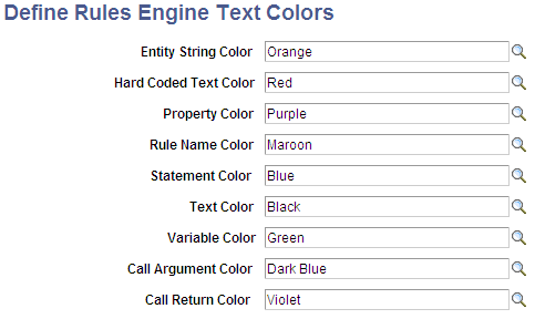

Access the Define Rules Engine Text Colors page ().
This example illustrates the fields and controls on the Define Rules Engine Text Colors page. You can find definitions for the fields and controls later on this page.
Use this page to assign colors to Rules Engine Manager elements. The following elements can be color coded:
Entity String
Hard Coded Text
Property
Rule Name
Statement
Text
Variable
Call Argument
Call Return

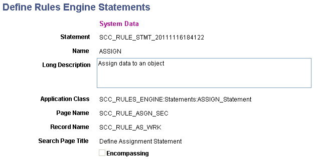

Rules Engine Statements help you create business rules in the Rules Engine Manager to perform specific processing Functions like assigning values to variables or creating Evaluative Statements. An extensive set of Statements is delivered with the system to facilitate the creation of a comprehensive set of Rules. The processing functionality for each statement is defined in Application Class PeopleCode and associated with a Rules Engine Manager secondary page through a predefined work record. This secondary page is used to display fields and logic associated with the Statement.
For more information, see Using Statements for Evaluation and Calculation in a Rule.
Note: For Statements delivered with the system, only the Long Description can be modified.
Note: Oracle may deliver additional Statements in the future. You are advised not to create your own Statements at this time.
Access the Define Rules Engine Statements ().
This example illustrates the fields and controls on the Define Rules Engine Statements page. You can find definitions for the fields and controls later on this page.
Field or Control |
Description |
Statement |
Displays a unique system-generated Rules Engine Statement identifier. When adding a new value the default value is NOID. The unique ID is generated when the Rules Engine Statement is saved. The Rules Engine Statement ID is created by combining prefix SCC_RULE_STMT_ with the system date and time stamp in format YYYYMMDDHHMMSS. |
Name |
Enter a Statement Name. The Statement Name is used when searching for a Statement and for display. |
Long Description |
Enter descriptive text explaining the function of the Statement. |
Application Class |
Enter the Application Class for this Rules Engine Statement. Logic for system–delivered Statement functionality uses the SCC_RULES_ENGINE:Statements Application Class. Warning! To ensure that delivered functionality works as intended, do not change delivered Application Classes. |
Page Name |
Enter the Page Name for this Rules Engine Statement. Each Statement references a secondary page specifically created for this Statement. The secondary page is used to display Statement functionality to the end user. The Statement secondary pages are pre–delivered and are designed to render Statement logic in a specific way. Warning! To ensure that delivered functionality works as intended, do not change the Page Name for the Statement. |
Record Name |
Enter the Record Name for this Rules Engine Statement. Each Statement has a unique work record reference. The associated work record is used to technically facilitate the information shown on the secondary pages. The Statement work records are pre–delivered and have been designed to render Statement logic in a specific way. Warning! To ensure that delivered functionality works as intended, do not change the Record Name for the Statement. |
Search Page Title |
Enter the Page Title for the Rules Engine Statement. The Page Title is displayed at the top of the Statement grid once the Statement has been selected for use in the Rule. |
Encompassing |
Select to indicate whether the Statement created is an encompassing statement. An Encompassing Statement is one which can enclose one or more other Statements in the Rule. The following delivered statements are encompassing:
For more information, see Using Statements for Evaluation and Calculation in a Rule. |

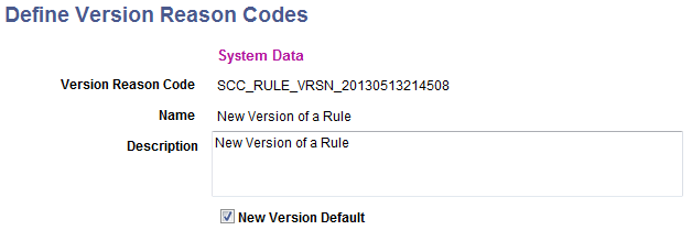

New versions of Rules can be created for each Rule, Trigger or Function. Rule Versions are managed on the Rules Engine Manager Rule Version Page. New versions of Rules can be created for reasons like needing to incorporate new Rule logic or correcting Rule mistakes. To facilitate Rule maintenance, use Rule Version reason codes to indicate why a new version was created. Define Rule Version Codes on the Rules Version Reason Code setup page.
Note: For Version Reason Codes delivered with the system, only the Description can be modified.
Note: The system-delivered Version Reason Code of New Version of the rule is used automatically whenever a new version of a rule is created. This Version Reason Code is delivered with the Initial Version Default check box selected. If the Initial Version Default check box is not selected, the Version Reason Code of New Version of the rule can be selected to be both the Initial Version Reason Code as well as the New Version Reason Code.
Access the Define Version Reason Codes page ().
This example illustrates the fields and controls on the Define Version Reason Codes page. You can find definitions for the fields and controls later on this page.
Field or Control |
Description |
Version Reason Code |
Displays a unique ID generated by the system. When adding a new value the default value is NOID. The unique ID is generated when Version Reason Code is saved. The ID is created by combining prefix SCC_RULE_VRSN_ with the system date and time stamp in format YYYYMMDDHHMMSS. |
Name |
Enter a Version Reason Name. The Version Reason Name is used when searching for a Version Reason and for display. |
Description |
Enter descriptive text explaining the function of the Version Reason Code.. |
Initial Version Default |
Select this check box to use this Version Reason code automatically when the rule is created. Comments can be added to the Version Reason code before the Version page is saved. The system-delivered Version Reason Code Initial Version of the Rule is delivered with this check box selected. |
New Version Default |
Select this check box to use this Version Reason Code automatically whenever a new version of a rule is created. The system-delivered Version Reason Code New Version of the rule is delivered with this check box selected. If the Initial Version Default check box for the system-delivered Version Reason Code Initial Version of the Rule is not selected and the system-delivered Version Reason Code New Version of the rule is selected, the New Version Default reason is used for both. |

Access the Define System Variables page ().
This example illustrates the fields and controls on the Define System Variables page. You can find definitions for the fields and controls later on this page.

Access the Define System Variables Cross Reference page ().
This example illustrates the fields and controls on the Define System Variables Cross Reference page. You can find definitions for the fields and controls later on this page.
This page shows Rules and Rule Groups associated with this System Variable.
Field or Control |
Description |
Rule Name and Rule Group Name |
Displays to authorized users a link for any of these Rules Engine objects which use this System Variable. If a user is not authorized, the link is disabled. Click a link to transfer out of the component and to the referenced object. Warning! Make sure you have saved any data that you need to before confirming you want to transfer to the referenced object in a new component. If no objects use the System Variable, a notification is shown in place of the object details. for example, “This System Variable is not used by any Rule Groups”. |
Version |
Variable Name |
Displays the name of the Variable associated with the System Variable. |
Displays the Rule Category Name in which the Rule or Rule Group has been created. |

Access the Define Data Sets page ().
This example illustrates the fields and controls on the Define Data Sets page. You can find definitions for the fields and controls later on this page.
Field or Control |
Description |
Data Set ID |
Displays a unique ID generated by the system. When adding a new value the default value is NOID. The unique ID is generated when the Data Set is saved. The Statement ID is created by combining prefix SCC_ENTITY_ with the system date and time stamp in format YYYYMMDDHHMMSS. |
Name |
Enter a Data Set Name. The Data Set Name is used when searching for a Data Set and for display. |
Actions |
Description |
Enter descriptive text explaining the function of the Data Set.. |
Label |
Enter a Label for each of your Data Set properties. This Label is used in the Rules Engine Manager to display the Data Set Property. |
Property Type |
Select the Property Type:
Details |
Click on the Details link to access more information about each Data Set Property. |
Access the Data Sets Details page (click the Details link on the Define Data Sets page).
This example illustrates the fields and controls on the Data Set Property Details page. You can find definitions for the fields and controls later on this page.
The Data Set Property details page allows you to add a long Description for a Property and List of Values (LOV) which can be used to enforce Prompt Edits.
For more information, see Defining Lists of Values for Rules Engine Variables.

Access the Define Data Sets Cross Reference page ().
This example illustrates the fields and controls on the Define Data Sets Cross Reference page. You can find definitions for the fields and controls later on this page.
Field or Control |
Description |
Displays to authorized users a link for either of these Rules Engine objects which use this Data Set. If a user is not authorized, the link is disabled. Click a link to transfer out of the component and to the referenced object. Warning! Make sure you have saved any data that you need to before confirming you want to transfer to the referenced object in a new component. If no objects use the Data Set, a notification is shown in place of the object details. for example, “This Data Set is not used by any Rule Groups”. |
Version |
Variable Name |

Defining Lists of Values – Ad Hoc Values
Access the Define List Of Values page ().
This example illustrates the fields and controls on the Define List of Values – Ad Hoc Values page. You can find definitions for the fields and controls later on this page.
Select LOV Type Ad Hoc Values if you want to prompt on a user-defined Value or List of Values that is not related to a translate table or an existing prompt table.
Field or Control |
Description |
LOV Unique ID |
Displays a unique ID generated by the system. When adding a new value the default value is NOID. The unique ID is generated when the LOV is saved. The UID is created by combining prefix SCC_LOV_ with the system date and time stamp in format YYYYMMDDHHMMSS. |
Description |
Enter a LOV Description. The LOV Description is used when searching for a LOV and for display. |
LOV Type – Ad Hoc Values selected |
Create an LOV of Ad Hoc Values if you want to prompt on a user-defined value or List of Values that is not related to a translate table or an existing prompt table. |
LOV Unique ID – Copy Ad Hoc Values From grid |
Select an LOV to copy by using the Search icon to find an existing LOV Unique ID. Then add custom values in the Ad Hoc Values grid. |
Value – Copy Ad Hoc Values grid |
Enter an Ad Hoc Value from which you would like to copy existing Ad Hoc values. |
Description – Copy Ad Hoc Values grid |
Enter a Description for the Ad Hoc Value. |
Test |
Click the Test button to display a preview of the values that will be returned by the LOV when it is deployed as a prompt edit. |

Defining Lists of Values – Translate Values
Access the Define List Of Values page ( and select the Translate Values radio button.
Create an LOV of type Translate Values if you want to prompt on an existing Campus Solutions Translate Value.
This example illustrates the fields and controls on the Define List of Values – Translate Values. You can find definitions for the fields and controls later on this page.
Select an LOV Type of Translate Values if you want to prompt on an existing Campus Solutions Translate Values.

Access the Define List of Values Cross Reference page ().
This example illustrates the fields and controls on the Define List of Values Cross Reference. You can find definitions for the fields and controls later on this page.
Field or Control |
Description |
Displays to authorized users a link for either of these Rules Engine objects which uses a variable with this List of Values. If a user is not authorized, the link is disabled. Click a link to transfer out of the component and to the referenced object. Warning! Make sure you have saved any data that you need to before confirming you want to transfer to the referenced object in a new component. If no objects use the List of Values, a notification is shown in place of the object details. for example, “This List of Values is not used by any Rule Groups”. |
Version |
Variable Name |
Displays the name of the Variable that uses this List of Values. |

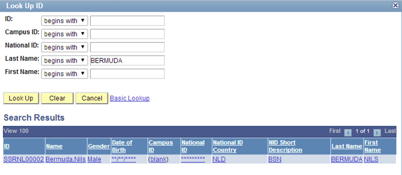

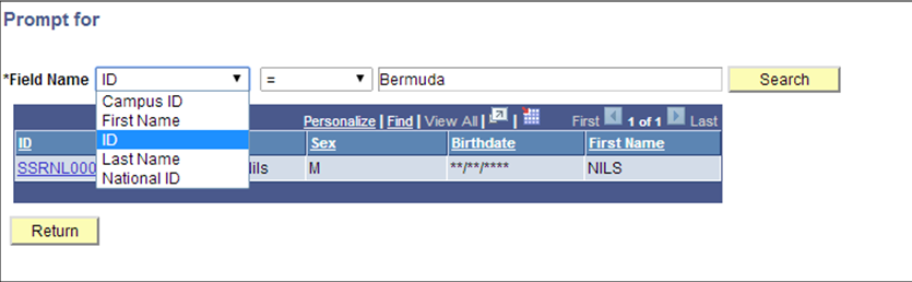

This example illustrates the Prompt Window for Example Of Define Rule Page Using A LOV From Field Record Prompts.
The Search function behaves the same as if prompted from a normal search record or component:
This example illustrates Prompt Options from Component Search Record (Student Admissions, Application Maintenance, Maintain Applications).

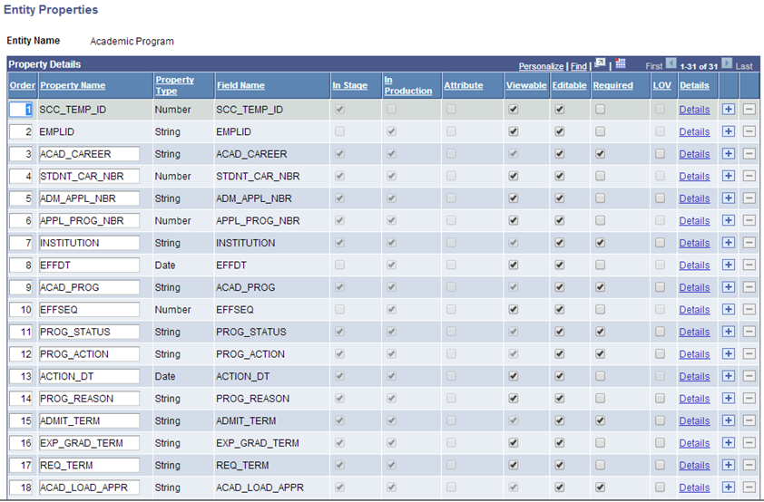

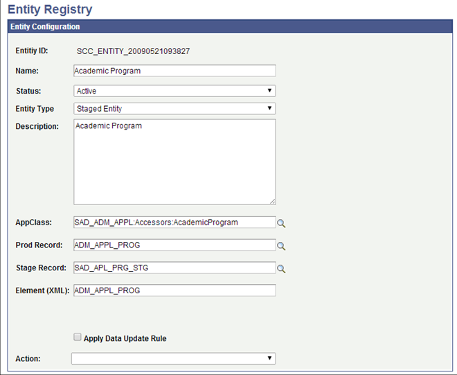

The Lookup functionality for EmplID Property is enabled by the Entity Registry. To view the Entity Prompts, access the Entity Registry page ().
This example illustrates the Entity Registry Window for Example of Define Rule Page Using a LOV from Field Record Prompts
Select Edit Properties from the Action drop-down to view the Entity properties:
This example illustrates Entity Properties Window for Example Of Define Rule Page Using a LOV from Field Record Prompts.

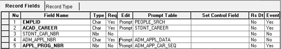

Prompt values present in a production record or staging record of an Entity are added to the Entity Registry automatically. Any Property which has inherited a Prompt from a production or staging record is displayed as view-only in the LOV column of the Entity Properties page. In this example the field EMPLID has inherited a prompt to the PEOPLE_SRCH table from the ADM_APPL_PROG production record:
This illustrates the Property and Prompt Table for Example of Define Rule Page Using a LOV from Field Record Prompts

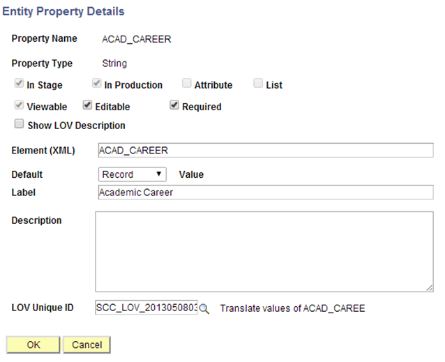

For an example of a LOV Look Up Table that is NOT present on the production or staging record and has been added to an Entity Property, select the Details link for property ACAD_CAREER in the Entity Properties page example. This opens the Entity Properties Detail page where an LOV Lookup Table can be added using the LOV Unique ID field for a relevant LOV:
This illustrates the Entity Property Details Window for Example of Define Rule Page Using a LOV from Field Record Prompts.
