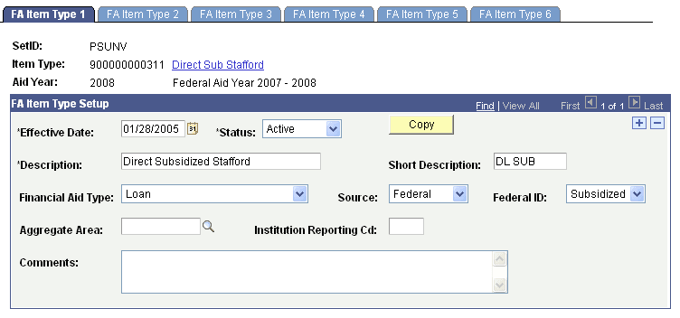

Access the FA Item Type 1 page ().
This example illustrates the fields and controls on the FA Item Type 1 page.
This table describes how to enter field information for each type of direct lending loan.
| Field | Subsidized Stafford | Unsubsidized Stafford | PLUS | Graduate PLUS |
| Description | Enter a descriptive statement indicating a Direct Subsidized Stafford loan. | Enter a descriptive statement indicating a Direct Unsubsidized Stafford loan. | Enter a descriptive statement indicating a PLUS loan. | Enter a descriptive statement indicating a Graduate PLUS loan. |
| Financial Aid Type | Loan | Loan | Loan | Loan |
| Source | Federal | Federal | Federal | Federal |
| Federal ID | Subsidized | Unsubsidized | PLUS | Grad PLUS |
| Aggregate Area | Name of the aggregate area you set up for this type of loan. | Name of the aggregate area you set up for this type of loan. | Leave this field blank. | Leave this field blank. |

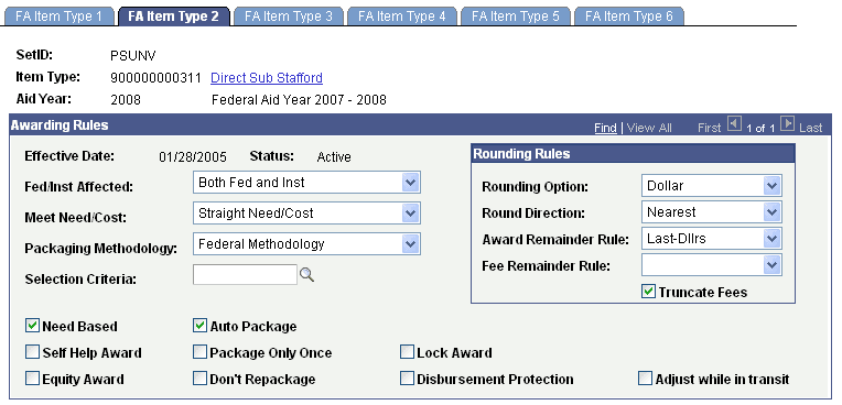

Access the FA Item Type 2 page ().
This example illustrates the fields and controls on the FA Item Type 2 page. You can find definitions for the fields and controls later on this page.
The Rounding Rules entered on this page are the same for all Direct Loan types.
| Field or Control | Description |
| Rounding Option | Select Dollar. |
| Round Direction | Select Nearest. |
| Award Remainder Rule | Select Last-Dllrs (last dollars). |
| Fee Remainder Rule | Leave this field blank. |
| Truncate Fees | Select this check box. |

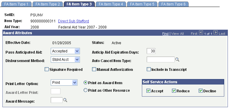

Access the FA Item Type 3 page ().
This example illustrates the fields and controls on the FA Item Type 3 page.
The fields on this page are used to set up disbursement information. Set up these fields according to your institution's requirements. No specific Direct Loan requirements exist.

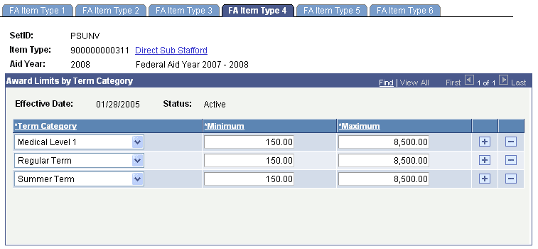

Access the FA Item Type 4 page ().
This example illustrates the fields and controls on the FA Item Type 4 page.
The fields on this page are used to set up your award limits by term category. Your institution defines the limits. No specific Direct Loan requirements exist.

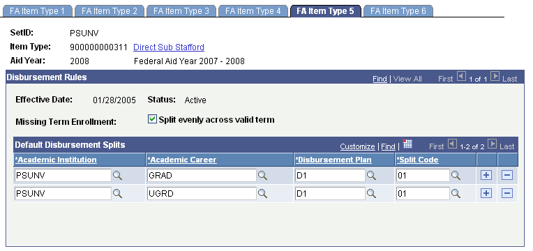

Access the FA Item Type 5 page ().
This example illustrates the fields and controls on the FA Item Type 5 page. You can find definitions for the fields and controls later on this page.
The field values entered on this page are the same for all Direct Loan types.
| Missing Term Enrollment | Select the Split evenly across valid term check box for Direct Loan setup. Disbursement plans determine the disbursements across terms, but students might not attend all terms defined for the disbursement plan. The Missing Term Enrollment rule allows you to specify whether to split disbursements evenly among the remaining terms for which the student is actually enrolled. For example, if the disbursement plan is for fall, winter, and spring quarters, but the student is only enrolled for fall and spring with the Split evenly across valid term check box selected, the award amount is split evenly between the fall and spring terms. |
