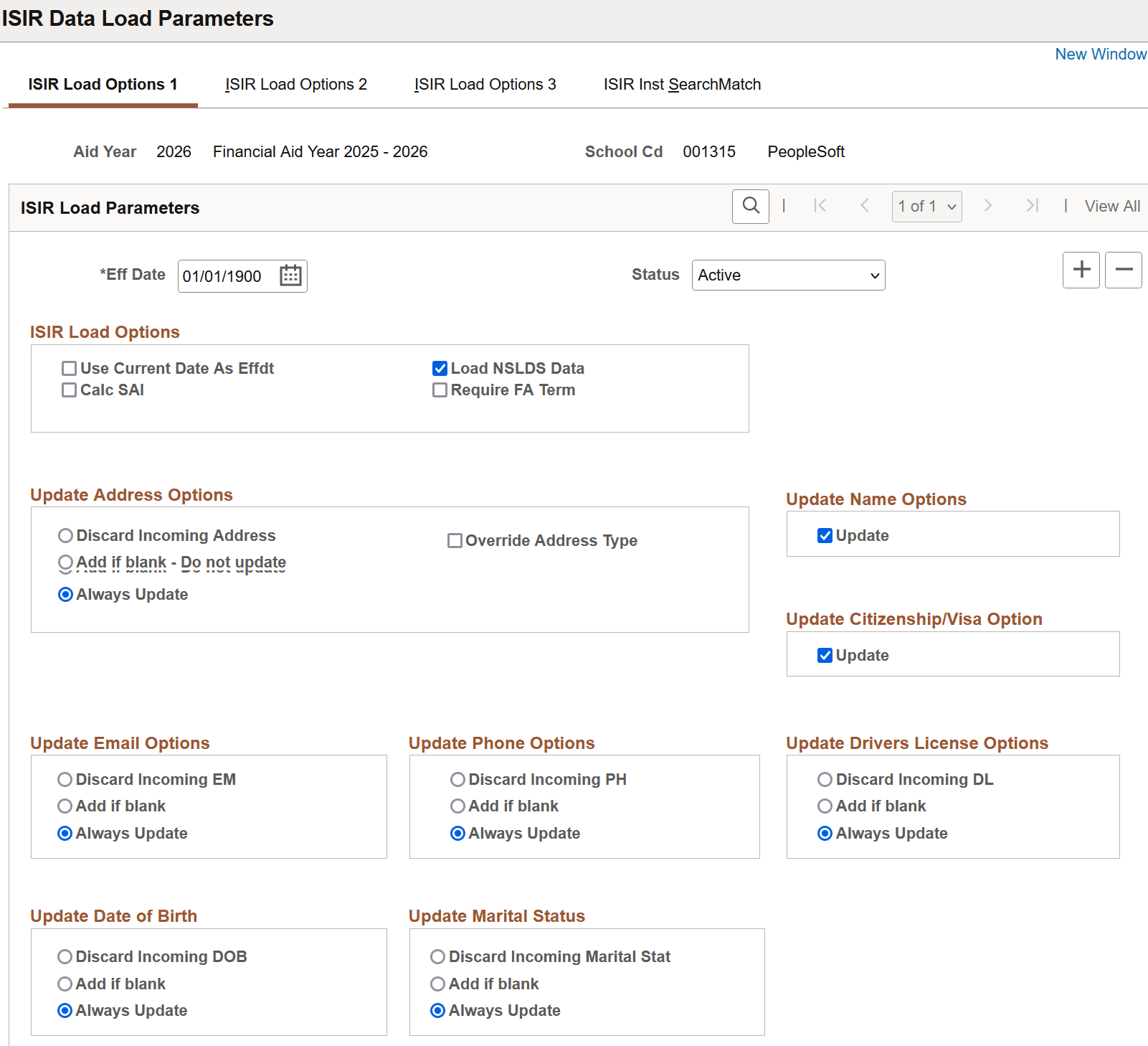

Access the ISIR Load Options 1 page ().
This example illustrates the fields and controls on the ISIR Load Options 1 page. You can find definitions for the fields and controls later on this page.
These load parameters are for processing all initial ISIR records and system-generated ISIRs.
The system displays the aid year, school code, effective date, and status.
ISIR Load Options
Field or Control |
Description |
Use Current Date as Effdt (use current date as effective date) |
Select to use the current date as the effective date of the ISIR information loaded into the ISIR Data Corrections component. If you do not select the check box, the system uses an effective date based on the CPS/FPS transaction processed date. |
Call INAS/SAI (call Institutional Need Analysis System/Student Aid Index calculator) |
Select to enable any ISIR that is loaded to immediately run the FM NAC program using the current Federal options. If you do not select this check box, the ISIR is queued for Mass EFC processing. |
Load NSLDS Data (load National Student Loan Data System data) |
Select this check box to direct the system to load new NSLDS data into the NSLDS tables when an ISIR is suspended or discarded—that is, skipped—and not loaded into the system. NSLDS data is loaded for suspended ISIRs under these conditions:
Require FA Term |
Select to require that at least one active FA Term record for the corresponding Aid Year exists in order for the record to be considered for addition to the ISIR Application tables. |
Note: The option to use the CPS/FPS transaction processed date as the effective date for the loaded data is available only for initial ISIR records loaded for the aid year. When all corrected ISIRs are loaded, the system uses the current date as the effective date.
Update Address Options
Field or Control |
Description |
Discard Incoming Address |
Select to prevent a student's address information from being updated in personal data when an ISIR is loaded. |
Add if blank - Do not update |
Select if, when the ISIR is loaded, the student has no active address in personal data that matches the address usage criteria. |
Always Update |
Select to always update the appropriate address when the ISIR is loaded. |
Override Address Type |
Select to force the ISIR address to be loaded into a specific address type rather than use the ISIR address usage parameters set in the Process Demo Setup page. |
Update Name Options
Field or Control |
Description |
Update |
Select if, when the ISIR is loaded, the student has no active name in personal data that matches name usage criteria, to update the data with the ISIR name. |
Update Citizenship/Visa
Field or Control |
Description |
Update |
Select to update these bio/demo fields when the ISIR is loaded:
Update Email Options
Field or Control |
Description |
Discard |
Select to prevent a student's email information from being updated in personal data when the system loads an ISIR. |
Add if blank |
Select if the student does not have an active email address in personal data that matches the defined usage criteria when the system loads an ISIR. The system creates an email address using the highest ranked email type defined in the usage criteria. If an existing matching address type exists, an update does not occur. |
Always Update |
Select to always update the appropriate email address when the system loads an ISIR. The system updates the highest ranked address and phone type defined in the usage criteria. |
Update Phone Options
Field or Control |
Description |
Discard |
Select to prevent a student's phone information from being updated in personal data when the system loads an ISIR. |
Add if blank |
Select if the student does not have an active phone number in personal data that matches the defined usage criteria when the system loads an ISIR. The system creates a phone number using the highest ranked phone type defined in the usage criteria. If an existing matching phone type exists, an update does not occur. |
Always Update |
Select to always update the appropriate phone number when the system loads an ISIR. The system updates the highest ranked phone type defined in the usage criteria. |
Update Drivers License Options
Field or Control |
Description |
Discard |
Select to prevent a student's driver's license information from being updated in personal data when the ISIR is loaded. |
Add if blank |
Select to enable the following to occur:
Always Update |
Select to always update the driver's license fields when the ISIR is loaded. The system checks for an exact match of the driver's license number and driver's license state. If the system cannot locate an exact match, it deletes any entries for the student in the driver's license table where either the state or the license number match, and then inserts a new row with the driver's license number and state from the ISIR. |
Update Date of Birth
Field or Control |
Description |
Discard |
Select to prevent a student's date of birth information from being updated in personal data when the system loads an ISIR. |
Add if blank |
Select if the student doesn't have date of birth in personal data when the system loads an ISIR. The system adds the date of birth as provided on the ISIR record. If a date of birth exists in the CS personal data record, an update doesn't occur. |
Always Update |
Select to always update the student’s date of birth when the system loads an ISIR. |
Update Marital Status
Field or Control |
Description |
Discard |
Select to prevent a student's marital status information from being updated in personal data when the system loads an ISIR. |
Add if blank |
Select if the student does not have any marital status indicated in personal data when the system loads an ISIR. The system adds the marital status as provided on the ISIR record. If any marital status for the student is present in the CS personal data record, an update does not occur. |
Always Update |
Select to always update the student’s marital status when the system loads an ISIR. |

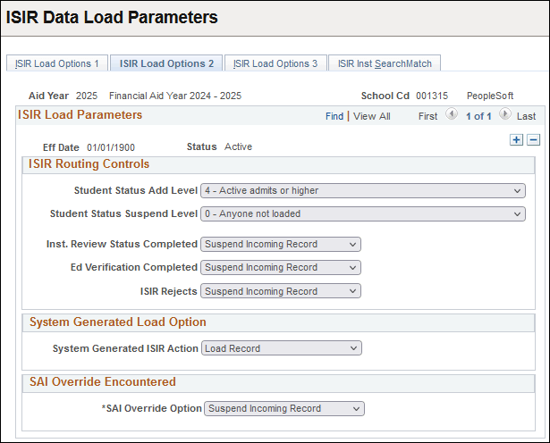

Access the ISIR Load Options 2 page ().
This example illustrates the fields and controls on the ISIR Load Options 2 page. You can find definitions for the fields and controls later on this page.
These load parameters are for processing all initial ISIR records and system-generated ISIR's.
During the ISIR Load process, the program processes these Data Load Parameters in the following order:
Inst. Review Status Completed
Ed Verification Completed
ISIR Rejects
Add Admit Level/ Suspend Admit Level
EFC Override Encountered
The incoming ISIR record must meet the criteria defined at each processing step in order to be eligible to load.
ISIR Routing Controls
Field or Control |
Description |
Student Status Add Level |
Select the minimum admit level that a student must have for the system to load the ISIR to the application tables. Values are: 0 - Load Everyone 1 - Recruits or higher 2 - Inactive Admits or higher 3 - Applicants or higher 4 - Active Admits or higher 5 - Accepted/Continuing only |
Student Status Suspend Level |
Select the minimum admit level that a student must have for the system to suspend the ISIR. Values include: 0 - Anyone not loaded 1- Recruit or higher 2 - Inactive Admits or higher 3 - Applicants or higher 4 - Active Admits or higher 5 - Accepted/Continuing only |
Inst. Review Status Completed (institutional review status completed) |
Select instructions for handling the ISIR if the institutional review status is complete. This status is maintained on the Packaging Status Summary page. Values are: Discard Incoming Record, Load Record, and Suspend Incoming Record. |
Ed Verification Completed (educational verification completed) |
Select the instructions for handling the ISIR if the educational verification is complete. This status is maintained on the Packaging Status Summary page. Values are: Discard Incoming Record, Load Record, and Suspend Incoming Record. |
ISIR Rejects |
Select the instructions for handling rejected ISIRs. Values are: Discard Incoming Record, Load Record, and Suspend Incoming Record. |
System Generated Load Option
Field or Control |
Description |
System Generated ISIR Action |
Select the way in which system-generated ISIRs should be processed. All system-generated ISIRs follow the same ISIR load options and routing control rules as regular, noncorrection ISIRs. Select from these values:
Note: Because these ISIRs can be generated for various reasons, you might suspend all records of this type and first review them in the Suspense Management page before loading them. The load process attempts to determine and assign the ID before the record is suspended.
EFC Override Option
Field or Control |
Description |
EFC Override Encountered (expected family contribution override) |
Select one of the following: Ignore EFC Override Values, Suspend Incoming Record, or Use EFC Override Values. |

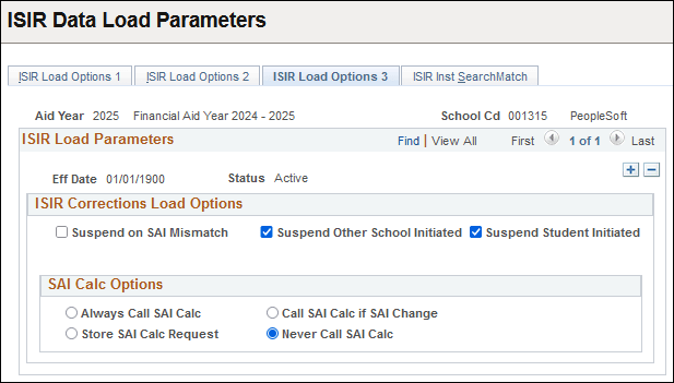

Access the ISIR Load Options 3 page ().
This example illustrates the fields and controls on the ISIR Load Options 3 page. You can find definitions for the fields and controls later on this page.
Use these load parameters for processing all corrected ISIRs. To identify ISIRs corrected by the recipient school, the ISIR Electronic Transaction Indicator (ETI) field value is checked and only those records with a value of 0, 2, 4, or 6 are selected. This indicates that the recipient school initiated the correction record, and you can process the ISIR normally. You can suspend any other ISIR ETI value, except blank, as a non-school initiated correction using the Suspend Other School Initiated and Suspend Student Initiated ISIR load options.
Note: The process of loading corrected ISIRs is not the same as for initial ISIRs. See Processing Inbound Files for details.
ISIR Corrections Load Options
Field or Control |
Description |
Suspend on EFC/SAI Mismatch (suspend on expected family contribution/student aid index mismatch) |
Select to suspend the corrected ISIR if the primary EFC/SAI on the ISIR does not match the last calculated primary EFC/SAI for the student stored in PS_ISIR_COMPUTED.PRIMARY_EFC. |
Suspend Other School Initiated |
Select to suspend ISIRs that are initiated by another school or the CPS/FPS. |
Suspend Student Initiated |
Select to suspend ISIRs that are initiated by the student. |
Note: A school-initiated correction is processed with the Suspend on EFC/SAI Mismatch load option set. If no previously loaded ISIR exists, the process treats the condition as an application ISIR and follows the application ISIR load parameter settings. This allows initially rejected ISIRs corrected by the school to load as initial application ISIRs.
Because a student has likely already been processed for financial aid when you receive the corrected ISIR, the system provides INAS options.
INAS/SAI Call Options
Field or Control |
Description |
Always Call EFC/SAI Calc (always call Institutional Need Analysis System) |
Select to run the FM NAC calculation as the ISIR is loaded into the application tables. This is similar to the Call INAS check box on the ISIR Load Options 1 page. |
Store EFC Calc/SAI Calc Request (store Institutional Need Analysis System calculation request) |
Select to store the ID and aid year of the record for later Mass EFC/SAI processing. |
Call EFC/SAI Calc if EFC/SAI Change (call Institutional Need Analysis System if expected family contribution change) |
Select to run an FM NAC calculation only if the primary EFC/SAI on the ISIR does not match the last calculated primary EFC/SAI. |
Never Call EFC/SAI Calc (never call Institutional Need Analysis System) |
Select to disable the system from calling the FM NAC when the ISIR is loaded. This feature doesn't support future Mass EFC/SAI calculation. |

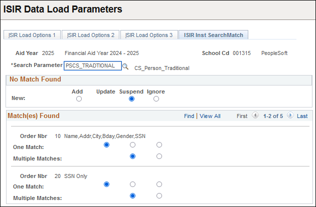

Access the ISIR Inst SearchMatch page ().
This example illustrates the fields and controls on the ISIR Inst SearchMatch page. You can find definitions for the fields and controls later on this page.
You determine how restrictive to make the Matching process. The system searches on the match that you select by reviewing personal data until it finds a match. When the search and match process runs, the program starts with the first order number and moves through the order numbers until it finds a match. If the system finds no matches at any level, then the option that you selected in the No Match Found group box takes effect. To load all students into the system regardless of match, override the No Match Found level.
Note: The search match options apply only to ISIRs where no prior year ISIR was loaded into the database.
The system displays the aid year and school code.
Field or Control |
Description |
Search Parameter |
A search parameter is a set of one or more search rules that you order sequentially with the lowest (or first) search order level as the most restrictive, and the highest (or last) search order level as the least restrictive. A search parameter must be created even if it contains only one search rule. |
No Match Found
Field or Control |
Description |
New |
Select an option to indicate the action the system takes when the Search Match process does not find a matching record. Values are: Add: The system adds the record to your database and generates a new ID for the ISIR. Suspend: The record is put in suspense. Ignore: The system sets the load status to Skipped; the ISIR is not loaded and is ignored by the load process. |
The Match(es) Found group box has one row for each search match criteria order defined by your institution. Use the scroll bar to scroll through the levels of search criteria.
Match(es) Found
Field or Control |
Description |
Order Nbr (order number) |
Displays a separate listing for each order number level of search criteria. The number of search match levels depends on the Search Parameter you selected to use for the ISIR load process. |
One Match |
For each order number, select an option to determine how the system processes the record. Values are: Update: The system updates the existing record with the matching record. Suspend: The system assigns a suspended load status to the matching record. Ignore: The system sets the load status to Skipped. |
Multiple Matches |
For each order number, select an option to determine what to do with the record. Values are: Suspend: The system assigns a suspended load status to the matching record. Ignore: The system sets the load status to Skipped; the ISIR is not loaded and is ignored by the load process. |
****Parameters Refreshed**** |
The system displays this message in red text when the ISIR Institutional Search Match parameters are not saved or the global Search Match parameters are not changed since you last updated this page. If you change parameters and do not save the changes or if you make a change since the last changes were made, the system displays this message. You may want to create a Financial Aid-specific Search Parameter that can perform the ISIR search match function more efficiently than the provided PSCS_TRADTIONAL. For example, you may want to create a search parameter that contains a single search match order that does a last name, Social Security number, and student birth date match. |
