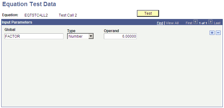

Access the Equation Test Data page ().
This example illustrates the fields and controls on the Equation Test Data page. You can find definitions for the fields and controls later on this page.
Use this page to define the name of the global variable, type, and operand.
After you have defined all the necessary variables and entered data on the Equation Test Data page, click the Test button.
The system displays the Equation Test Results - Process Messages page.

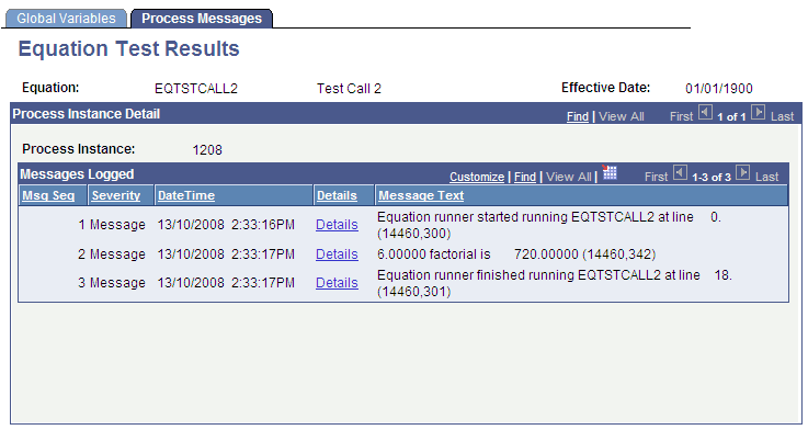

Access the Equation Test Results page: Process Messages tab (click the Test button on the Equation Test Data page).
This example illustrates the fields and controls on the Equation Test Results page: Process Messages tab. You can find definitions for the fields and controls later on this page.
The page displays the messages associated with the equation test run.

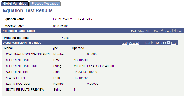

Select the Global Variables tab.
This example illustrates the fields and controls on the Equation Test Results page: Global Variables tab. You can find definitions for the fields and controls later on this page.
The Global Variable page displays the global variables used within the current equation run.
