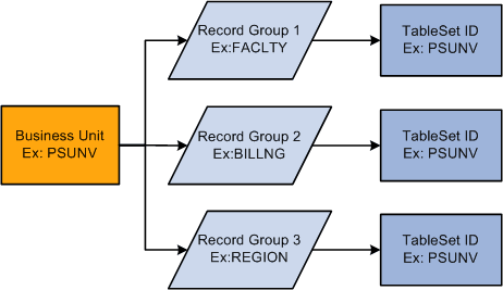

A record group is a set of functionally or logically related records or views based on how the records are used in the system. A record group can contain a single record or view, or it can contain many records and views. Record groups are delivered as part of the PeopleSoft system and should not be altered.
When you create a business unit, that business unit is automatically linked to each record group in the system that you are using.
Record groups exist for two purposes:
- To save time in data entry. - With record groups, tableset sharing can be accomplished quickly and easily instead of requiring redundant data entry.
- To provide consistency in the data. - Record groups ensure that tableset sharing is applied consistently across all related tables and views in the system.
When you create and then save a business unit, a new tableset ID with the same name as the business unit is created. The system automatically assigns that tableset ID to each record group for the new business unit.
Note: PeopleSoft suggests that you create tableset IDs and business unit names that are five characters long. A performance degradation occurs if the tableset IDs or business units have fewer than five characters.
This diagram illustrates the relationship between business unit, record group, and tableset ID:
This example shows how data can pass from a business unit through three record groups and into tableset IDs.

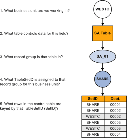

With tableset sharing, you can specify the control table data that the system uses for each business unit. If much of the control table data is the same from business unit to business unit, tableset sharing enables you to share that information, instead of having to enter the same data multiple times.
To understand how this works in the PeopleSoft system, consider what happens when a user makes a selection from the available options. The list that appears contains all of the valid entries that can be entered in the field based on the relevant business unit.
This series of questions outlines the online process that occurs:
These five questions step users through the tableset sharing process.
Note: Record groups and setIDs for a set control value have a one-to-one relationship.
