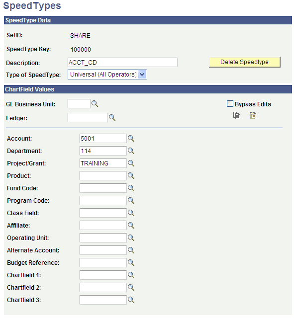

Access the SpeedTypes page ().
This example illustrates the fields and controls on the SpeedTypes page. You can find definitions for the fields and controls later on this page.
The type of SpeedType depends on what you select for the User ID and Primary Permission List fields. The type of SpeedType is then displayed at the top of the SpeedTypes page.

Select the type of speed type to restrict the key to a particular operator or class. Values are: One Operator: Only the operator specified in the dialog box can use this key combination. When you select this option, the User field becomes available and the Prim Perm List (primary permission list) field becomes unavailable. One Operator Class: Only the operator class specified in the dialog box can use this key combination. When you select this option, the Prim Perm List field becomes available for use and the User field becomes unavailable. Universal (All Operators): All operators are authorized to use this combination. When this option is selected, both the User and Prim Perm List fields become unavailable. |
Bypass Edits |
Select to bypass the edits when setting up SpeedTypes. Bypassing the edits enables you to set up an incomplete SpeedType. For example, you could leave the Fund field blank, and cashiers could enter the appropriate fund during department receipt creation. Note: The functionality of the Bypass Edits check box is relevant only if you select the Combinations Table Edit check box on the SF Installation page. When you select the Combinations Table Edit check box, the system processes department receipts only if cashiers select the correct ChartFields. |
Copy and Paste |
If you are entering multiple SpeedTypes, you can select your ChartFields, copy and paste them into the next SpeedType that you create, and then revise individual ChartFields. |
