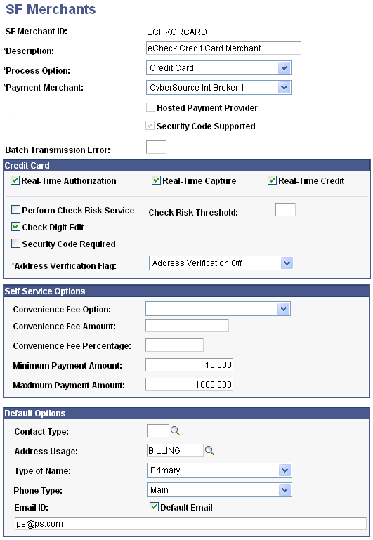

Access the SF Merchants page ).
This example illustrates the fields and controls on the SF Merchants page. You can find definitions for the fields and controls later on this page.

Process Option |
Select the type of transaction that is governed by the SF Merchant rules that you are defining: Credit Card or Electronic Check. |
Payment Merchant |
Enter the Payment Merchant that you wish to use for this SF Merchant. The ID can be shared by several SF Merchant definitions. Note: If you intend to process both credit card and eCheck self-service transactions, you must set up two SF merchants, one with a process option of Credit Card and one with a process option of Electronic Check. |
Hosted Payment Provider |
If the payment merchant that you select on this page is a hosted payment provider and you selected the Hosted Payment Provider check box on the Payment Merchant page, the check box on this page appears selected and unavailable for edit. If the payment merchant that you select on this page is not a hosted payment merchant, the Hosted Payment Provider check box appears on this page but is cleared and is not available for edit. |
Security Code Supported |
If you select the Security Code Supported check box on the Payment Merchant page to indicate that the merchant supports the sending of Security Code values, the check box on this page appears selected and unavailable for edit. This check box does not appear for hosted payment providers. |
Batch Transmission Error |
Enter the maximum number of batch transmission errors that you want the system to allow before canceling the batch transmission. |
