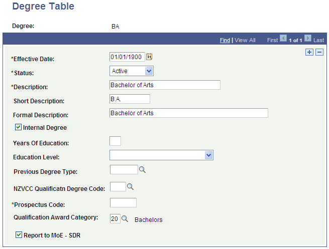

Access the Degree Table page ().
This example illustrates the fields and controls on the Degree Table page. You can find definitions for the fields and controls later on this page.
Field or Control |
Description |
Status |
Select a status for this degree. Select Active when the degree is valid for your institution. You can keep all degrees in the database for historical purposes by setting any degrees that you no longer award to Inactive. |
Description, Short Description, and Formal Description |
Enter descriptions of the degree. Later, you can identify which description appears on the transcript. |
Internal Degree |
Select to indicate that the degree is internal to your institution and that it does not represent a degree from another organization. |
Years of Education |
No programming is tied to this field; use it for informational purposes only. |
Educational Level |
No programming is tied to this field; use it for informational purposes only. Values for this field are delivered with your system as translate values. You can modify these values. |
(NZL) NZVCC Qualificatn Degree Code (New Zealand Vice Chancellors Committee qualification degree code) |
Enter the NZVCC qualification code for this degree. The system uses this value when generating the Graduate Destinations Survey report. This field is available only when you select the NSI and SDR Personal Data, SDR Degree check box on the SA Features page on the Installation table. |
(NZL) Prospectus Code |
Enter the Ministry of Education (MoE) identifier. The system uses this value when generating the Qualification Completion file. This field is available only when you select the NSI and SDR Personal Data, SDR Degree check box on the SA Features page on the Installation table. |
(NZL) Qualification Award Category |
(Optional) No programming is tied to this field; use it for informational purposes only. Values for this field are delivered with your system as translate values. You can modify these values. This field is available only when you select the NSI and SDR Personal Data, SDR Degree check box on the SA Features page on the Installation table. |
(NZL) Report to MoE - SDR (report to Ministry of Education - Single Data Return) |
Select to include students awarded this degree in the Qualification Completions file. This field is available only when you select the NSI and SDR Personal Data, SDR Degree check box on the SA Features page on the Installation table. |
