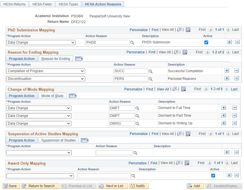

HESA Action Reasons
SSR_HE_HESA_ACTN
Records and Enrollment > HESA Reporting > HESA Returns Setup > Returns Setup > HESA Action Reasons
For the Student return, map HESA field codes to the Campus Solutions Program Action and Action Reason values. The system uses this mapping to derive HESA return field values.

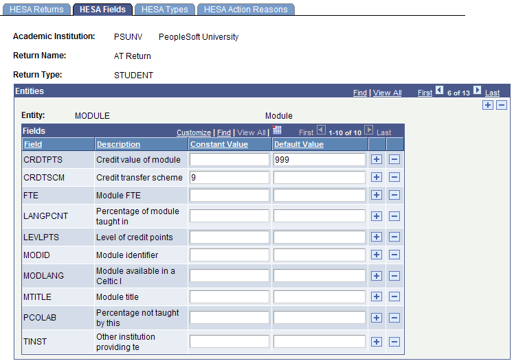

Access the HESA Fields page (Records and Enrollment > HESA Reporting > HESA Returns Setup > Returns Setup > HESA Fields).
This example illustrates the fields and controls on the HESA Fields page. You can find definitions for the fields and controls later on this page.
HESA (Higher Education Statistics Agency) Fields page
Use a field constant when your institution wants to return the same value for an entity. For example, if you want the system to derive the Credit transfer scheme as No Scheme for all modules in the Student return 2008/09, set the Module.CRDTSCM constant value to 9.
Use the field default to reduce the amount of data entry by defining a default value to be used when no value is derived for a mandatory field. For example, if a default value of 999 is defined for the Module.CRDTPTS field, and no data is found for a module, then 999 is used.
Note that you must enter the value NULL if you want to define a null constant or default.
Note: The Constant Value field or the Default Value field can accept a maximum of 30 characters. Therefore, the system does not use these two fields in the derivation of the Unistats/KIS fields that exceed 30 characters (for example, the URL fields).
Note: For Unistats/KIS: The LEVELK field has K appended to distinguish it from the LEVEL field in the Aggregate Offshore return. The TITLEK field has K appended to distinguish it from the TITLE field in the ITT return. JACSA, JACSB and JACSC fields have A, B and C appended to allow three values to be returned and to distinguish the fields from the JACS field in the DLHE return.

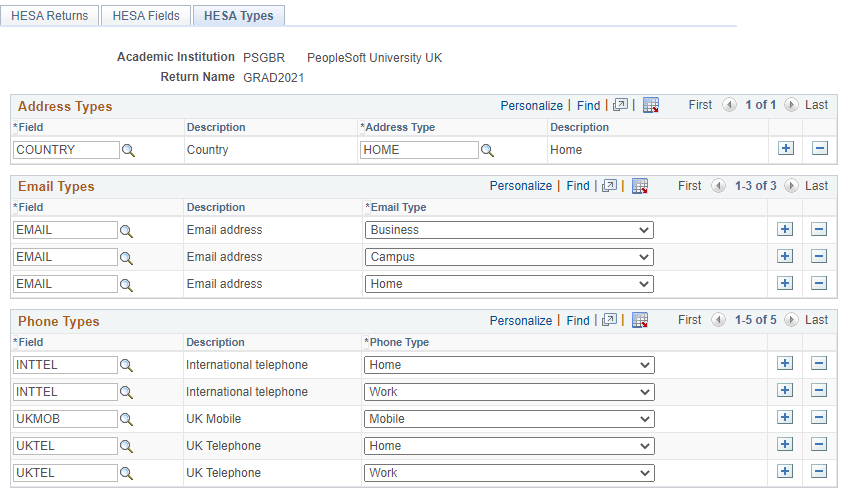

Access the HESA Types page (Records and Enrollment > HESA Reporting > HESA Returns Setup > Returns Setup > HESA Types).
This example illustrates the fields and controls on the HESA Types page. You can find definitions for the fields and controls later on this page.
HESA (Higher Education Statistics Agency) Types page
Name Types
The system uses the Name Types mapping to derive Student.SNAME16 for Data Futures and Student returns.
This region does not appear for Graduate Outcomes return. Name details are derived from Primary name records as per Student return.
Address Types
The system uses the Address Types mapping to derive the following fields:
  • EntryProfile.POSTCODE

For Graduate Outcomes, only the COUNTRY field is available. Users can define one or more address types that are considered when deriving the COUNTRY field and the Postal Address entity. If users do not define a type, all active address are considered during derivation.
Note: The Address Types region is not applicable for the Register/ITT return.
External ID Types
The system uses the External ID Types mapping to derive the following fields for the Register/ITT return:
  • Student.NIN
  • Student.TREFNO
  • Student.ULN
The system uses the External ID Types mapping to derive the following fields for the Data Futures return:
  • Engagement.RCSTDID
  • Engagement.UKRISRN
  • Student.SCN
  • Student.UCASPERID
  • Student.ULN
For information about defining external systems and entering external system IDs for a person or an organization, see:
Email Types
Use this region to define one or more email types for the Graduate Outcomes return EMAIL field and for the Register/ITT return NQTEMAIL field.
If you do not define a type, all emails are considered during derivation.
The system uses Email Types to derive the following fields for Graduate Outcomes return:
  • GRADUATE.EMAIL
  • GRADUATE.EMAIL2
  • GRADUATE.EMAIL3
Person ID Type
Use this region to define one or more ID types for the Data Futures return. The system uses the Person ID Type to derive PersonIdentifier.IDTYPECODE.
Phone Types
Use this region to define one or more phone types for the Graduate Outcomes return INTTEL, UKMOB, and UKTEL fields. If you do not define a type, all phone numbers are considered during derivation. The system uses Phone Types to derive the following fields for Graduate Outcomes return:
  • GRADUATE.INTTEL
  • GRADUATE.INTTEL2
  • GRADUATE.INTTEL3
  • GRADUATE.UKMOB
  • GRADUATE.UKMOB2
  • GRADUATE.UKMOB3
  • GRADUATE.UKTEL
  • GRADUATE.UKTEL2
  • GRADUATE.UKTEL3
Access the HESA Action Reasons page (Records and Enrollment > HESA Reporting > HESA Returns Setup > Returns Setup > HESA Action Reasons).
This example illustrates the fields and controls on the HESA (Higher Education Statistics Agency) Action Reasons page. You can find definitions for the fields and controls later on this page.
Use this page to define the combinations of program action and action reason that the system uses to indicate PHD submission for research students, reason for ending studies, mode change, suspension of active studies, and award-only mapping.
For each region, if you edit the Program Action values the corresponding Action Reason fields are cleared to prevent an invalid combination from being saved.
Note: The Phd Submission Mapping and Suspension of Active Studies Mapping regions are not applicable for the Register/ITT return.
The system uses this mapping to derive the StudentCourseSession.PHDSUB field.
Reason for Ending Mapping
Map the program action and action reason values to the (HESA) Session Reason, Leaver Reason, and Instance Reason codes.
The system uses this mapping to derive Data Futures return Leaver.RSNREGEND field and StudentCourseSession.RSNSCSEND.
Change of Mode Mapping
Map the program action and action reason values to the HESA Session Status and HESA Session Mode codes. For Register/ITT returns, these are hidden and Mode of Study is used to derive MODE.
The system uses this mapping to derive StudentCourseSession.SCSMODE and SessionStatus entities, and to determine the mode of study during the calculation of FTE.
Award Only Mapping
The mapping in this grid is used in cases where the student’s program or plan is changed in order to make an intermediate award. When this happens, you must define the combinations of program action and reason that are used to make the change and complete the program. For example, Program Change/AWDP followed by Completion of Program/SUCC and those rows in Student Program/Plan are not considered when determining the COURSEID for the instance. This ensures continuity with what has been previously reported to HESA for that instance. The new program or plan is considered for the derivation of Qualifications Awarded. If you do not set a mapping as active, the program action and reason mapping continues to be considered.
This grid appears only for Student and Register/ITT returns.
Field or Control
Description
Action Reason
(Optional) If you do not define a value, all action reasons (including blanks) are considered for the Program Action.
Active
By default, this check box is selected. You can deselect this check box to indicate that the mapping row is considered.
