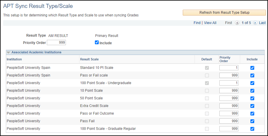

Use the APT Sync Result Type/Scale page (SSR_APT_SYN_RSLT) to prioritize and include the valid Result Types and Result Scales to sync grades to APT.
Navigation:
This example illustrates the fields and controls on the APT Sync Result Type/Scale page.
Field or Control |
Description |
Refresh from Result Type Setup |
Click this button to retrieve the result types that are set up on the Result Type page. See Setting Up Result Types. Note: The Result Types from the Result Type page with a Result Value Field Type of Result Scale and an Item Type Usage of Course are retrieved here. |
Priority Order |
Enter the order in which the Result Type is chosen to sync grades in APT Sync process. You must define the values before running the APT Sync Process. |
Include |
Select this check box to include the Result Type in APT Sync process. This check box is selected by default. |
Associated Academic Institutions
Field or Control |
Description |
Default |
Displays the default Result Scales as defined in Result Type Setup. See Setting Up Result Types. |
Priority Order |
Determines the order in which the Result Scale is chosen to sync grades in APT Sync process within the Result Type. Users must define the values before running the APT Sync Process. |
Include |
Select this check box to include the Result Scale in APT Sync process. This check box is selected by default. |

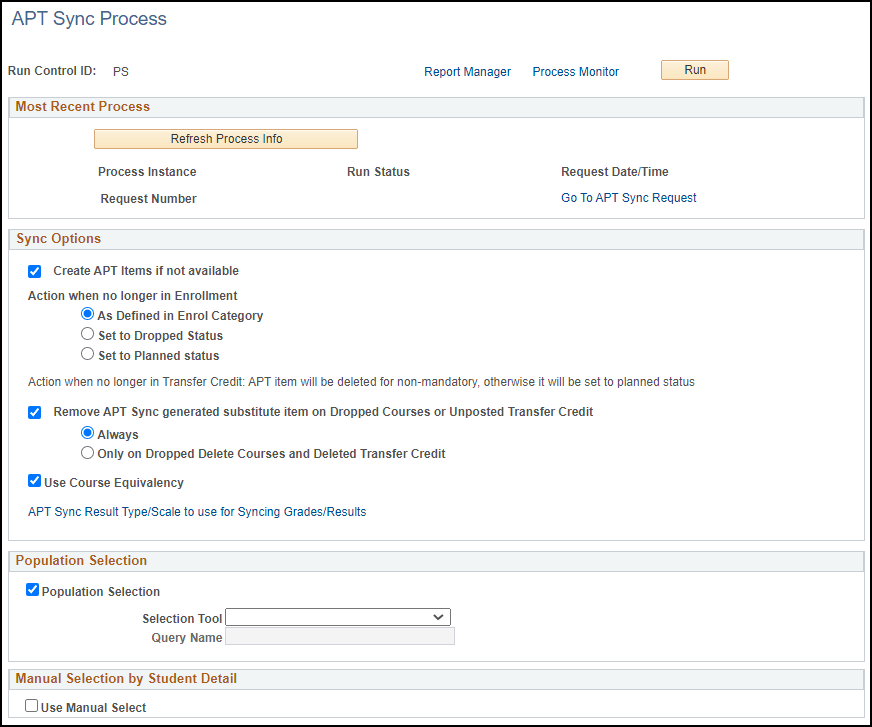

Use the APT Sync Process page (SSR_APT_SYN_RUNCNT) to synchronize the enrollment and transfer credit transactions to students APT.
Navigation:
This example illustrates the fields and controls on the APT Sync Process page.
Most Recent Process
Field or Control |
Description |
Refresh Process Info |
Click this button to retrieve the most recent process information for the Run Control ID. |
Go To APT Sync Request (go to academic progress tracker sync request) |
Click this to open the APT Sync Request page which displays the most recent process request information. |
Sync Options
Field or Control |
Description |
Create APT Items if not available (create academic progress tracker items if not available) |
Select this option to generate an APT Item sequence when an enrollment or posted transfer credit course matches AIR course and the planning node for the term has been created but there is no APT Item sequence yet. |
Action when no longer in enrollment |
Select the option you want to use if an enrolled course is drop deleted:
Note: Action When No Longer in Transfer Credit APT Items are deleted for non-mandatory Courses. Mandatory Courses are set to Planned status. The process deletes an APT Item if there is only one attempt. If an APT Item has multiple attempts, only the attempt that matches the Term is deleted. |
Remove APT Sync generated substitute item on Dropped Courses or Unposted Transfer Credit |
Select when you want the process to delete a substitute item that was created through APT Sync:
Note: Substitute Items created manually in the APT page can't be deleted using this option. The substitution remains, and the status is set to Planned. |
Use Course Equivalency |
Select to match by Course Equivalency and generate substitution if the enrolled or transfer credit course does not find the match in AIR/APT. Note: If the equivalent AIR course belongs to a course group, substitution isn't allowed. |
APT Sync Result Type/Scale to use for Syncing Grades/Results (academic progress trackers sync result type/scale to use for syncing grades/results) |
Click this link to open the APT Sync Result Type/Scale Setup page. |
