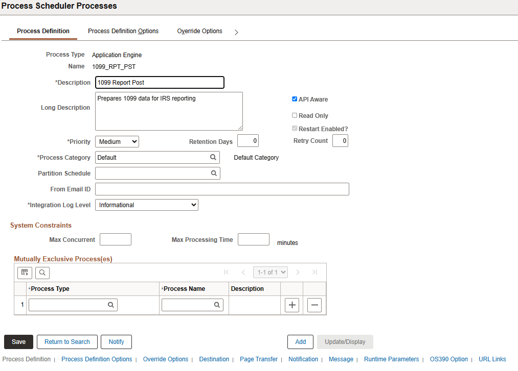

Select PeopleTools > Process Scheduler > Process Scheduler Processes to access the Processes - Process Definition page.
This example illustrates the fields and controls on the Processes - Process Definition page.
To use PeopleSoft Process Scheduler for starting Application Engine batch programs, create a process definition for each program. Running Application Engine programs is similar to running any COBOL or Structured Query Report (SQR) program that you typically invoke with PeopleSoft Process Scheduler. Use Application Engine as the generic process type definition. Each Application Engine program that you invoke using PeopleSoft Process Scheduler requires a unique process definition derived from the generic process type definition.
Note: When creating a process definition based on the Application Engine process type definition, the process name you assign must match your Application Engine program name exactly.

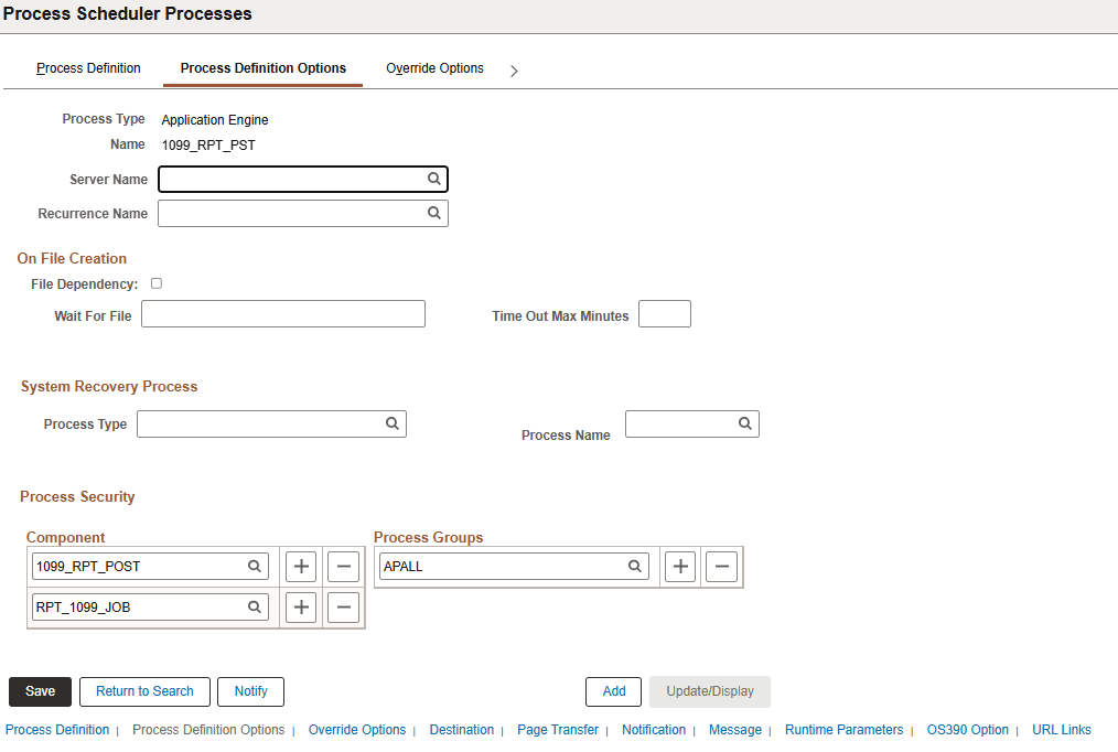

Select PeopleTools > Process Scheduler > Process Scheduler Processes  > Process Definition Options to access the Processes - Process Definition Options page.
This screenshot shows the Processes - Process Definition Options page.
Use this page to list parameters. The complete parameter list is:
  • -ct %%DBTYPE%%
  • -cd %%DBNAME%%
  • -co %%OPRID%%
  • -cp %%OPRPSWD%%
  • -r %%RUNCNTLID%%
  • -i %%INSTANCE%%
  • -ai %%PRCSNAME%

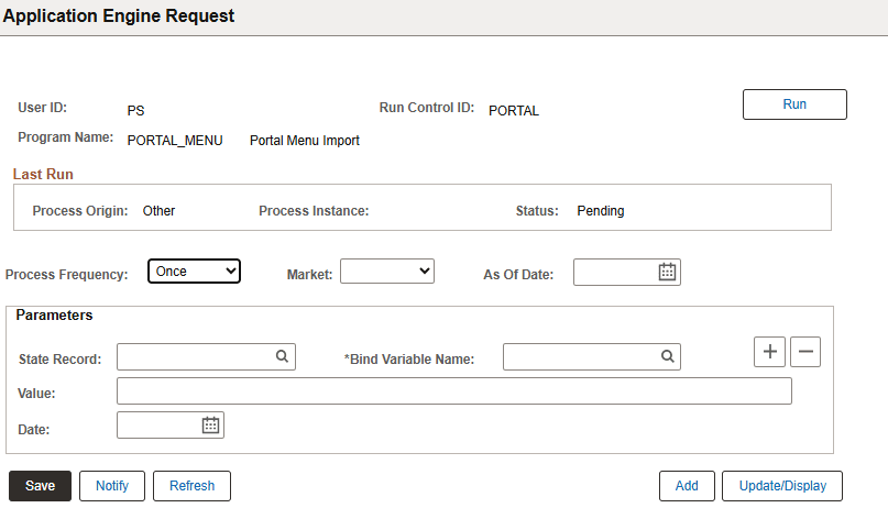

You also can start an Application Engine program by using the Application Engine Process Request page. Using this request page enables you to specify values and parameters in addition to those that appear within PeopleSoft Process Scheduler process definitions.
Most users start Application Engine programs from an application-specific request page using PeopleSoft Process Scheduler. A systems expert or power user may, at times, need to create custom process requests that require multiple programs to perform parallel processing or that need to set specific, initial values in a state record. You might use the Application Engine process request page for one of these cases.
Note: Generally, if seed data or other Application Engine request settings are required for a particular program, the application-specific request page has SQL executables that do the work that is transparent to the user. Typically, no user should invoke programs from the generic process request page. Use this page for internal testing and as a basis for designing program-specific request pages.
Tables Used in the Process Request Page
The Application Engine process request page inserts values into the following tables:
  • AEREQUESTTBL
    Contains all of the values that appear on the page except those in the Parameters group box.
  • AEREQUESTPARM
    Includes only initial state record values specified in the Parameters group box, if needed.
Note: Inserting a row in either of the Application Engine request tables is not required to run an Application Engine program. This change is a key difference between Application Engine versions prior to PeopleTools 8, where a row in Application Engine request tables is required to start a program, regardless of how it is invoked. The run control ID is available to your program using %RunControl, whether or not a row is inserted into the AEREQUESTTBL table.
You need to use the Application Engine Request page to invoke Application Engine and insert a row into the Application Engine request records only if you need to perform any of the following tasks:
  • Insert initial values into the state records associated with a particular program.
  • Set an as-of date for the Application Engine program to perform retroactive processing.
  • Set a non-default market for the program.
  • Set up a temporary table image to use if you are submitting a PeopleSoft EPM process request that performs parallel processing. Refer to PeopleSoft EPM application documentation for details.
Note: Entries in the AEREQUESTTBL table do not have any effect on Application Engine programs called from PeopleCode using the CallAppEngine function.
Application Engine Requests
Select PeopleTools > Application Engine > Submit AE Process Requests to access the Application Engine Request page.
This example illustrates the fields and controls on the Application Engine Request page. You can find definitions for the fields and controls later on this page.
Field or Control
Description
Process Origin
Displays where the program was invoked, from PeopleSoft Process Scheduler, from the command line, and so on.
Process Instance
Displays the process instance assigned to the previous program run.
Status
Displays the status of the last program run, whether it is successful, pending, and so on.
Process Frequency
Specify how long a particular process request will remain active or valid:
  • Always: Select to run the process request as needed.
  • Once: Select if a process request is a one-time-only request.
  • Don’t: Select to disable a process request so that no one invokes it and potentially corrupts data.
As Of Date
If you are requesting retroactive processing, specify the appropriate as of date.
Bind Variable Name
Enter the appropriate field or bind variable for which you are inserting a value.
Value
Enter the initial value that you want to set for the specified field.
