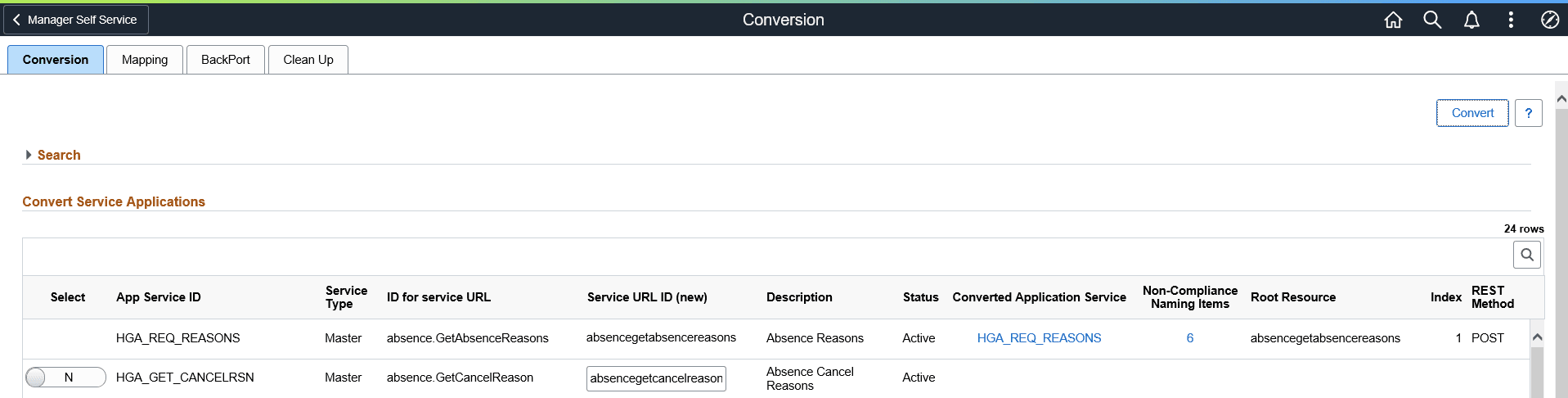

When an Chatbot Service is selected for conversion, the value for ID for service URL will be modified to conform to the Oracle REST standard. The new Service URL ID is also validated to ensure that the value is not a current IB Service Alias. Optionally, the administrator can update the value in the Service URL ID (new) edit box.  The conversion page will then copy the data out of the old Application Service tables and build a new Application Service in the new framework.
Note: The old application service will not be deleted as part of the conversion process. If you need to rerun the conversion process, you must first delete the new application service using the Delete Application Service page. See Deleting Application Services
Select PeopleTools > Integration Broker > Application Services > Application Service Utilities > Chatbot Service Conversion.
This example illustrates the fields and controls on the Chatbot Conversion page. You can find definitions for the fields and controls later on this page.

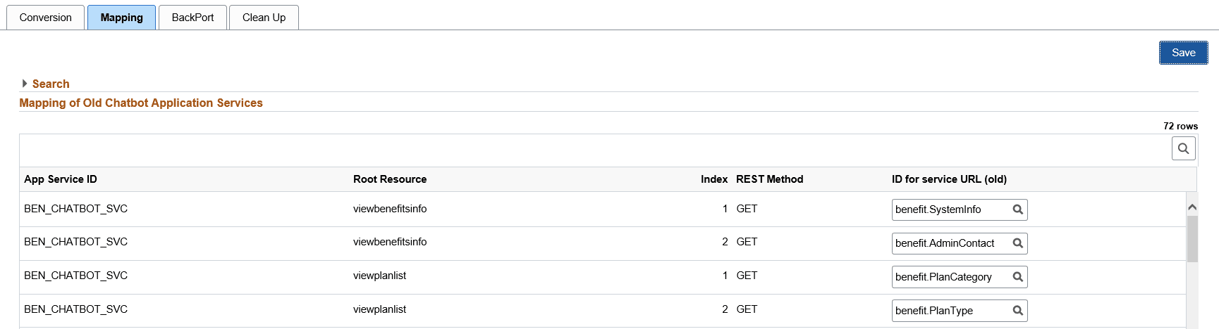

Existing Chatbots will be converted to Application Services in PeopleTools 8.59 and delivered in updates with new PeopleSoft Images. Since the customer’s target database may be on a previous release, this page is used to map the modified Application Service to the original old Application Service. This mapping is required for proper backporting and to generate a properly defined Chatbot discovery document. This mapping is also used to insure proper conversion of customer's Alias Application Services and to remove orphaned new Application Services.
Note: This mapping is typically performed by PeopleSoft developer as it is only necessary to backport Application Services to an older release. However, if a customer performs a tools only upgrade and makes a change to the Application Service which requires the discover document to be re-exported, the customer would first need to perform the mapping in order for the Component name to displayed.
Select PeopleTools > Integration Broker > Application Services > Application Service Utilities > Chatbot Service Conversion > Mapping tab
This example illustrates the fields and controls on the Chatbot Conversion Mapping page from a PeopleSoft Update Image. You can find definitions for the fields and controls later on this page.
When PeopleSoft delivers a new Oracle compliant Application Service for a converted chatbot, the mapping page will be updated to map the Application Services to the old ID for the service URL.

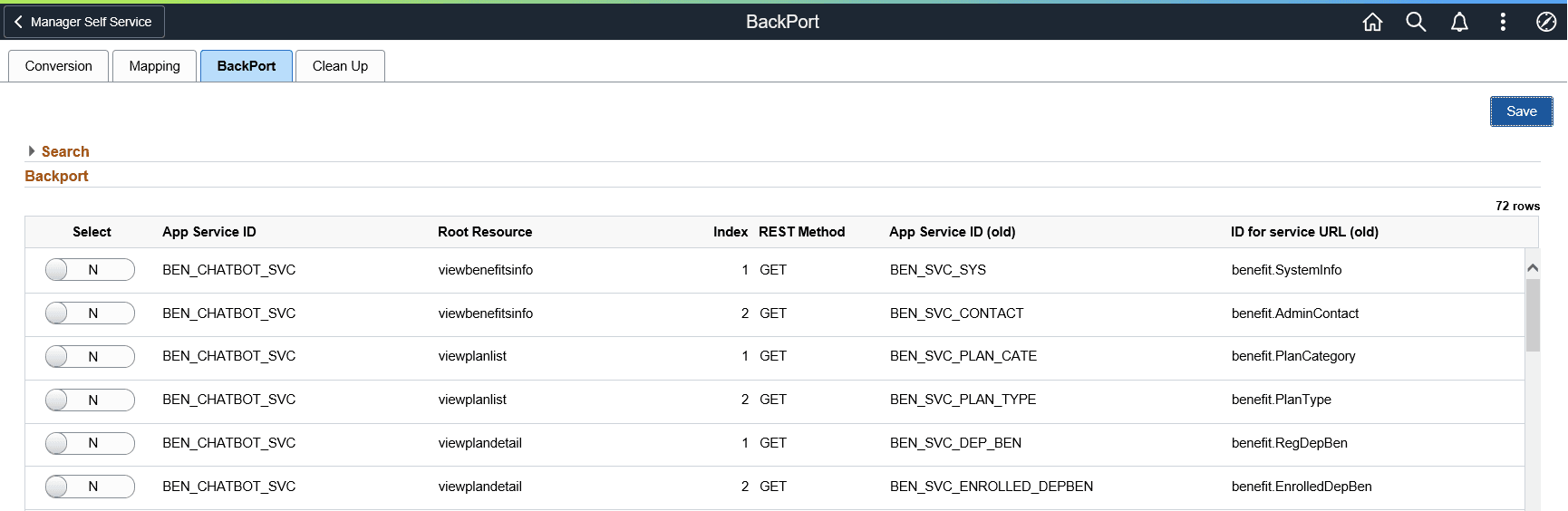

The BackPort page is used for Application Services that need to be backported to an earlier PeopleTools release (8.58 or 8.57).
This example illustrates the fields and controls on the BackPort page.
BackPort page
  • For Application Services defined in a previous PeopleTools release the value is populated (read only).
  • For new Application Services this information needs to be populated.
When the page is saved checks are performed to insure the data can be properly backported.  The following checks are performed:
  • Template, input, output parameter names must be unique.
    If a duplicate parameter defined the save will not occur and the developer would need to update the Application Service accordingly.
  • No headers are backported.
If save is successful, the old chatbot tables are populated. The metadata can be added to an ADS project.

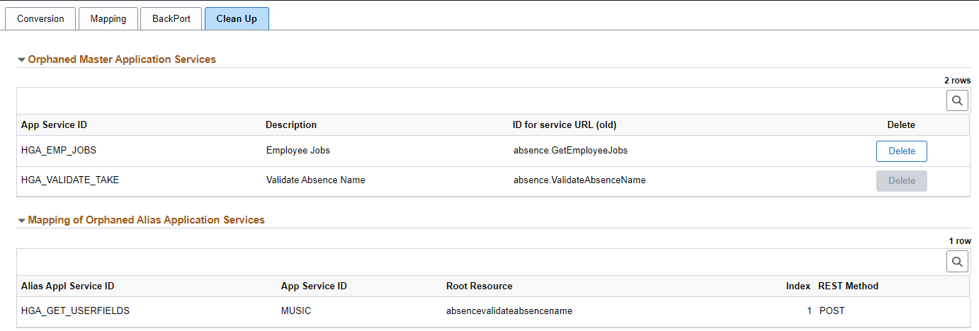

Clean up is required in the following scenario:
  1. Customer performs a tools only upgrade to PeopleTools 8.59.
  2. Customer updates the old Chatbot Application Service.
  3. PeopleSoft delivers an Application Service update that includes the same Application Service where the metadata has been modified to be compliant with Oracle standards.
    In this case some of the old Chatbot Services are merged into a single Application Service.
  4. When the customer takes the Application upgrade, both the updated Application Services as well as the original Application Services exist in the database.
  5. The customer upgraded Application Services is then orphaned as they can not be called from Oracle Digital Assistant (ODA).
This example illustrates the fields and controls on the Clean Up page where there are 2 orphaned Application Services.
Clean Up page
If the orphaned Application Service has an associated orphaned Alias, the Delete button is disabled. In this case it is necessary to create a new Alias Application Service and add the necessary root resources to override the primary root resources before you can delete the orphaned alias Application Service using the Delete Application Service page.
Use the Delete button to remove any Application Services from the new data model that are considered Orphaned Services.
