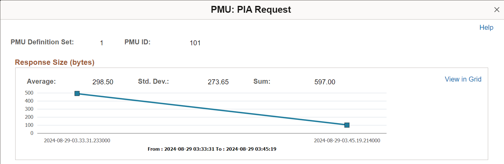

Metric Charts
When your search criteria includes a PMU set and PMU identifier, all rows in the grid will be of the same type of PMU. In this case, the metric chart displays the metric values of the returned PMUs against one another. This enables you to track metrics over a period of time.
This example illustrates the fields and controls on the Viewing a metric chart.
Numeric metrics may be of type Counter, Gauge, or Numeric Identifier. Numeric identifiers do not appear in charts. Gauges and counters do appear in charts, but the chart does not contain a sum value for gauges.
Use the View in Grid link to view the chart information in a grid so that you can download the information to an Microsoft Excel spreadsheet if needed.
Note: If the metrics of a PMU can't be charted, a message appears stating this fact.
Note: To view the metric chart, you must specify a PMU and PMU set ID as part of the search criteria. If you click this link when performance data for multiple PMUs appears, the system displays an error message.
Note: The data appearing on this chart is not manipulated by multipliers, if any are used.
See Metric Definitions.

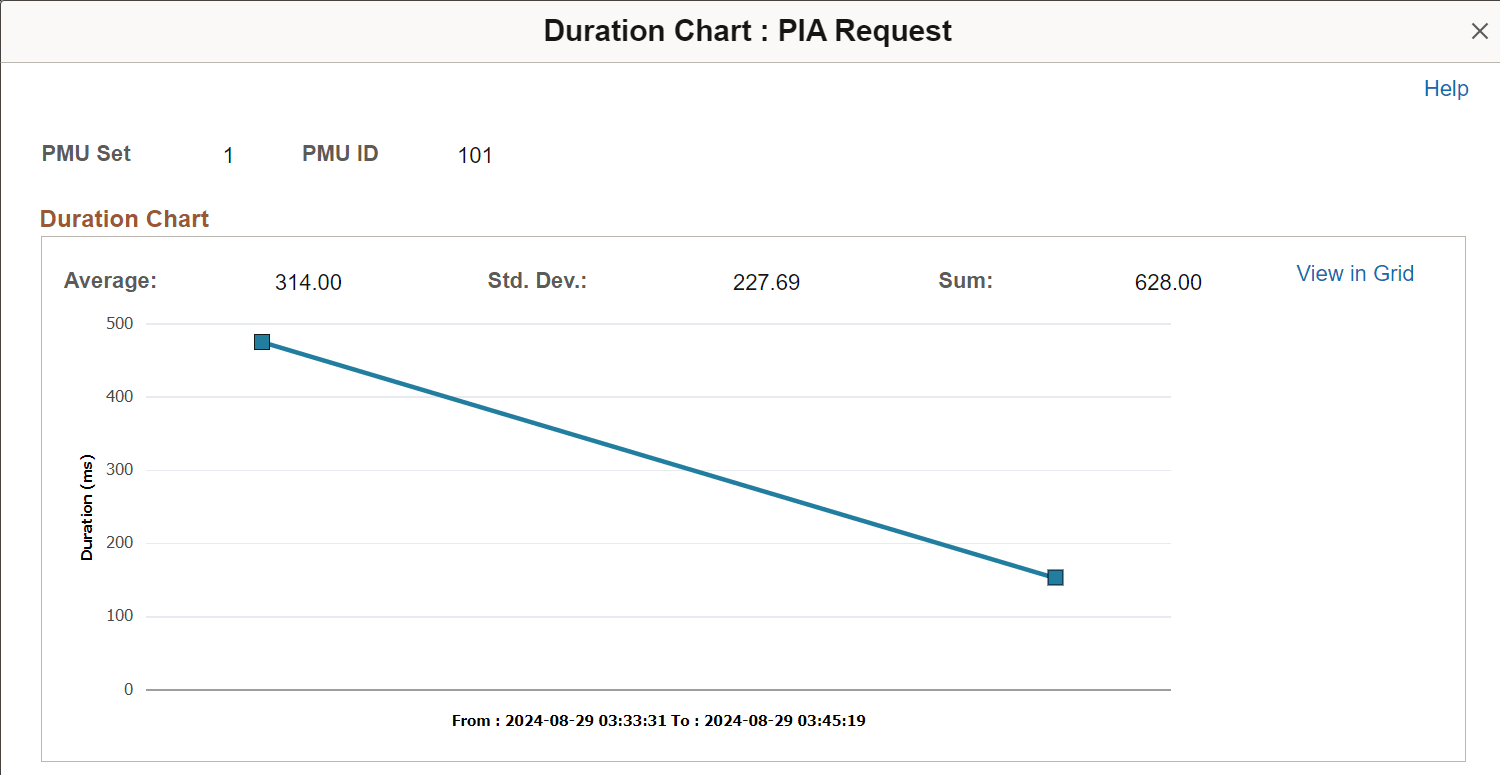

Duration Charts
The duration charts show all durations for all PMUs appearing in the grid. The chart is time-based.
This example illustrates the fields and controls on the Viewing a duration chart. You can find definitions for the fields and controls later on this page.
Note: To view the duration chart, you must specify a PMU and PMU set ID as part of the search criteria. If you click this link when performance data for multiple PMUs appears, the system displays an error message.
