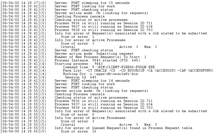

The log fence of a message can be seen in the PeopleSoft Process Scheduler log file.
This example shows the numeric values enclosed in parentheses following the date and time
Example of log file
