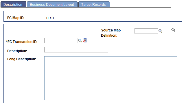

To access the Inbound Maps - Description page, select PeopleTools > EDI Manager > Map EDI Transactions > Inbound EDI Maps
This example illustrates the fields and controls on the Inbound Maps - Description page.
To create an inbound map:
  1. In the EC Transaction ID field, select the transaction to which this map applies.
  2. Enter a description of the map.
    You can enter both a short description (in the Description text box) and a long description (in the larger box). These descriptions are for your information only; the system does not use them.
  3. (Optional.) Copy the definition of a similar map.
    You can copy the details of an existing map definition into this component and change just the parts that are different.
    Select the existing map in the Source Map Definition field, and then click theEc Copy Map DefnSwitch button. The system copies the information from the selected map into this page.

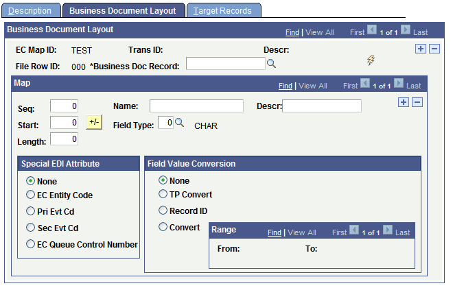

Access the Inbound Maps - Business Document Layout page.
This example illustrates the fields and controls on the Inbound Maps - Business Document Layout page.
You have already created work record definitions that mimic the structure of the PeopleSoft business documents. On this page, you specify which work record definition to use for each record in the PeopleSoft business documents and what type of data appears in each field.
To define the inbound format:
  1. Select a work record definition from the Business Doc Record field, and then click the EC Get File Fields button.
    PeopleSoft EDI Manager copies data from the selected record definition into the Map group box, with one row for each field in the record.
  2. Specify the record ID for this work record definition.
    If the first field in the work record definition is not the one for record IDs, browse the rows in the Map group box to find the record ID field. The EDI agent uses this field to match the work record definition to the appropriate records in PeopleSoft business documents.
    1. In the Map group box for the appropriate record ID, select the Record ID option in the Field Value Conversion group box. The EC File Row ID Value text box appears.
    2. In the text box, enter the record ID of the records whose structure this work record definition mimics. When the EDI agent finds a record in a PeopleSoft business document with this record ID, it uses this work record definition to parse it.
  3. Select the next field in the work record definition.
  4. Check the location of a field in the record.
    If you defined the work record definition properly, the correct field information appears in the text boxes, copied from the work record. You can verify the existing information rather than entering it. If the format of the PeopleSoft business document is slightly different than the work record definition, you can modify the formatting on this page to match the document without affecting the work record definition.
    The Seq (sequence) text box gives the number of the field in the record. The first field in the record is field 1, the second is field 2, and so on. The Name field is the field name from the work record, and the Field Type field indicates the data type of the field’s data.
    The Start and Length boxes specify the location and size of the field in the PeopleSoft business document. The start position is the number of characters from the beginning of the record to where the first character of this field’s data appears. The length is the number of characters reserved for this field; it’s also the number of characters that the system will transfer to the staging tables.
    Note: Length is defined in characters, not in bytes.
    For numeric data, the Dec (decimal positions) field indicates the number of characters to the right of the decimal point. If an incoming PeopleSoft business document uses implicit decimal format, that is, if it does not include decimal points in this field (in any row), the EDI agent inserts them (in all rows) at the position specified in this box. If the data already includes decimal points, the EDI agent does not change them or insert any other decimal points.
    For date information, you also need to enter a date format and delimiter. You use these text boxes to specify the format for dates in this field in the incoming file. Use standard date formatting conventions, as shown in this table:

  5. Select an option in the Special EDI Attribute group box to specify whether the data in the current field is transaction data or an EDI control code.
    Options are:
    Field or Control
    Description
    None
    Normal transaction data.
    EC Entity Code
    An entity code specifies the type of business entity that the trading partner ID for the current transaction refers to. The entity code tells the EDI agent that the table to use to find the list of valid IDs.
    EC Queue Control Number
    A unique identifying number that you want to store in the EDI agent queue and refer to when reviewing EDI audit history. For example, in a purchase order, you might identify the PO number as the EC queue control number.
    Pri Evt Cd (primary event code) and Sec Evt Cd (secondary event code)
    The primary event code, sometimes called the purpose code. The EDI agent uses event codes to determine the appropriate action code. If you identify a primary event code, you must also identify a secondary event code, sometimes called the transaction code, in the same record.
  6. Specify how the EDI agent needs to convert the data as it copies data from the field into the staging tables.
    Field value conversion options are:
    Field or Control
    Description
    None
    The EDI agent copies the data exactly as it appears in the PeopleSoft business document field.
    TP Convert
    The EDI agent converts data from this field according to the rules defined in a conversion type definition. When you select this option, a drop-down list appears to select a conversion type definition.
    Record ID
    Use this option for the first field in the work record definition only. (See step 3.)
    Convert
    The EDI agent converts the data as specified in the From andTo boxes. When the field in the PeopleSoft business document contains the value in theFrom box, the EDI agent converts it into the value in theTo box. Enter a row for each possible value in the field.
    Note: You can perform data conversion at several points during processing. Use the Convert option for conversions that apply to this map only and are valid for all trading partners.
  7. Repeat steps 4 through 6 for each field in the work record definition.
  8. Repeat steps 1 through 7 for each record in the PeopleSoft business document.

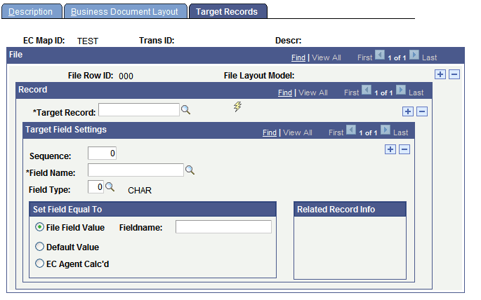

Access the Inbound Maps - Target Records page.
This example illustrates the fields and controls on the Inbound Maps - Target Records page.
To specify staging tables:
  1. Select a work record definition.
    Browse the rows in the File group box to select a work record definition that you added to this mapping on the previous page. The record definition name appears in theFile Layout Model field.
  2. In the Target Record field, select the staging table to copy data into, and then click theEC Get Recfields SW button.
    Field information is copied from the record definition into the page.
  3. Select a field in the staging table record definition.
    Browse the rows in the Target Field Settings group box to select the field.
    The Sequence field gives the position of the field in the record. The field name is from the record definition, and the field type indicates the data type of the field’s data. All of this information comes from the record definition that you selected.
  4. In the Set Field Equal To group box, select the value that you want the EDI agent to copy into the selected field.
    To copy the value from a field in the PeopleSoft business document, select the File Field Value option. Enter the name of the field whose value you want to copy in. Use the field name from the work record definition that appears as the file layout model at the top of the page.
    To enter a default value into the table, select the Default Value option and enter the value in the text box that appears.
    Note: You can specify both a file field to copy data from and a default value. The EDI agent enters the default value into the staging table only when the specified file field does not have a value.
    To enter a value that the EDI agent calculates as it copies data into the staging table, select the EC Agent Calc’d (EC agent calculated) option, and then select a calculation option from the drop-down list box that appears. Options include:

  5. Enter the related record information (for some calculated options only).
    For some of the calculation options that you just selected, you identify the row, record, and field to use in the calculation.
    For example, if you selected the Total/Accumulate Summary Value option, the EDI agent adds up the values from the specified row, record, and field.
    Note: If you selected the Increment Key Sequence Number option, only theRow field appears. You don’t need to select a record or field.
  6. Repeat steps 3 through 5 for each field in the staging table.
    To create a valid mapping, you must enter the appropriate values in the three required system fields:
    • ECTRANSID: Use the EC Transaction ID option to have the EDI agent put the transaction ID in this field.
    • ECQUEUEINSTANCE: Use the EC Queue Instance ID option to have the EDI agent put the instance ID in this field
    • ECTRANSINOUTSW: Enter I to specify an incoming transaction.
  7. Repeat steps 2 through 6 for each staging table that you want to copy data into.
  8. Repeat steps 1 through 7 for each work record definition.
