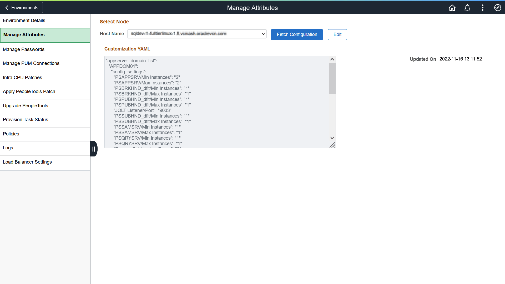

Use the Manage Attributes page (ECL_ENV_ATTR_FL) to centrally administer the configuration of all the managed instances using Cloud Manager.
Navigation:
Click the Manage Attributes link available on the left panel of the Environment Details page. The Manage Attributes page is displayed on the right panel.
This example illustrates the fields and controls on the Manage Attributes page.
The Manage Attributes page can be used to modify the configuration parameters even after an environment is provisioned. You can select the host name and click the Fetch Configuration button to view the psft_customization.yaml file for the selected environment node. The timestamp showing when the fetch happened is displayed at the bottom of the page.

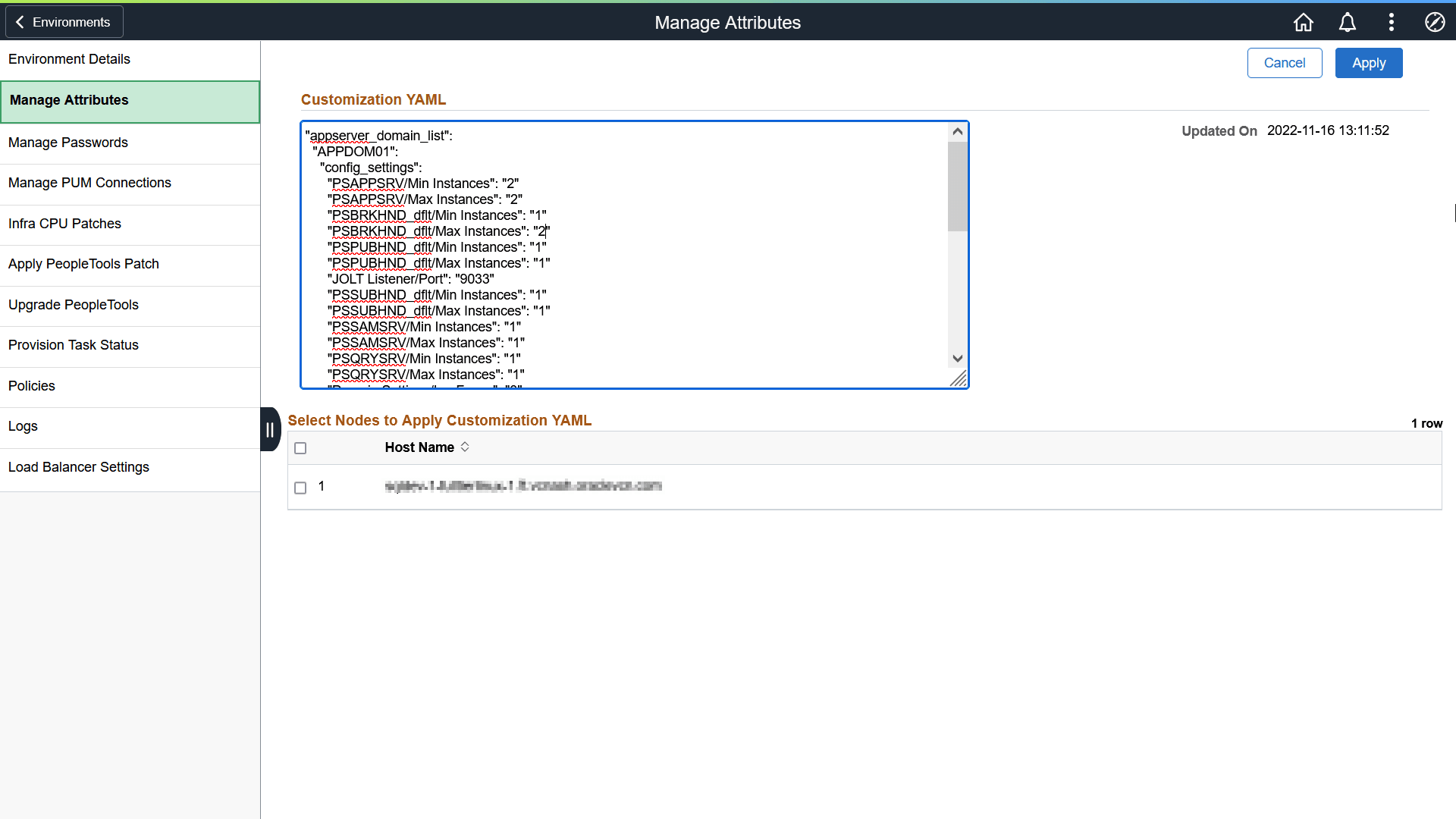

Click the Edit button. The Customization YAML section is enabled.
This example illustrates the fields and controls on the Manage Attributes page that appear on clicking the Edit button.
Modify the attributes in the application server domain, Process Scheduler domain or web server domain.

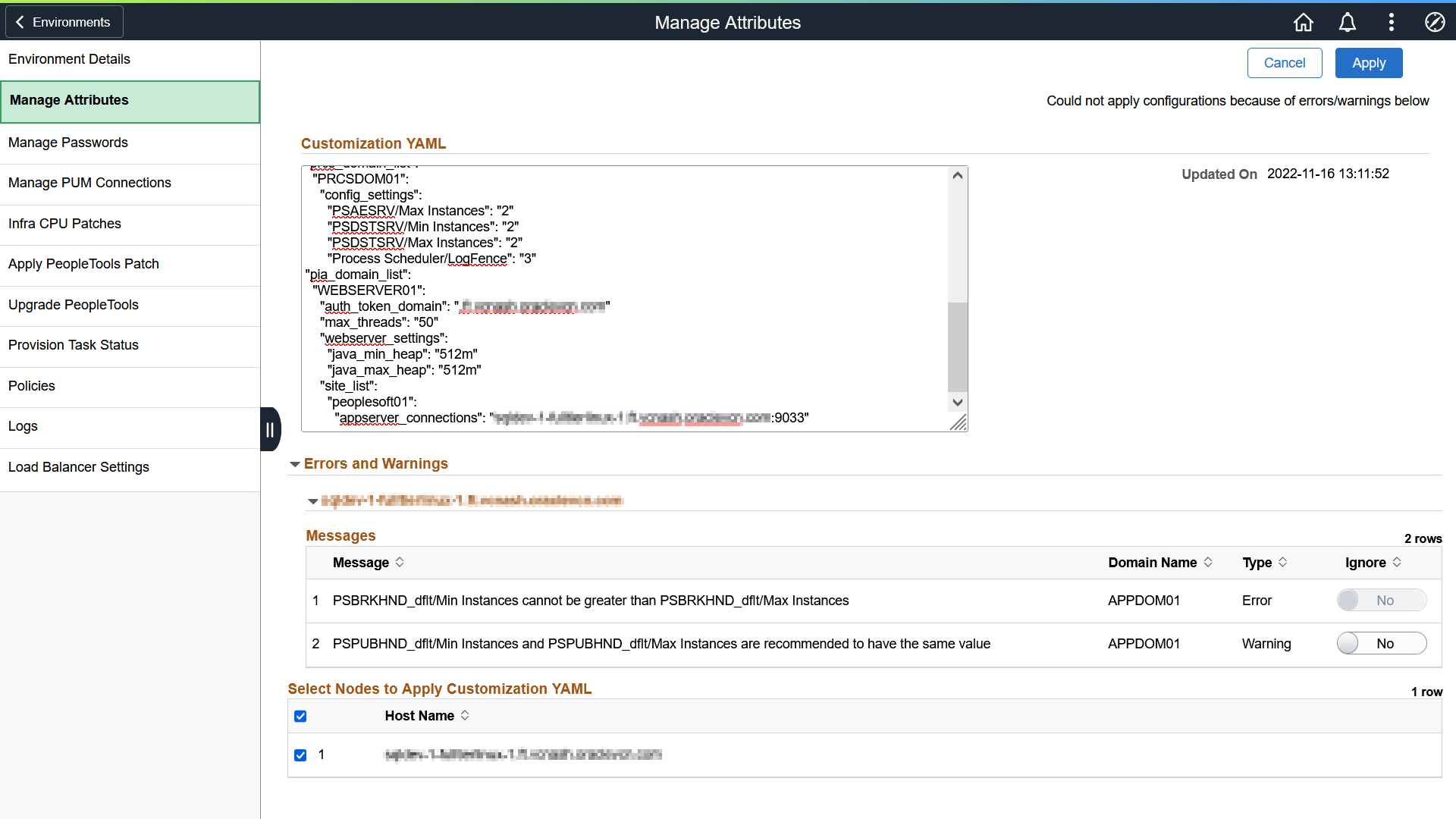

Click Apply. The system displays errors and warnings related to the update, if any. You can choose to ignore warnings, but the errors must be resolved.
This example illustrates the errors and warnings on the Manage Attributes page that appear on clicking the Apply button.

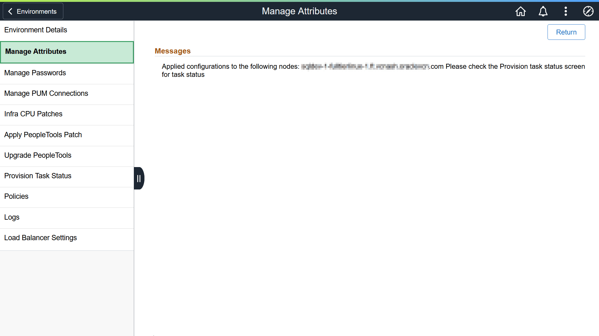

Click Apply after resolving the errors. The system displays a confirmation message.
This example illustrates the confirmation message on the Manage Attributes page that appears after all the errors are successfully resolved and warnings are resolved or ignored.
Check the Provision Task Status page for the status of application of custom configurations, where the status of deployment task activities is displayed along with their start and end times. See Viewing Provision Task Status.
You cannot modify the configuration of an instance until the tasks in progress for applying the configuration are completed.

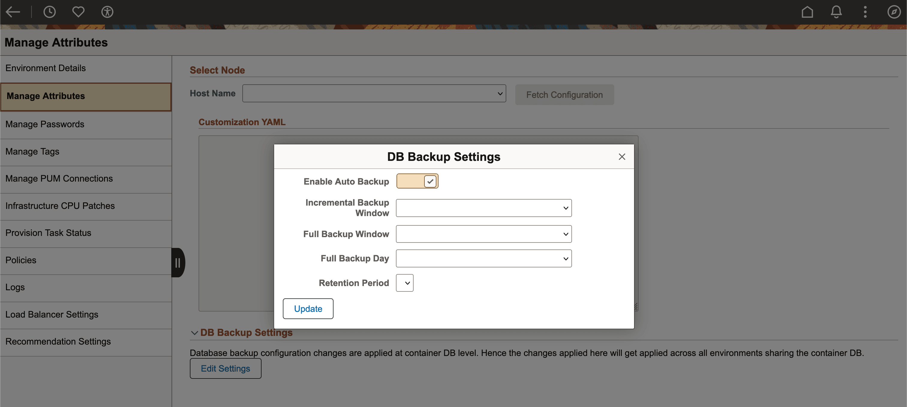

You can use this section to configure DB backup settings for DBS-based environments and imported environments.
Cloud Manager supports backup and restore of DBS-based environments that have single or multiple Pluggable Databases (PDB) in a Container Database (CDB). The prerequisite for this is that auto-backup must be enabled for the CDB containing the environment's PDB.
To update database backup settings:
Expand the DB Backup Settings section and click Edit Settings.
Select the appropriate settings on DB Backup Settings window.
This example illustrates the fields and controls associated with DB Backup Settings on the Manage Attributes page. This section is enabled only for DBS-based environments. You can find definitions for the fields and controls later on this page.
