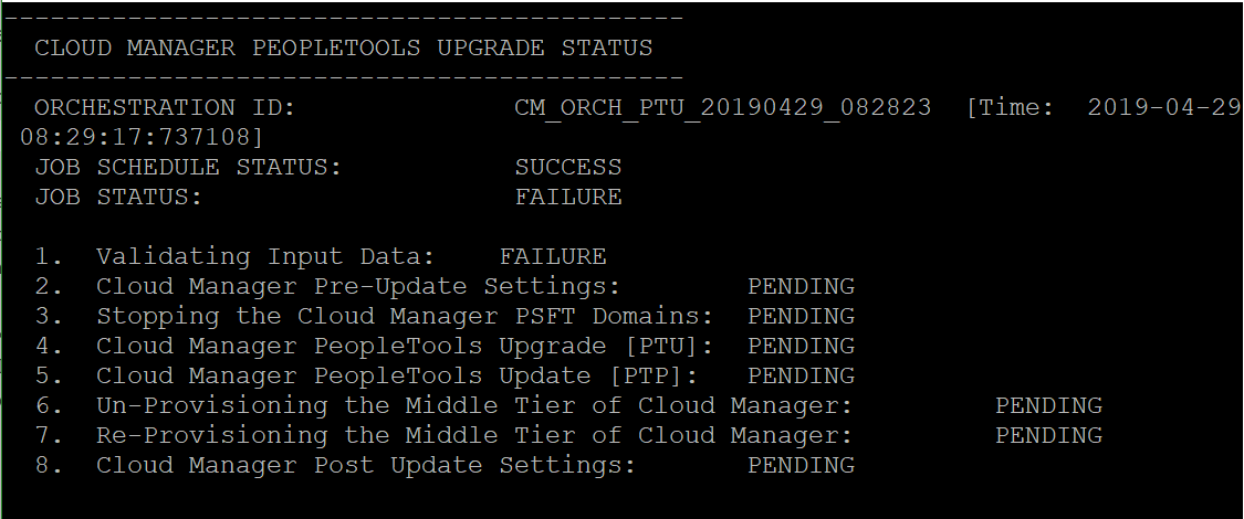

If a step fails, the status will show failure. You will need to correct the failure and either retry or mark the step as complete in order to continue.
This example illustrates Cloud Manager PeopleTools Upgrade Status where a step has failed.
Cloud Manager PeopleTools Upgrade Status with failed step

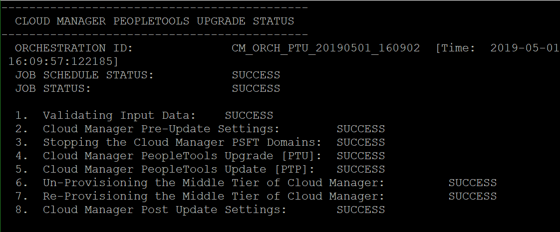

This example illustrates Cloud Manager PeopleTools Upgrade Status where all steps are successful.

This is an example of the verbose Cloud Manager PeopleTools Upgrade Status:
  CLOUD MANAGER PEOPLETOOLS UPGRADE STATUS
  ORCHESTRATION ID:              CM_ORCH_PTU_20190501_160902  [Time:  2019-05-01 16:09:57:122185]
  JOB SCHEDULE STATUS:           SUCCESS
  JOB STATUS:                    SUCCESS
  JOB DETAILS:                   Successfully completed
  JOB LOG:                       /home/psadm2/psft/data/cloud/cmlogs/envs/CLOUD_MANAGER_INSTANCE/CM_ORCH_PTU_20190501_160902/cm_job_psft_cm_ptu_job_0_20190501_160903_out.log
  JOB SCHEDULER LOG:             /home/psadm2/psft/data/cloud/cmlogs/envs/CLOUD_MANAGER_INSTANCE/CM_ORCH_PTU_20190501_160902/out.log
  JOB STATUS CHECK LOG:          /home/psadm2/psft/data/cloud/cmlogs/envs/CLOUD_MANAGER_INSTANCE/CM_DATA/out_20190501.log
  1.  Validating Input Data:    SUCCESS
      TASK DETAILS:              Successfully completed
      TASK LOG:                 /home/psadm2/psft/data/cloud/cmlogs/envs/CLOUD_MANAGER_INSTANCE/CM_PTU_VALIDATE_0_20190501_160906/out.log
      1.1  CM Update Validation Process:        SUCCESS
            Details: Successfully completed
  2.  Cloud Manager Pre-Update Settings:        SUCCESS
      TASK LOG:                 /home/psadm2/psft/data/cloud/cmlogs/envs/CLOUD_MANAGER_INSTANCE/CM_PRE_UPDATE_0_20190501_160912/out.log
      2.1  Cloud Manager Prepare Update Process:        SUCCESS
  3.  Stopping the Cloud Manager PSFT Domains:  SUCCESS
      TASK LOG:                 /home/psadm2/psft/data/cloud/cmlogs/envs/CLOUD_MANAGER_INSTANCE/CM_DOMAIN_STOP_0_20190501_160918/out.log
      3.1  CM Domain Restart/Stop Process:      SUCCESS
  4.  Cloud Manager PeopleTools Upgrade [PTU]:  SUCCESS
      TASK LOG:                 /home/psadm2/psft/data/cloud/cmlogs/envs/CLOUD_MANAGER_INSTANCE/CM_PTU_UPGRADE_0_20190501_160924/out.log
      4.1  Performing PsftActivityWindowsCloudFolderSync:       SUCCESS
      4.2  Performing Cloud Manager Windows Client Install Activity [Source PeopleTools]:       SUCCESS
      4.3  Performing Windows Client Install Activity:  SUCCESS
      4.4  Adding Environment Info to CA:       SUCCESS
      4.5  CA PTU Apply Process:        SUCCESS
  5.  Cloud Manager PeopleTools Update [PTP]:   SUCCESS
      TASK LOG:                 /home/psadm2/psft/data/cloud/cmlogs/envs/CLOUD_MANAGER_INSTANCE/CM_PTP_UPDATE_0_20190501_160930/out.log
      5.1  Performing PsftActivityWindowsCloudFolderSync:       SUCCESS
      5.2  Performing Windows Client Install Activity:  SUCCESS
      5.3  Adding Environment Info to CA:       SUCCESS
      5.4  CA PTP Apply Process:        SUCCESS
  6.  Un-Provisioning the Middle Tier of Cloud Manager:         SUCCESS
      TASK LOG:                 /home/psadm2/psft/data/cloud/cmlogs/envs/CLOUD_MANAGER_INSTANCE/CM_UNPROV_MT_0_20190501_160936/out.log
      6.1  Performing Unprovision MT:   SUCCESS
  7.  Re-Provisioning the Middle Tier of Cloud Manager:         SUCCESS
      TASK LOG:                 /home/psadm2/psft/data/cloud/cmlogs/envs/CLOUD_MANAGER_INSTANCE/CM_REPROV_MT_0_20190501_160942/out.log
      7.1  Performing Reprovision MT:   SUCCESS
      7.2  Cloud Manager Post MT Reprovision Process:   SUCCESS
  8.  Cloud Manager Post Update Settings:       SUCCESS
      TASK LOG:                 /home/psadm2/psft/data/cloud/cmlogs/envs/CLOUD_MANAGER_INSTANCE/CM_POST_UPDATE_0_20190501_160948/out.log
      8.1  Cloud Manager Post Update Process:   SUCCESS
