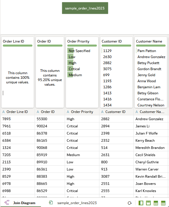

- In Create Dataset, click Drop data file here or click to browse, select the sample_order_lines2023.xlsx file, and then click Open.
- In Create Dataset Table from sample_order_lines2023.xlsx, click OK. Click Save
. - In Save Dataset As, enter
sample_order_lines2023, and then click OK.

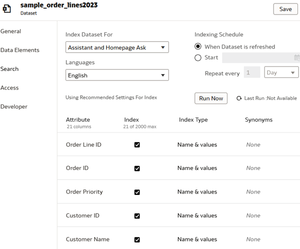

- On the Home page, hover over the sample_order_lines2023 dataset, click Actions
, and then select Inspect. - In the sample_order_lines2023 dataset Inspect page, click Search.
- Click the Index Dataset For list, select Assistant and Homepage.
Description of the illustration index_dataset.png - Click Save and click Run Now.

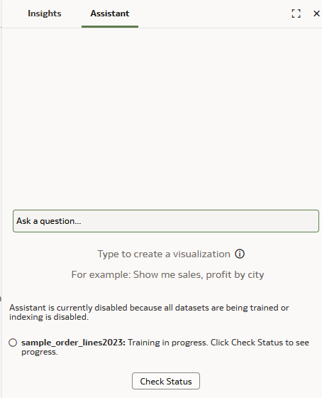

In this section, you verify the dataset indexing and enter a couple of questions in the Assistant. If this is the first time that you have indexed the dataset to use with the Assistant, it's possible that indexing is still in-progress. The Assistant question text box displays when the dataset indexing completes.
- On the Home page, double-click the sample_order_lines2023 dataset to create a workbook.
- Click Assistant next to the Auto Insights panel.
- Click Check Status if this is the first time indexing the dataset.

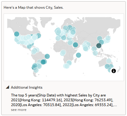

Description of the illustration assistant_indexing.png - In the Ask a question text box, enter
Show me sales by cityand press ENTER. - Click Additional Insights
to see other insights the Assistant found.
Description of the illustration additional_insights.png - Hover over the visualization and click Add to Canvas
to include the visualization in the workbook.

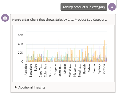

- Click Add
. Ask a question text box, enter by product sub categoryand press ENTER.
Description of the illustration add_question.png - Click Chart Type, select Horizontal Bar, and then press ENTER.

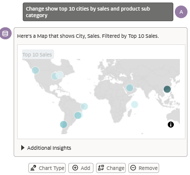

Description of the illustration chart_type_horz_bar.png - Click Change and enter
Show top 10 cities by sales and product sub categoryand press ENTER.

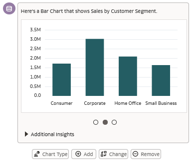

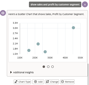

Description of the illustration change_question.png - In the Ask a question text box, enter
Show sales and profit by customer segment.The Assistant answers the question with three visualizations.
Description of the illustration 3_viz_answers.png - Click Go To Page 2
and Go To Page 3
to see the additional visualizations created by the Assistant.
