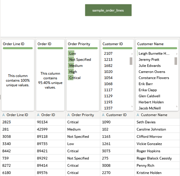

In this section, you create a dataset using the sample_order_lines.xlsx file.
- Sign in to Oracle Analytics.
- On the Home page, click Create, and then click Dataset.
- In Create Dataset, click Drop data file here or click to browse.
- In Create Dataset Table from sample_order_lines.xlsx, click OK.
- Click Save
. In Save Dataset As, enter sample_order_lines, and then click OK.

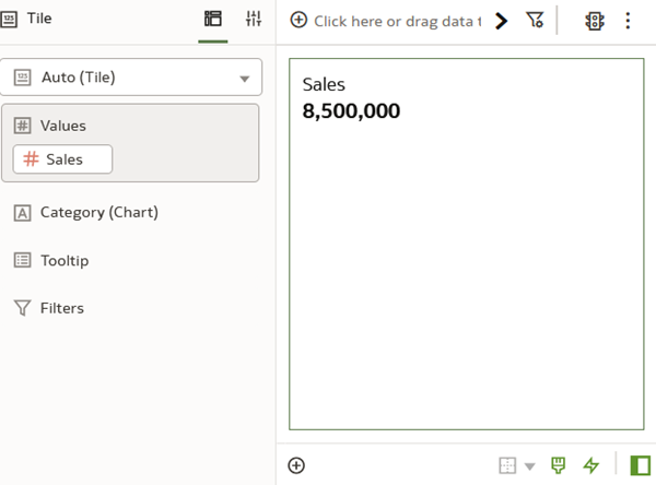

- In the sample_order_lines dataset, click Create Workbook.
- In the Data pane, drag Sales to the canvas.
Oracle Analytics creates a tile visualization that fills the entire canvas.

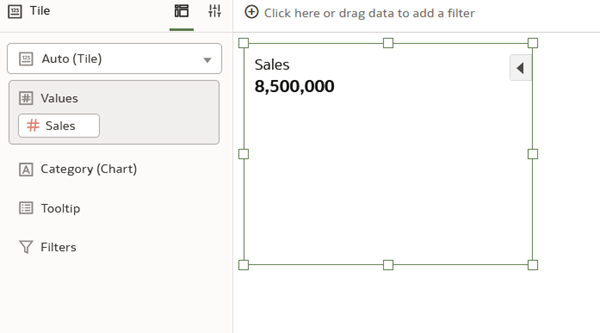

- Hover over the Canvas 1 tab, click Menu
, and then select Canvas Properties. - In Canvas Properties, click the Auto Fit in the Layout row, select Freeform, and then click OK.
- In the canvas, grab a corner anchor
to resize the visualization.The freeform layout enables resizing and moving any visualization on the canvas.

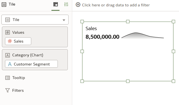

- In the Data pane, select Customer Segment and drag it to Category (Chart) in the Grammar pane.
Oracle Analytics creates a spark chart of Sales by Customer Segment.

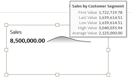

Description of the illustration sales_custseg_sparkchart.png - Hover over the spark chart to display the values in the Line With Area spark chart.

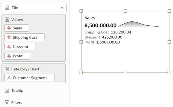

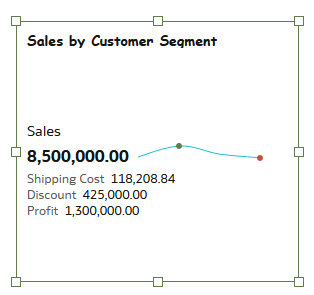

Description of the illustration sparkchart_values.png - In the Data pane, hold down the Ctrl key, select Shipping Cost, Discount, and Profit. Drag and release them under Sales in Values.
Oracle Analytics adds the measures to the tile visualization. The spark chart remains associated with the primary (first) measure in the tile.

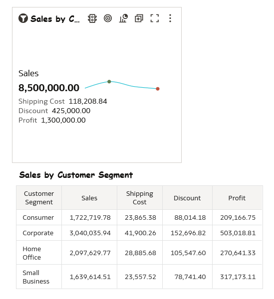

- Click Properties
. - In the Title row, click None, select Custom, and then enter
Sales by Customer Segment. - In Title Font, click Auto, click Comic Sans MS, and then click B (for bold).
- In the Chart row, click Line With Area and select Line.
- In the Color row, click Auto, and then click Custom. In the Custom Color row, click the square
. In Custom Color, click a color such as blue or enter #1bbed0for blue and click OK. - In the Width row, click Auto and select Large.
- In the High/Low Marks row, click Hide to select Show.
- In the Reference Line row, click None and select Average.
Duplicate the Visualization
In this section, you duplicate the tile spark chart visualization and change the visualization type to provide another view of the data.
- In the tile spark chart visualization hover over the toolbar, click Menu
, click Edit, and then click Duplicate Visualization.In the freeform layout, the duplicate visualization is on top of the original visualization.
- Hover over the second visualization and move it to the side of or below the first visualization.
- In the duplicate visualization, click Change Visualization Type
, select Table
