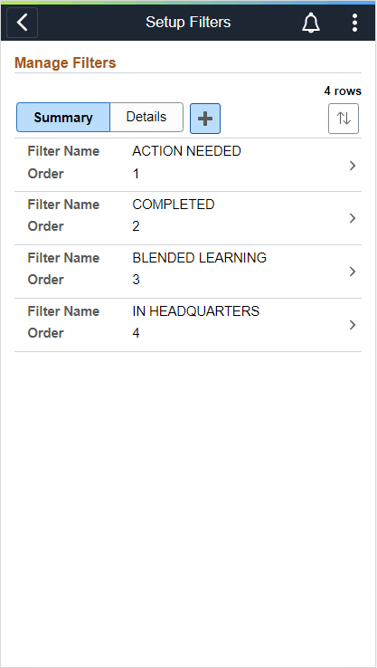

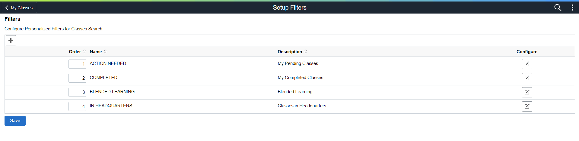

Use the Setup Filters page (LM_INST_FILTER_FL) to manage the filters or add a new filter.
Navigation:
Click Add/Configure Filter in the My Classes page to access the Setup Filters page.
This example illustrates the fields and controls on the Setup Filters page. You can find definitions for the fields and controls later on this page.
Field or Control |
Description |
Summary |
Click the Summary tab to view summary information (that is, the filter name and order) about the filters. |
Details |
Click the Details tab to view detailed information (that is, the filter name, order and type) about the filters. |
Click the + button to access the Add Filter page, to add a new filter. |
Click > to access the Edit Filter page, to edit the order, name or description of the filters. |
Sort button |
Click the Sort button to sort filters based on filter name or order. |

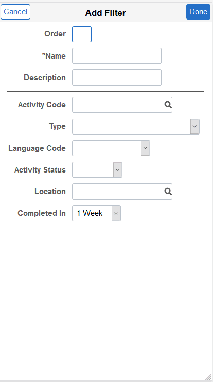

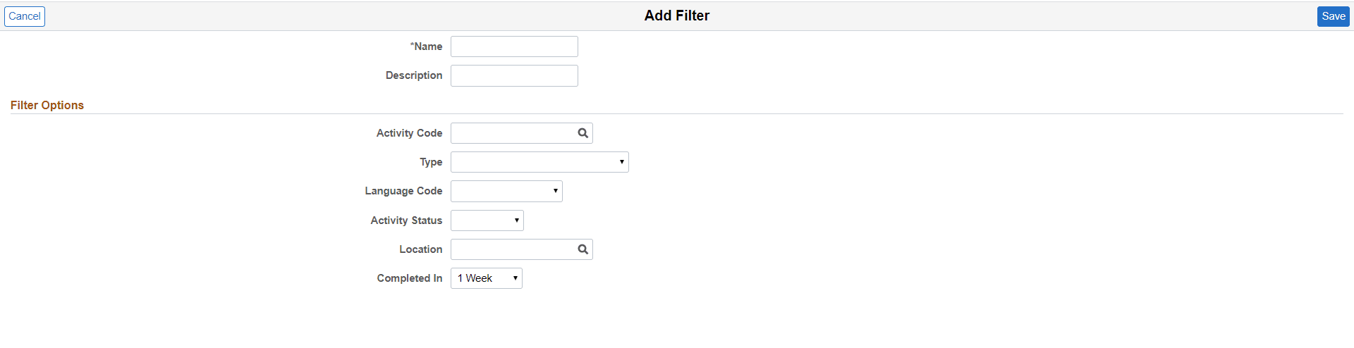

Use the Add Filter page (LM_INST_FILTER_SCF) to add a new filter.
Navigation:
Click the + button in the Setup Filters page to access the Add Filter page.
This example illustrates the fields and controls on the Add Filter Page. You can find definitions for the fields and controls later on this page.
Field or Control |
Description |
Order |
Enter the order in which you want the filter displayed in the My Classes page. |
Name |
Enter a name for the filter. |
Description |
Enter a description for the filter. |
Use the following parameters to set up personalized filters for searching classes.
Field or Control |
Description |
Activity Code |
Select any class code. |
Type |
Select a class type. |
Language Code |
Select a language code. |
Activity Status |
Select an activity/class status. The available values are Active, Closed, Concluded, Inactive and Action Needed. |
Location |
Select a class location. |
Completed In |
Select a class duration. You can select to filter classes from last 1 Week, 1 Month, 3 Months, 6 Months or 12 Months. By default, the option is 1 Week. |

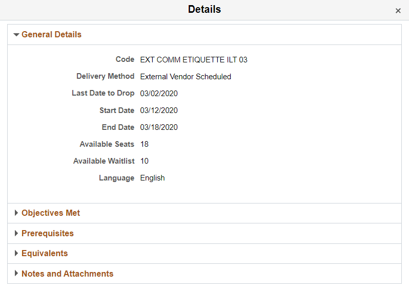

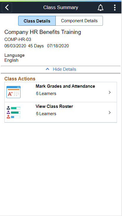

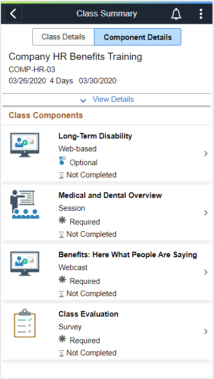

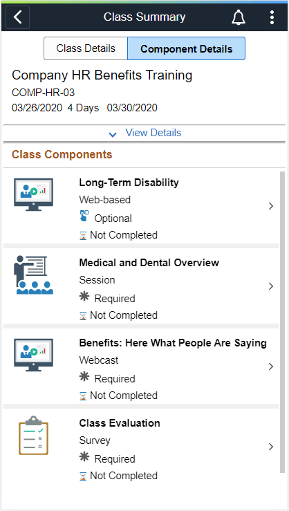

Use the Class Summary page (LM_INST_ACT_DTL_FL) to access the class details and perform class actions.
Navigation:
Click any class row in the My Classes page.
This example illustrates the fields and controls on the Class Summary page — Class Details tab.
Field or Control |
Description |
Title section |
The title section displays the class name, class code, and if present, the begin and end dates, and the duration of the class. |
View Details/Hide Details link |
Click the link to view/hide details of the class. |
Class Actions rows |
Click a row to access the corresponding page for that class action, such as marking grades and attendance or viewing class roster. The Mark Grades and Attendance action row shows the number of learners for whom the instructor has pending actions. This action row will be hidden for completed classes. To edit grade, attendance or score for a completed class, you can use the View Class Roster action. The View Class Roster action row displays the number of enrolled learners for that class. |
This example illustrates the fields and controls on the Class Summary page – Component Details tab.
Field or Control |
Description |
Click the link to view/hide details of the class components. |
Class Components rows |
The Class Components row displays the learning component’s name, type, status and whether it is a required component or not. Click a row to access the Component Details page for that class component. |

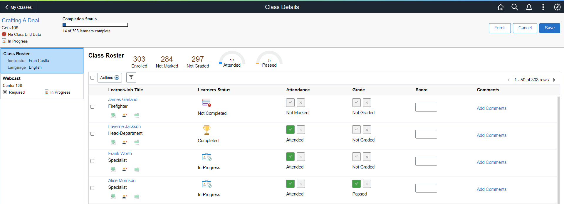

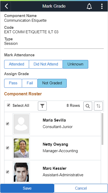

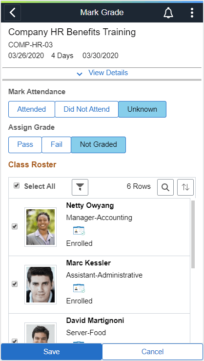

Use the Mark Grade page (LM_INST_ACT_FL) to view the class roster, and mark grades and attendance for selected learners or even the whole class.
Navigation:
From the Class Summary–Class Details page, click the class action row for Mark Grades and Attendance.
This example illustrates the fields and controls on the Class–Mark Grade Page. You can find definitions for the fields and controls later on this page.
Field or Control |
Description |
Title section |
The title section displays the class name, code and duration, and if present the start and end dates of the class. |
View Details/ Hide Details link |
Click the link to view/hide details of the Mark Grade page. |
Mark Attendance |
Select from the available options of: Attended, Did Not Attend or Unknown. The default value is Unknown . |
Assign Grade |
Select from the available options of: Pass, Fail or Not Graded. The default value is Not Graded. |
Select check box |
Select the check box next to a learner or use the Select All check box at the top to mark grades and attendance for learner/learners. |

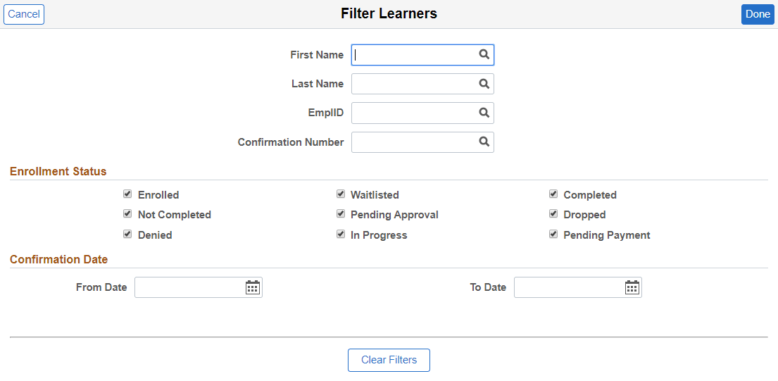

Filter |
Use the filter button to filter learners based on learner details, enrollment status or confirmation dates. |
Search |
Use the Search option to search for a specific learner. |
Sort |
Use the Sort option to sort learners based on parameters such as, name and job title. |

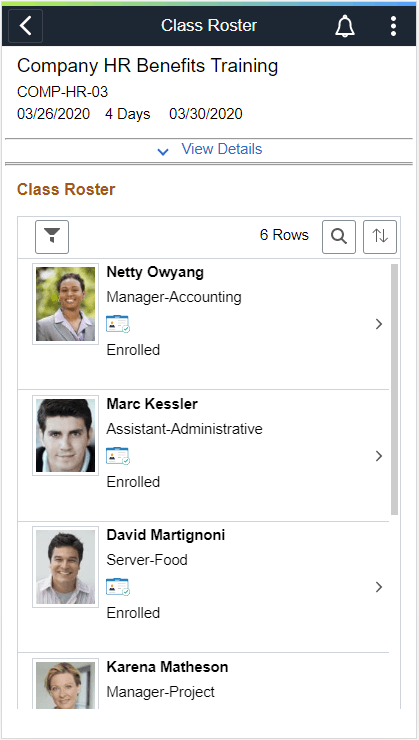

Use the Class Roster page (LM_INST_ACT_CR_FL) to view the list of learners enrolled in a particular class.
Navigation:
From the Class Summary — Class Details page, click the class action row for View Class Roster.
This example illustrates the fields and controls on the Class Roster Page. You can find definitions for the fields and controls later on this page.
Field or Control |
Description |
Title section |
The title section displays the class name, code, duration, and if present, the start and end dates of the class. |
Click the link to view/hide details of the class roster. |
> chevron |
Click either a row or chevron to go to the Mark Grade page for that particular learner. |

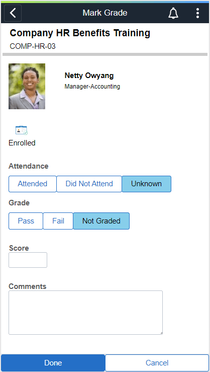

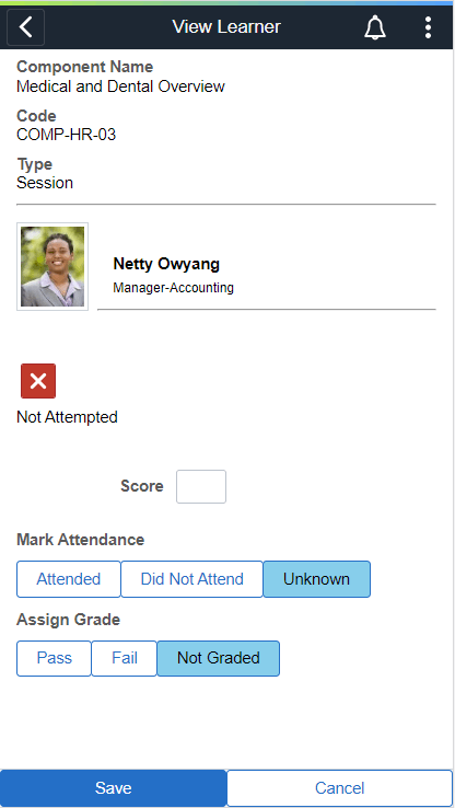

Use the Mark Grade page (LM_LEARNER_DTL_FL) to mark grade and attendance for an individual learner enrolled in the class.
Navigation:
From the Class Summary–Class Details page, click the class action row for View Class Roster and then an individual learner.
This example illustrates the fields and controls on the Mark Grade Page.

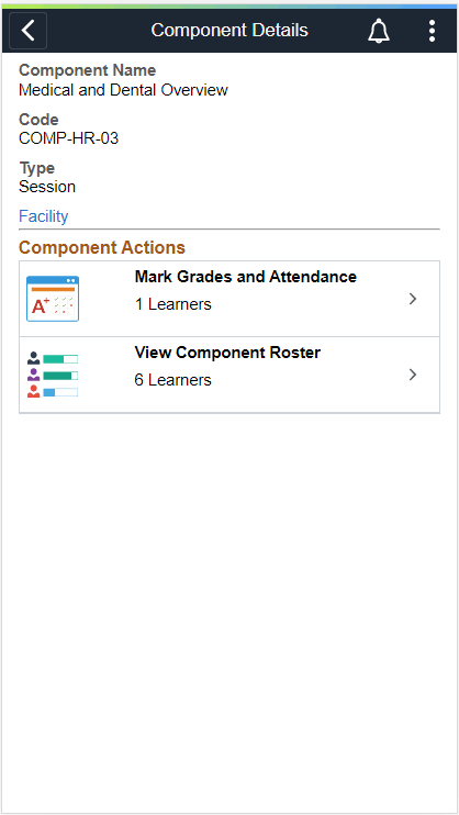

Use the Component Details page (LM_INST_LC_DTL_FL) to view details about a learning component, as well as to complete the component actions, such as marking grades and attendance and viewing the class roster.
Navigation:
From the My Classes page, Class tab, click a row to access the Class Summary page. In the Class Summary, click the Component Details tab to access the Component Details page.
From the My Classes page, Session tab, click a row to access the Component Details page.
This example illustrates the fields and controls on the Component Details Page as seen when opened from the Class tab.
Field or Control |
Description |
Title section |
The title section displays the component name, code and type. |
Component Action rows |
Click a row to access the corresponding page for that Component action, such as marking grades, attendance and scores, or viewing Component roster. The Mark Grades and Attendance action row shows the number of learners for whom the instructor has pending actions. This action row will be hidden for completed components. To edit grade, attendance or score for a completed component, you can use the View Component Roster action. The View Component Roster action row displays the number of enrolled learners for that component. |
This example illustrates the fields and controls on the Component Details Page when opened from the Session tab.
Field or Control |
Description |
Title section |

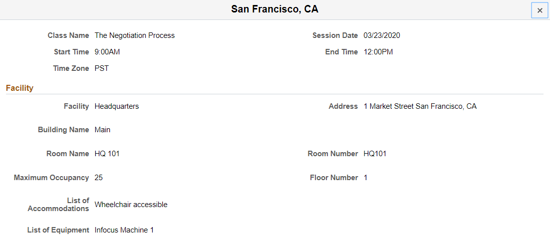

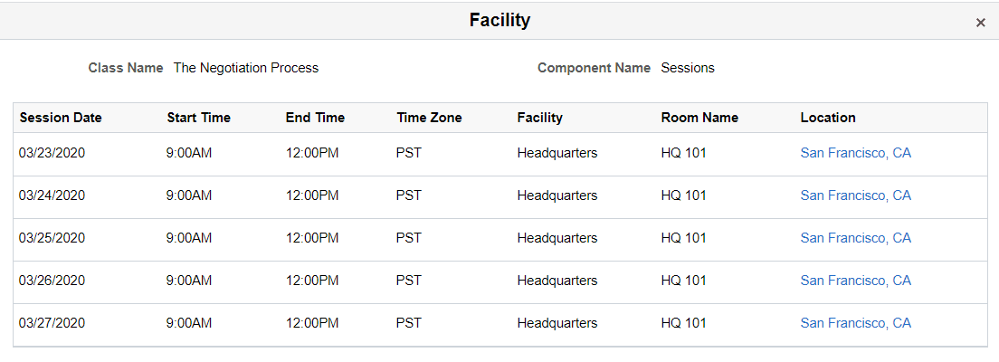

Facility link |
Click the link to access the Facility Page. |

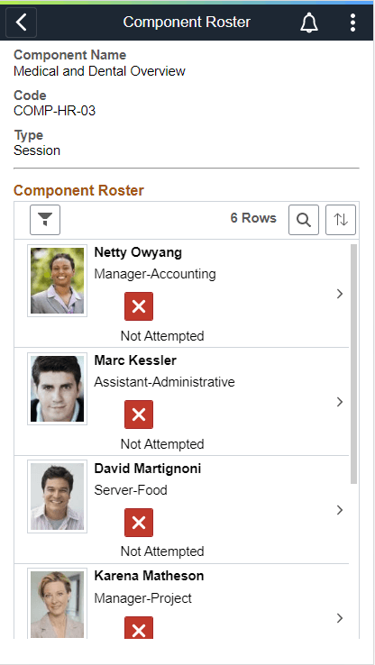

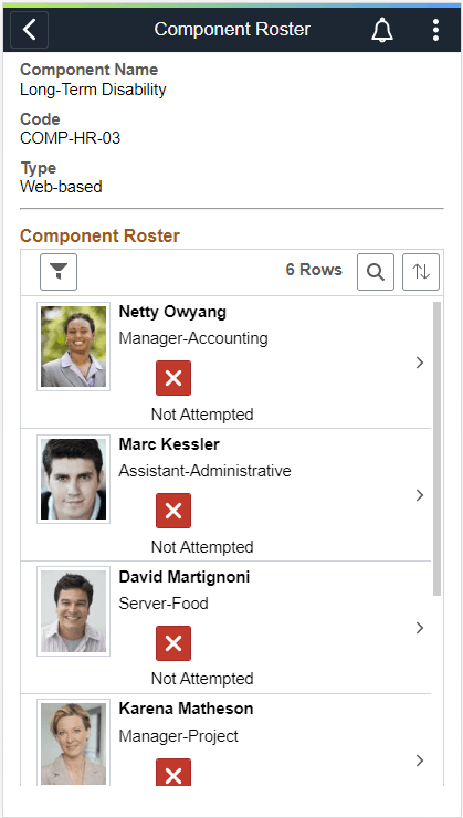

Use the Component Roster page (LM_INST_LC_VWALL) to view details about a learning component, such as the component name, code and type, and the list of learners enrolled for that learning component.
Navigation:
From the My Classes page, Class tab, click a row to access the Class Summary page. In the Class Summary, click the Component Details tab to access the Component Details page. In the Component Details page, click the View Component Roster to access the Component Roster page.
From the My Classes page, Session tab, click a row to access the Component Details page. In the Component Details page, click the View Component Roster to access the Component Roster page.
This example illustrates the fields and controls on the Component Roster Page. You can find definitions for the fields and controls later on this page.
Field or Control |
Description |
Title section |
The title section displays the Component name, code and type of the component. |
Click the link to view/hide details of the component roster. |
> chevron |
This example illustrates the fields and controls on the Session–Component Roster Page.

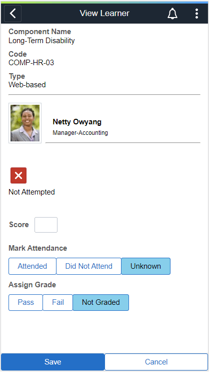

Use the View Learner page (LM_VIEW_LRNR_FL) to view/edit the grades, attendance and score for the enrolled learners for the selected learning component.
Navigation:
From the My Classes page, Class tab, click a row to access the Class Summary page. Then, click the Component Details tab, click a class component row, to access the Component Details page. In the Component Details page, the View Component Roster to access the Component Roster page and then, click a learner row to access the View Learner page for that particular learner.
From the My Classes page, Session tab, click a row to access the Component Details page. Then click the View Component Roster to access the Component Roster page. In the Component Roster page, click a learner row to access the View Learner page for that particular learner.
This example illustrates the fields and controls on the View Learner page from the Class flow. You can find definitions for the fields and controls later on this page.
Field or Control |
Description |
Title section |
The title section displays the Component name, code and type. It also displays a photo of the learner with role details. |
Score |
The instructor can enter the score for the learner in this field. Note: The grades, attendance and score of the learner is shown or hidden based on the learning component type. For example, an assignment will not have the option for marking grades, attendance or score. |
Mark Attendance |
The instructor can mark attendance for the learner. By default, the option is Unknown. |
Assign Grade |
The instructor can assign a grade for the learner. By default, the option is Not Graded. |
This example illustrates the fields and controls on the View Learner Page from the Session flow. You can find definitions for the fields and controls later on this page.
Field or Control |
Description |
Title section |
Score |
Mark Attendance |
The instructor can mark attendance for the learner. By default, the option selected is Unknown. |
Assign Grade |
The instructor can assign a grade for the learner. By default, the option selected is Not Graded. |
Use the Mark Grade page (LM_LC_ROSTER_FL) to mark grade and attendance for an individual learner for the selected learning component.
Note: The grades and attendance marked at the session level are automatically pushed to the class level.
Navigation:
From the My Classes page, Session tab, click a row to access the Component Details page. Then, click the Mark Grades and Attendance row to access the Mark Grade page for learners enrolled in that component.
Field or Control |
Description |
Title section |
Mark Attendance |
Select from the available options of: Attended, Did Not Attend or Unknown. By default, the value is Unknown . |
Assign Grade |
Select from the available options of: Pass, Fail or Not Graded. By default, the value is Not Graded . |
Select check box |
Select the check box next to a learner or use the Select All check box at the top to mark grades, score and attendance for learner/learners. |
Filter |
Search |
Sort |

Use the Setup Filters page (LM_INST_FILTER_FL) to view the names, orders and other details of the filters. You can also use this page to add new filters or reorder the existing filters.
Navigation:
ClickAdd/Configure Filters at the top of the My Classes page.
Field or Control |
Description |
Summary tab |
Displays the filter names and order. |
Details tab |
Displays the filter names, order and other details, such as location, type, language etc. |
Click this button to add a new filter. |
Use the Add Filter page (LM_INST_FILTER_SCF) to edit the filter details, and set up the search options for the filters.
Note: The PeopleSoft delivered filters (Action Needed and Completed) can only be reordered and not modified.
Navigation:
Click any filter row on the Setup Filters page.
This example illustrates the fields and controls on the Add Filter page.
Field or Control |
Description |
Name |
Description |
Field or Control |
Description |
Activity Code |
Type |
Language Code |
Activity Status |
Select an activity/class status. The available values are Active, Closed, Concluded, Inactive and Pending. |
Location |
Completed In |

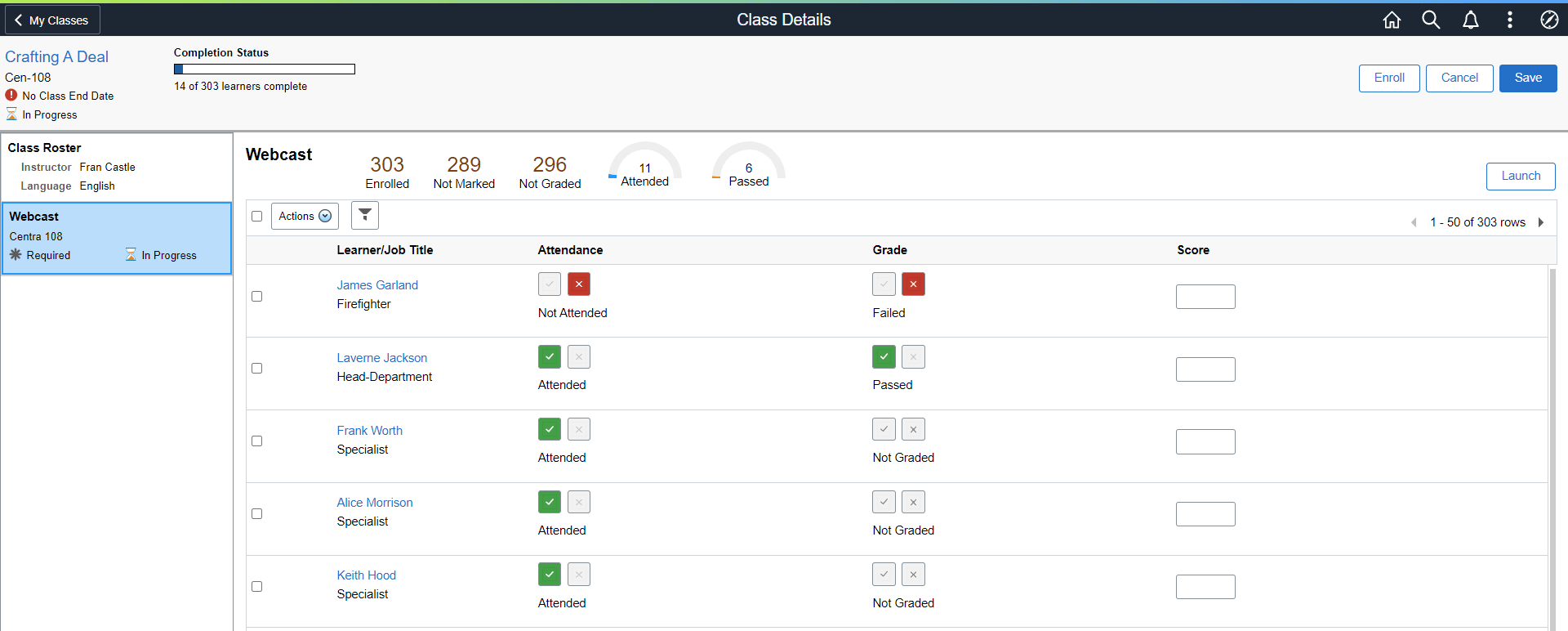

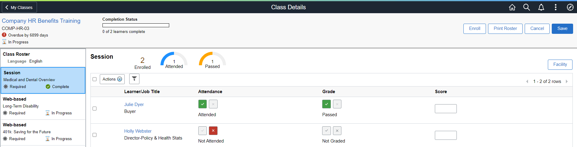

Use the Class Details page (LM_INST_ACT_L_FL) to view class details for the selected class.
This example illustrates the fields and controls on the Class Details page. You can find definitions for the fields and controls later on this page.
Field or Control |
Description |
<Class Name> link, class code and status |
Click the class name link to view the Details pop-up window with General Details, Objectives Met and Equivalents etc. The class code and status are displayed right below the class name link. |
This example illustrates the fields and controls on the Details popup window.
Class Details–Left Panel
Note: On a Tablet device in Portrait mode, by default, the left panel appears collapsed. You can click the Expand button to view the left panel.
Field or Control |
Description |
Class Roster |
When you open the Class Details page, by default, the Class Roster is selected and its details are shown in the right pane. The Class Roster row displays the primary instructor’s name and the language for the class. |
<Learning Component> |
The various Learning Components that are part of the class are listed in the left panel below the Class Roster. You can select one and its details appear in the right pane. The Learning Component rows display the type, name and status along with if it is required or optional. |
Class Details– Class Roster open in the Right Pane
Field or Control |
Description |
Enroll |
Click the Enroll button to search for and add new learners to the class. |
Print Roster |
Click the Print Roster button to print the class roster in a PDF format. The Print Roster button is displayed only when a class has at least one learning component of the type, session. |
Cancel |
Click Cancel to return to the My Classes page. |
Save |
Click Save to save all the changes made to the Class Detail page. |
Learner Status bar |
This bar indicates the status of the learners for the selected class, i.e. how many learners have been marked grades and attendance. |
Class Roster Stats |
These are numbers and gauges displayed at the top of the Class Roster. The stats include:
Actions menu |
From the Actions menu, you can access a number of tasks, such as marking class completion, grades and attendance. Other Actions include dropping learners or moving them to a new class, sending notifications, and printing completion certificates. |
Filter Learners button |
Click the filter icon to find learners based on parameters like the learner details, enrollment status and confirmation date. |
Displays the range of rows in the Class Details page along with the total number of rows. Click the left or right arrows to navigate to the previous or next set of rows. The number of rows displayed per page in the Class Details page can be configured using the Internal Learners - Learner Attributes Page. Note: The total number of rows in the Class Details page may vary from the count displayed in the Class Roster Stats visualization. For example, the total row count includes learners in both Enrolled and Waitlisted statuses. Whereas, the Class Roster Stats display only the count of Enrolled learners. |
This example illustrates the fields and controls on the Filter Learners page.
Field or Control |
Description |
Find button |
Click the lookup button to open a Find pop-up window to search for learners. |
Sort button |
Use the Sort button to sort the learners displayed. The available values are learner, job title, status or score. |
Select check boxes |
Use the Select check boxes, to select learners, and perform actions from the Actions menu. |
Learner/Job Title |
This column displays the name and job title of the learner. Click the learner's name link to open the learner details modal window. Here, you can view the learner details such as Learner ID, Employee ID, Department, Manager and contact information. |
Status |
This column displays the current status of the learner. Values include: In-Progress, Completed, Not Completed, Enrolled, Dropped, etc. |
Attendance |
The instructor can use the buttons to mark attendance of the learner from this page. Values include: Attended (green check), Not Attended (red cross) or Unknown (check and cross buttons are unchecked). |
Grade |
The instructor can use the buttons to mark grade of the learner from this page. Values include: Passed (green check), Failed (red cross) or Not Graded (check and cross buttons are unchecked). |
Score |
Use the Score field to enter the scores for each learner. |
Add Comments |
Click the Add Comments link to add any comments. Once comments are added, the Add Comments link is replaced with an Edit Comments icon, which you can click and edit your comments. |
Send Notification |
Click the email icon next to learners to send notifications about the class. |
Drop Learner |
Click the Drop button to access the Drop Class page to drop a learner from the class. |
Move Learner |
Click this button to access the Enroll Learners page to search for a different class for the learner. |
Edit Payment Details |
Click this button to access the Payment Details page to view and edit payment details, such as fees and charge back information. |

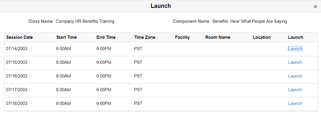

This example illustrates the fields and controls on the Launch page.

Use the Facility page (LM_SESS_LOC_SCF) for more information on the facility utilized for the selected instructor-led session. This information includes Class and Component names, date, session start and end times, time zone, room number and location.
This example illustrates the fields and controls on the Facility Page.
The location link takes you to a <Location Name> page, which provides further details on that facility and location.
This example illustrates the fields and controls on the <Location Name> page.
