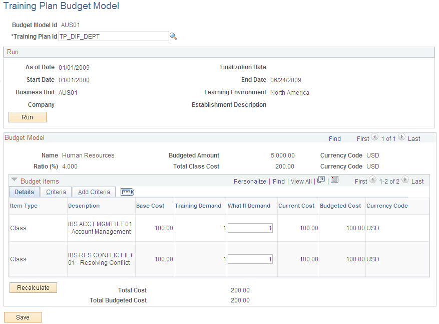

Use the Training Plan Budget Model page (LM_BUDGET_MODEL) to analyze training plan budgets.
Navigation:
This example illustrates the fields and controls on the Training Plan Budget Model page.

Budget Model
The fields in this group box provide an overview of how a department's training budget compares to its actual class cost.
Field or Control |
Description |
Name |
Displays the name of the department. |
Budgeted Amount |
Displays the budget defined for the department in the training plan. |
Currency Code |
Displays the currency used for the budget. |
Ratio |
Displays the ratio between the Total Class Costs and the Budgeted Amount. |
Total Class Costs |
Displays the system-calculated class costs for the department based on current enrollment records and learning requests. |
Budget Items: Details Tab
The Details tab of the Budget Items group box lists each item included in the Total Class Costs for the department.
Field or Control |
Description |
Item Type |
Displays the type enrollment record or learning request. |
Long Description |
Displays the description of the enrollment record or learning request. |
Base Cost |
Displays the base cost of the enrollment record or learning request. |
Training Demand |
Displays the system-calculated demand for the enrollment record or learning request. |
What If Demand |
Enter hypothetical demand for the enrollment record or learning request. |
Current Cost |
Displays the current cost of the enrollment record or learning request. The system calculates this cost by multiplying the Base Cost times the Training Demand. |
Budgeted Cost |
Displays the hypothetical budgeted cost of the enrollment record or learning request. The system calculates this cost by multiplying the Base Cost times the What If Demand. |
Currency Code |
Displays the currency associated with the cost of the enrollment record or learning request. |
Recalculate |
If you modify any values in the What If Demand column, click this button to recalculate the budget model based on your changes. |
Total Cost |
Displays the total of the Current Cost values for all the items contributing to the department's budget model. |
Budgeted Total Cost |
Displays the total of the Budgeted Cost values for all the items contributing to the department's budget model. |
