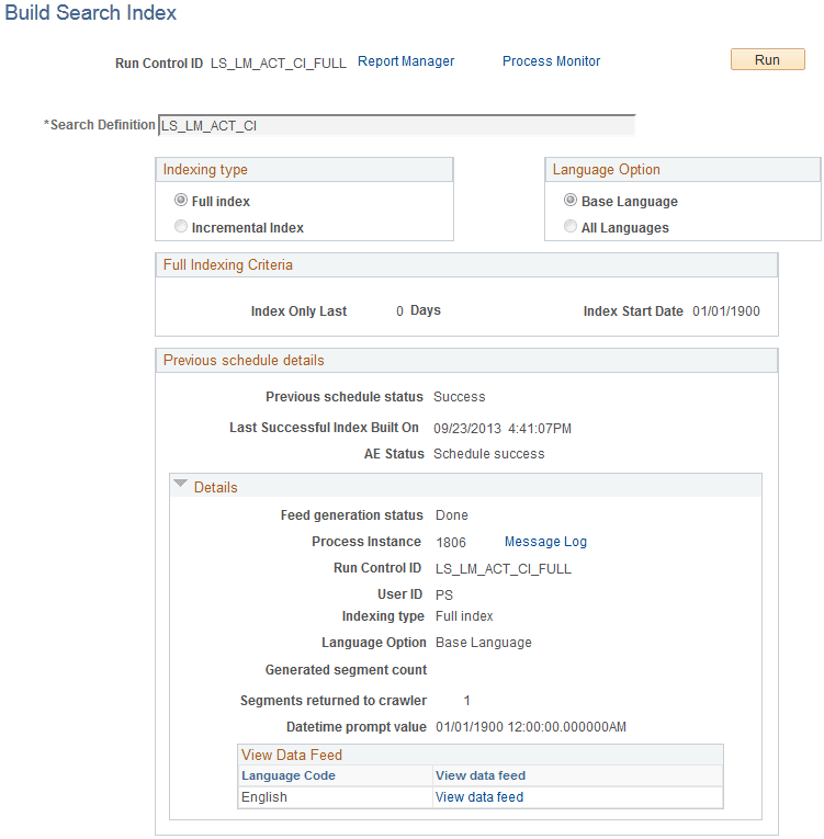

Use the Build Search Index page (PTSF_SCHEDULE_SI) to create and update the course and class, program, and objectives indexes for use in searches.
Navigation:
This example illustrates the fields and controls on the Build Search Index page.
Field or Control |
Description |
Search Definition |
Select the search definition to determine the type of index you want to create or update. Values are:
Full Index |
Select to create a new full index. If an index already exists, the process overwrites it. |
Incremental Index |
Select to update an existing index. The system updates an index with any changes made since the last time the index was successfully created or updated. |
Base Language |
Select to build or update the index for only the base language. |
All Languages |
Select to build or update the index for all enabled languages. |
