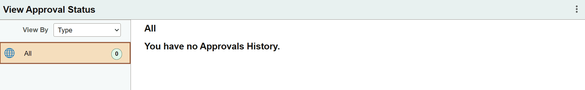

This example illustrates the fields and controls on the View Approval Status page.
