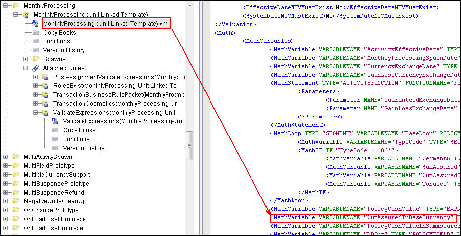

  • MonthlyProcessing transaction: This transaction contains a math variable called SumAssuredInBaseCurrency that converts the SegmentAmount field from USD to base currency (THB) using rates as of the specified effective date (Last Known exchange rate for the MarketMaker). Navigate to Global Explorer | Transactions | Monthly Processing (Unit Linked Template).
Monthly Processing transaction in Global Explorer
MonthlyProcessing Transaction in Global Explorer
