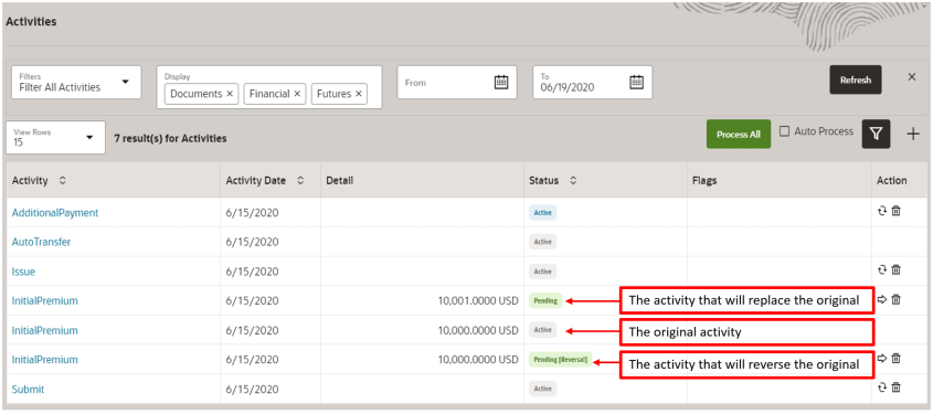

Clicking the Recycle icon associated with an activity creates two additional activities to be processed. The first is a reversal activity that has Pending [Reversal] status. The second activity is the new activity that has Pending status and it replaces the original activity when the reversal activity is processed.
Step 1: Click the Recycle icon for an activity.
Two pending activities are generated in OICE: reversal activity and new activity.
Two Pending Activities Generated For Recycle

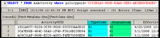

  • Two additional records are written to the database to track the reversal and new activity.
Database record with two new records for reversal and new activity
Reversal Records Written to Database

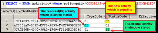

Step 2: Click the the Processicon for the reversal activity.
The status of the original activity is updated to shadow and the reversal activity status is updated to active.
Active Reversal Activity

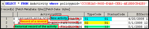

  • The status of the original activity’s record changes from 01(active) to 12(shadowed). The reversal activity changes from 02(pending) to 01(active).
Database record showing new actiivity as pending, reversal activity as active and old activity as shadowed.
Reversal Activity in the Database

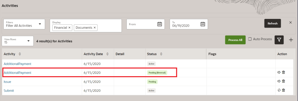

Clicking the Reverse icon associated with a processed activity generates a reversal activity. The reversal activity is in Pending [Reversal] status and must be processed in order to delete the activity and place it in a shadowed status.
Step 1: Click the Reverse icon associated with an activity. A reversal activity is generated with a Pending [Reversal] status.
Reversal Activity in Pending Status

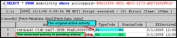

  • There are now two records, one for the original activity and one for the reversal activity.
Database records for original activity and reversal activity
Two Reversal Activities in Database
Step 2: Click the Processicon for the reversal activity. The original activity is then updated to shadowed status and the reversal activity is updated to active status. The database record for the original activity is updated to 12(shadowed) and the reversal activity is updated to 01(active)status.

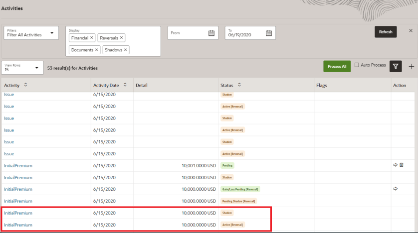

Important: The delete display filter does not control the viewing of deleted activities. An activity that is deleted will have a shadowed status. Select the filter for shadowed activities to see those activities that were deleted. This filter displays the ability to delete activities via the trash can icon. The delete option should not be available in a production environment.
