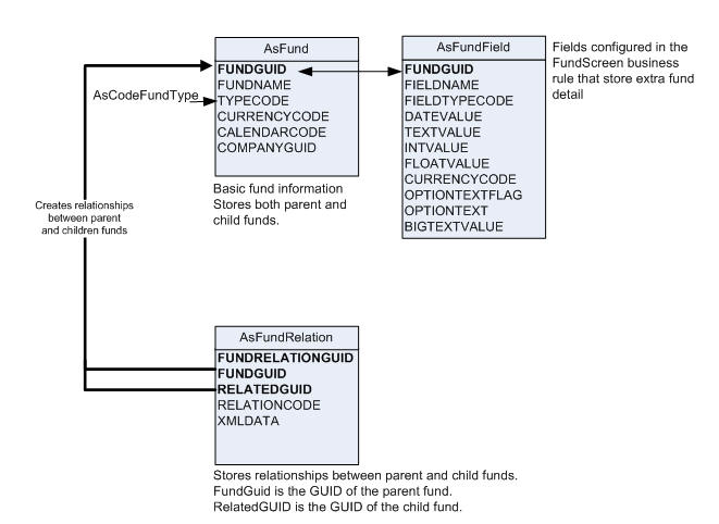

OIPA Fund Database Tables
OICE Fund Database Tables
