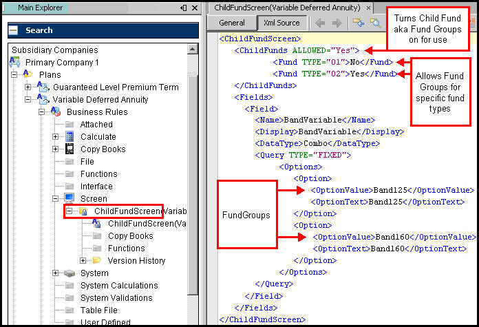

Step 1: Configure the ChildFundScreen Rule
The ChildFundScreen rule must be configured in order to turn on the ability to generate fund groups, identify what type of funds may have child funds and identify the value is to be associated with each child fund for identification.
  1. Make sure this business rule is overridden at the Plan level.
  2. Configure the <ChildFunds> and <Fund> elements. Please see the XML Configuration Guide topic in this help system for a list of all elements, attributes and values needed for configuration. View Business Rules | Screen Rules | ChildFundScreen.
  3. Configure a <Field> element for each child fund. A child fund will be generated using the parent fund information appended with value information for identification.
  4. Check-In the rule.
ChildFundScreen Business Rule
ChildFundScreen Business Rule in Main Explorer

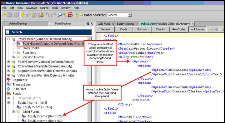

Step 3: Configure Policy
On the Policy screen you must configure a field that stores the child group fund information available for the plan. You must configure the exact name of the field and option values that are used in the ChildFundScreen configuration. This allows the system to identify the parent/child fund group relationships needed for transaction and allocation processing. See step 1 for the ChildFundScreen configuration.
Policy screen XML
Child Fund Details Displayed in Configuration Area

Step 5: Generate Child Funds
After the Parent fund has been established, child funds may be generated.
  1. Check-out the parent fund.
  2. In the Fund Detail pane, right-click on Fund Groups.
  3. Select Generate Child Funds.
  4. Check-in the parent fund.
Fund Group Right-Click Option
