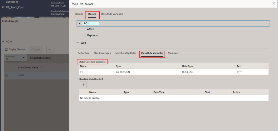

The system views the Class Rule Variables in order to facilitate that funneling through to get to the last possible terminal leaf node or orphan Class to where the Member will be matched.
class rule variables
Activity Results > Class Rule Variables

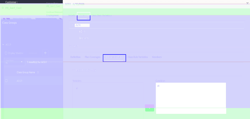

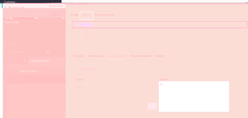

The Class Rules facilitate the filtering to the next Class or Orphan Class using syntax that is formed using the predefined Class Rule Variables to form tests and conditions. The tests and conditions evaluate whether or not to move on to the next Class or to stop because a suitable Class was found to which the Client will become a Member.
class rules
Activity Results > Class Rules

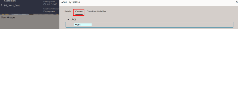

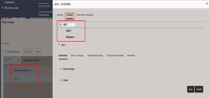

The Class tree structure can be accessed under ClassGroups and the user can select the applicable Class to view Members.
class tree
Class Tree Structure
The Class Rules contain a condition or test that if True, places the Client into Membership with the specific Class. If the condition is false, the system goes to look at the next Parent Class and Child, and if still the condition ends in a False response, the Client will go into Membership within the Orphan Class.

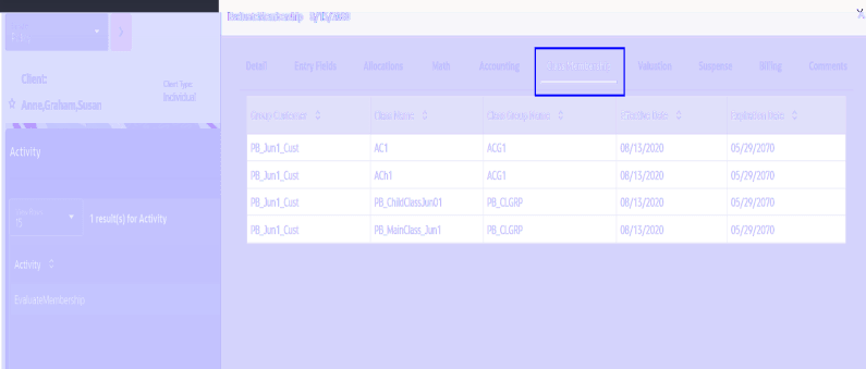

A Class Membershiptab will be housed on the Activity Results screen of the Activities determining Class Membership. The Class Membership tab will contain a table listing all available Class Names and Class Group Names.
A Class Membership tab will be housed on the Activity Results screen of any Activities that include determination of Class Membership. The Class Membership tab will contain a table listing all available Class Names and Class Group Names.
If the Class Membership syntax was not used within the Transaction, a message will display indicating “No Membership Processing Performed”.
Membership records will be committed to the database (optional) unless the process is to provide a quote. We allow the override of writing the records to the database. The default action is to write the records, but the quote capabilities in the application provides an instance / circumstances where the need is not necessary to write a record to the database. Membership records will exist for the "leaf" records only - the leaf Class Membership only.
