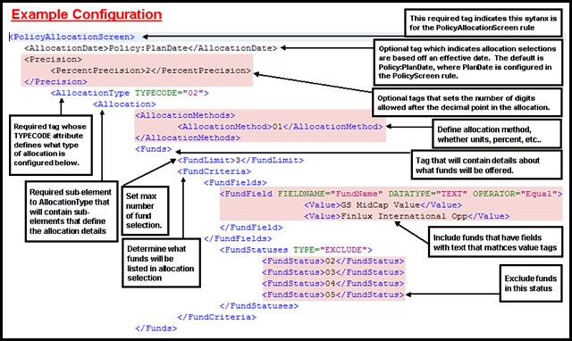

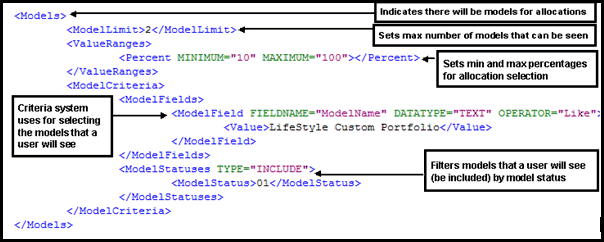

An explanation of the types of models supported in OICE is provided in the Allocation Model section of this help. An XMLexample of the OICE PolicyAllocationScreen business rule configuration is also provided.

  6. Add the Allocation Model in the appropriate business rule (PolicyAllocationScreen or TransactionAllocationScreen) according to where the model will be used in OICE. These business rules store the allocation instructions for the varying allocations that may be presented at the different levels in OICE.

    • Plan Allocations:Please see the AllocationScreen business rule and the Plan Data page.
Allocation Example
Basic Allocation Configuration and Fund Selection
Model XML Example
Configuration Showing Allocations in Models
