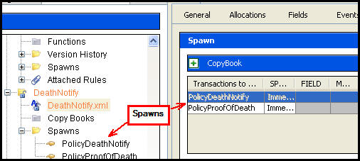

Spawn icons in AS Main Explorer and Spawn pane open in Configuration Area
Transaction with Spawn

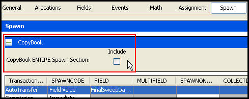

  1. The first section on the Spawn pane is the Copybook section. Click the green plus sign to expand this section. This is used when an entire Spawn section from a different transaction needs to be copied and used in your configuring transaction. If the Include checkbox is checked then a Lookup field will appear so that the transaction with the Spawn section you want to copy can be selected. All other fields on the Spawn pane will be disabled if a copybook is used. Refer to the steps below for instructions on adding a spawn copybook.

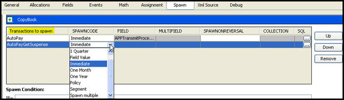

  1. Directly below the Copybook section is the first gray table, which holds a list of spawns the transaction will trigger. The Transaction to spawn column displays a list of transactions that will be spawned. Highlight a transaction in the list and double-click in a cell to edit the information. Refer to the steps below for instructions on adding transactions to this table.
The SPAWNCODE indicates when the transaction should be spawned. A list of SpawnCodes from AsCodeSpawn in the AsCode table is listed below. The SpawnCode selected will determine if additional columns in the table are available. For example, if the spawn's occurrence is based on a date field then select the field value for SPAWNCODE and the FIELD combo box will be enabled so that the correct variable can be chosen from the combo box. Double-click in a column to see if the option can be used with the type of SpawnCode selected.
Spawn tab on the Spawn Screen
Transactions to Spawn listed on Spawn Pane
Note: Only spawn codes 01, 03, and 09 would be functional even though the Rules Palette shows multiple code descriptions. Refer to the below table for descriptions of 01, 03, and 09 spawn codes.

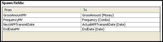

  1. Spawn fields allows the user to indicate the variables from the processed activity that should be passed to the spawned transaction. Select an option from a combo box in the FROM field, which is filled with all the fields and math variables available in the spawning transaction. If no selection is made in the FROM field, the field will not be spawned. In a majority of cases all FROM fields will be filled in. FROM fields allow date entry and are sorted by the datatype of the TO fields.
Spawn fields
Spawn Fields Section on Spawn Pane

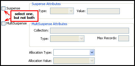

  1. The bottom section is used to define suspense, if needed. Checking the box next to suspense or multisuspense will activate the attribute fields allowing additional parameters to be entered.
    1. Suspense Attributes: Select a type from the drop down box and enter a value. The value must be at least the value of the Activity field; it cannot be less.
    2. Multisuspense Attributes: Enter the name of a Collection type math variable in the Collection field. Then select a type and enter a maximum number of suspense records to include in the collection.
Suspense section of the Spawn Pane
Suspense Attribute Section on Spawn Pane

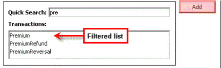

  1. The Quick Search section on the far right side of the pane is used to add a new spawn to the transaction. To add a spawn, type the transaction name in the Quick Search box. A filtered list reveals all available transactions in the Transaction box. Highlight the desired transaction and select the Add button. The transaction will be added to the spawn list. Use the Up, Down and Remove buttons to set the order of spawns or remove spawns from the list.
Quick Search
Quick Search Section on Spawn Pane

Insert Entire Spawn Section from CopyBook
  1. Navigate to the transaction and click the Spawn pane.
  2. Expand the CopyBook section at the top of the pane.
  3. Click the Include box.
  4. Click lookUp and select the CopyBook from the CopyBook Lookup window. The population of CopyBooks listed in this window will be all copybook rules starting with the name 'CopyBook-' and a business rule type of CopyBook.
  5. Click OK. The CopyBook spawn information will be added to this pane.
Copybook section expanded on Spawn pane
CopyBook Section on the Spawn Pane

  2. Search for the transaction to spawn from the Quick Search box.
  3. Select the transaction name from the Transactions list.
  4. Select Add, which adds the transaction to be spawned.

  6. Select the SpawnCode from the drop-down box. The SpawnCode determines how or when the transaction should be spawned. Additional fields in the table will become available based on the SpawnCode selected. Double-click in a column to see if the option is available with the type of SpawnCode selected.

  8. Select the spawn fields needed to complete the spawn. The To section automatically populates with the applicable math variables or fields for the activity the values are going to. The From section has drop-down boxes to select a field or math variable that stores the values needed to pass to the activity being spawned. The From value will be passed to the specified To field of the spawned transaction.

After a spawned activity is created, it will be listed in the rule’s spawn folder.
